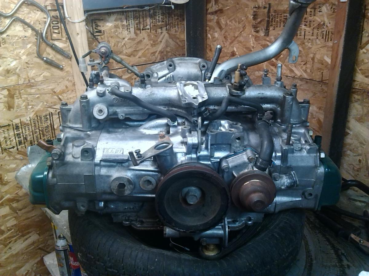

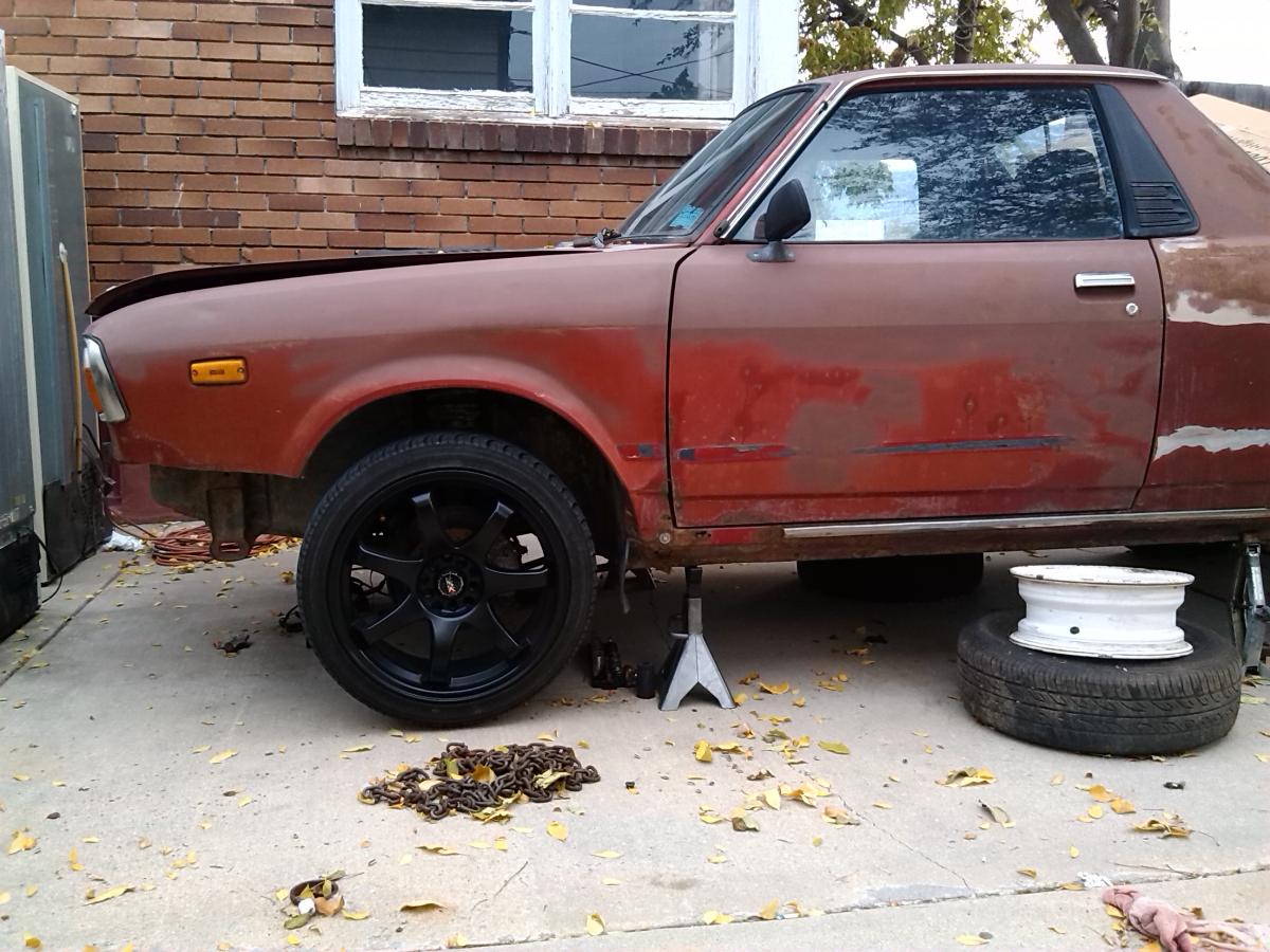

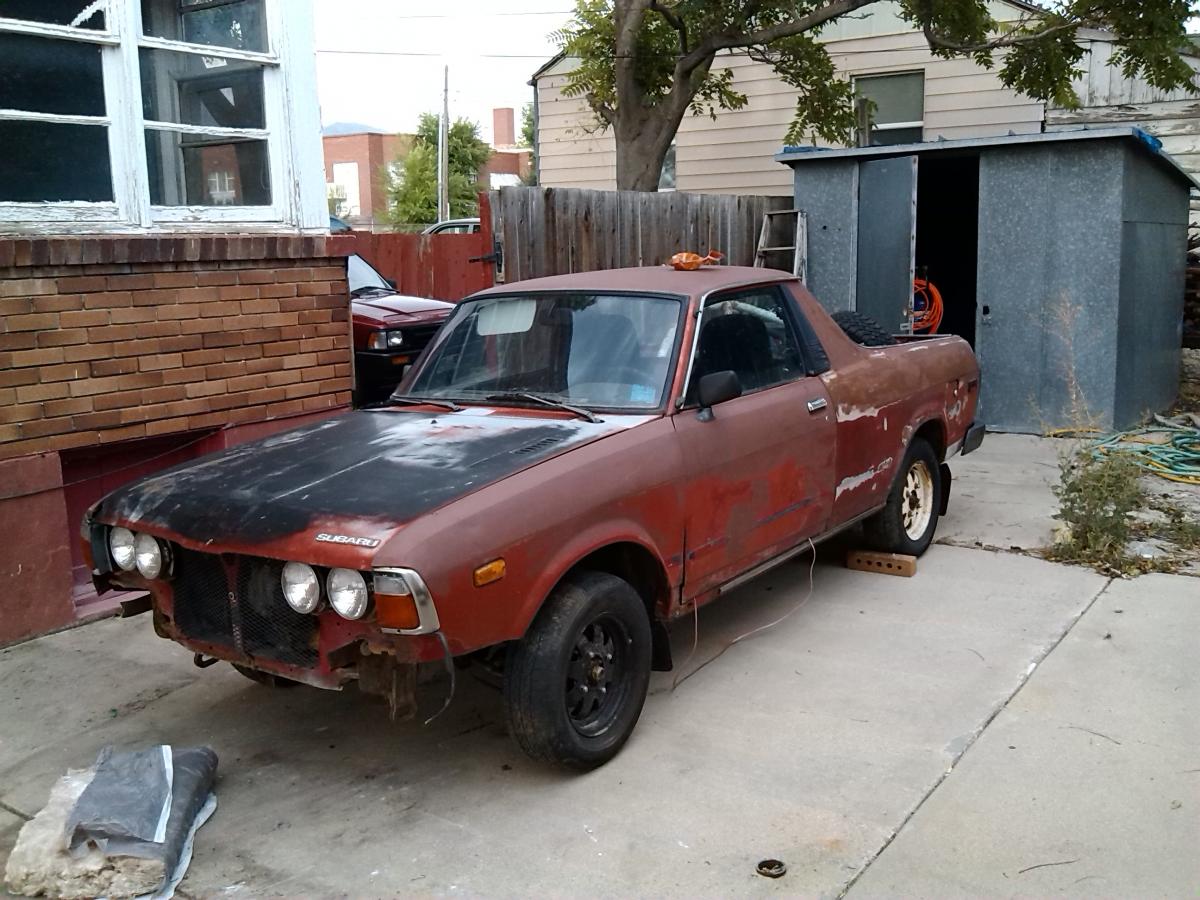

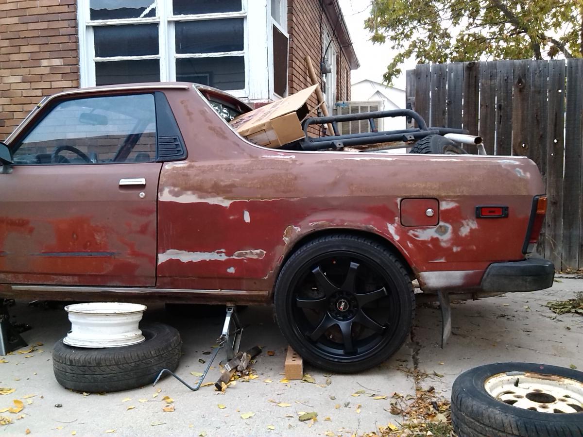

97jltanner Posted October 27, 2013 Share Posted October 27, 2013 (edited) For the last few years i have dreaming up a slammed Brat that has some nice wheels and has a rat rod look to it and I finally found one to start on. I picked this one up in Salt Lake UT so it has some rust but over all its in pretty good shape. The motor was half way taken apart because the guy I got if from said that coolant started to come out of the valve cover breather one morning and he thought it was a head gasket leak but he gave up before he found the problem. It turned out to just be a freeze plug in the head popped out. So I just went ahead and just rebuilt the top end of the motor and it runs great. Im going to do a build blog as I go so any advice and comments would be great Here are a few pics of what she looks like. This is the Lil 1.8 all fresh and back together an going back in. I put my WRX wheels up to her to see what they would look like. I think 18s are a little to big haha. Edited October 27, 2013 by 97jltanner Link to comment Share on other sites More sharing options...
