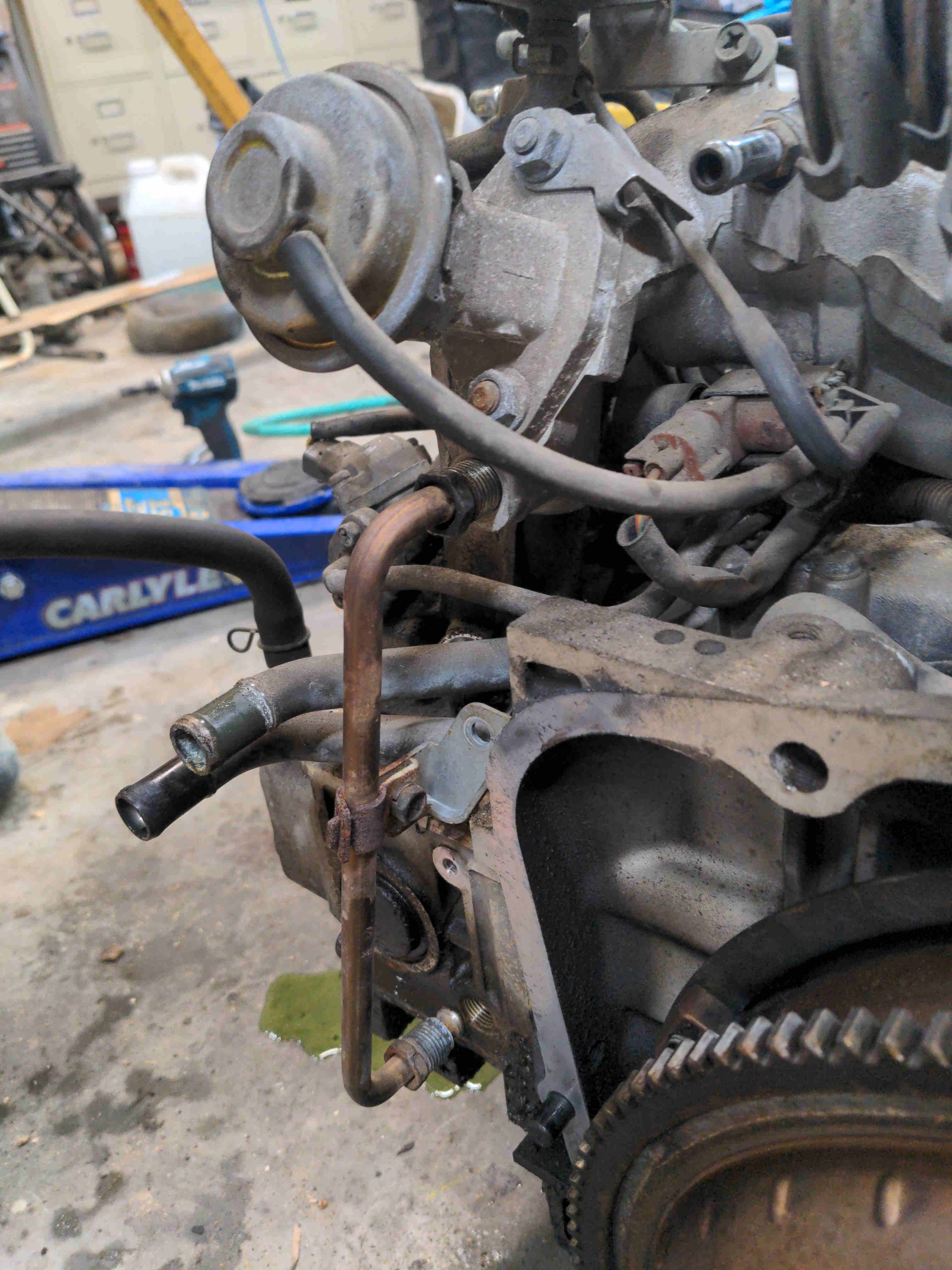

This is right along the lines of what I had to do dropping a 2000 Legacy engine into a 2003 Legacy. They made the first two or three years of that era with the EGR but didn’t for the last two. Or the other way around. On that one, as you should do, keep the original intake. You’ll have to get the drill and tap for that EGR pipe. Don’t drill too deep. Take the other one out and measure that depth and put some tape on your drill bit as a marker. I think it’s an M22 x 1.5 but double check that. I might have that set still. I had loaned it but I think Jesse gave it back. But for me to find it right now would be tough. Otherwise I’d mail it to you. I had my daughter get it from Amazon and it was like $16 for the set. Use a smaller pilot drill first.
What is this thing on the back of the intake manifold? It's a '95 Legacy wagon with automatic. We're trying to swap in an engine from a '96 Legacy with a manual, and it doesn't have this excrescence on the manifold or the hole in the head for that copper pipe to thread into. We're going to swap the '95 manifold onto the running '96 engine, but there is no way we can install that copper pipe onto the '96 head. So, what is this, and can the '95 with AT work without it? can we just put a plug in that thing where the copper pipe goes, and live without it? The thread where I'm documenting the swap is here: Had to delete the picture there to make room for this one.
