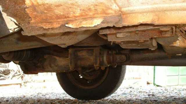

Also, check carefully for rust on the tubing that the rear diff mount to. My 88 rusted to the point that the tube started to twist, lowering the front of the diff, causing it to hit the driveshaft. Initially, it was intermittant, only under certain loading from 4WD. The first time I got under to find the noise, I could not see any way the driveshaft could hit the exhaust where the shiny marks were. Nothing would move far enough by pushing and shoving. A few months later, it was no longer intermittant.
