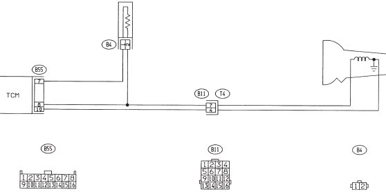

	I've attached a wiring diagram of the Duty Solenoid A circuit. If you disconnect the 16-pin connector B11 from T4, you can check the resistance of the solenoid between T4 pin 4 (ground) and pin 7. Expect to see about 3 ohms (the tolerance is about +/- an ohm). The part shown attached to B4 is the dropping resistor, which tempers how hard the shifts are. In addition to checking for open circuits, you should also check for shorts/leakage to ground.
