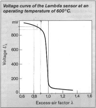

  13. Once the car is fully warmed up, depress the throttle a little. Does the voltage rapidly sweep between 0.2V and 0.7V? or there abouts? If not, then the O2 sensor is bad. You are backprobing the sensor right and leaving it connected to the computer, right?
  14. Your O2 sensor should fluctuate between 0V and 1V. 0.45V on a narrowband is stoich. Your O2 sensor is bad. I've attached a graph of what the O2 sensor should be reading. Notice closer to 1 volt, the richer the mixture and closer to 0 volt the leaner the mixture. NOTE: In this graph, lambda represents the scaled ratio of air/fuel. 1.0 would be equivalent to 14.7:1. I don't think the lines are quite drawn straight on this graph as 450mV should be right at 1.0
