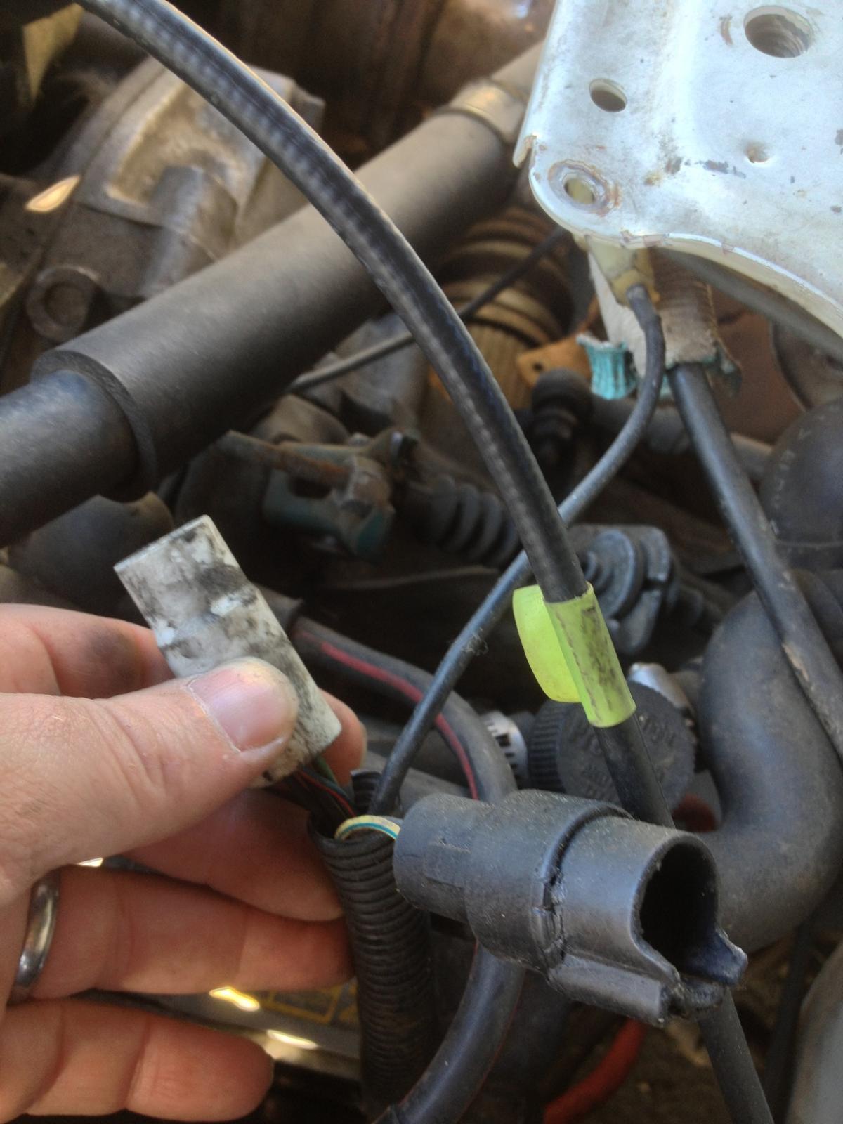

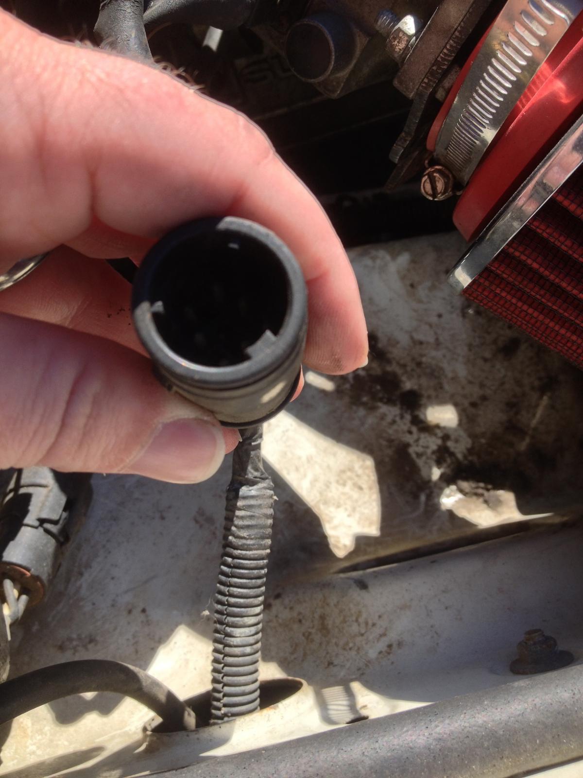

Need help IDing some connectors

so on closer inspection, the one in the fender is definitely not the boost solenoid, since the boost solenoid and the injector resistor and the boost switch are all connected and operating... The harness runs into the fender, up the wheel well and then into the main harness. -

Did some poking under the hood of the TWag today, on the passenger fenderwell near where the air filter box used to be is a black connector, and over near the starter (the wire for the O2 sensor is in the same harness) are two more, a black and a white. Can't find any mating connectors, any ideas? Don't think they have anything to do with it running like @*$*#*! though... One in the fender: One by the starter
