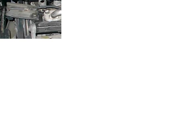

  13. This is what the mounting looks like on mine.
