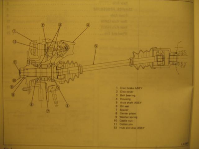

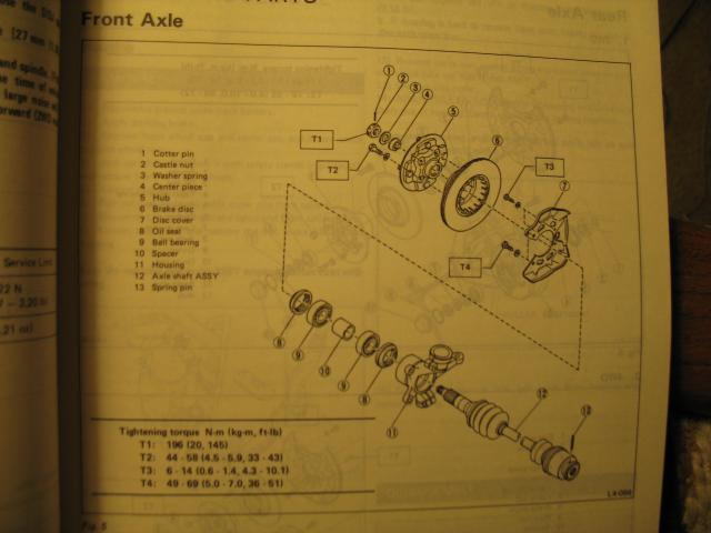

  6. Broken boot on the CV joint side of a half shaft. Cannot tell from oem service manual if removing the bearings, spacer and inner/outer seals from the housing is required in order to replace the entire half shaft. If so, are new bearings, spacer, and inner/seals required? Can the CV joint be rebooted by alternatively breaking down the DOJ after its been removed from the differential spindle with the axle still in the housing? Thought here is to only replace the CV boot. Thank you.
