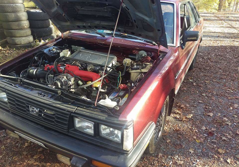

The 99 sohc ej20 @Steptoehas in his brumby has the exact same external dimensions as the sohc Ej25. @Ritchieasked to see a dohc engine in an ea81 bay so I posted it. Just because you can't see it happening doesn't mean it won't fit. The fact that it's been done several times would seem to definitively prove you wrong. Maybe you should get over it. -

This is the best I've got at the moment. I have pics of the clearance between the rails and timing covers on a old phone or laptop. Just a matter of finding them. -

The clearance problem for the dohc engines isn't at the valve covers, it's the timing covers. There was plenty of room between the back of the valve covers and the frame rails. While I haven't done one, it's also obvious you haven't either, but it has been done numerous times by the Australians. So there is plenty of evidence that it will fit. -

I've done dohc ej swaps in ea81 cars without cutting the rails. Any sohc fits fine. -
