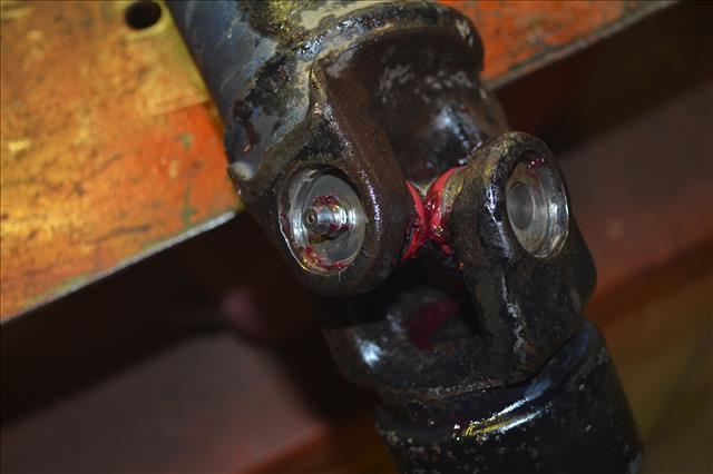

I did this on my 96 legacy , now im doing the center shaft on my 1986 gl 4x4 . this guys video segements are good http://www.youtube.com/user/bootsnthejeep?feature he has 17 segments , kinda long but good info,, but I was successful , the part # for the joint from autozone is duralast 2-0430DL 20 bucks each.. ouch . i was going to source one from rock auto , heres the result..
