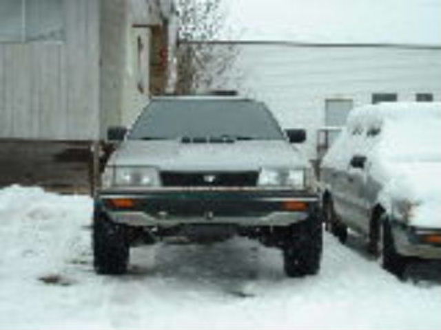

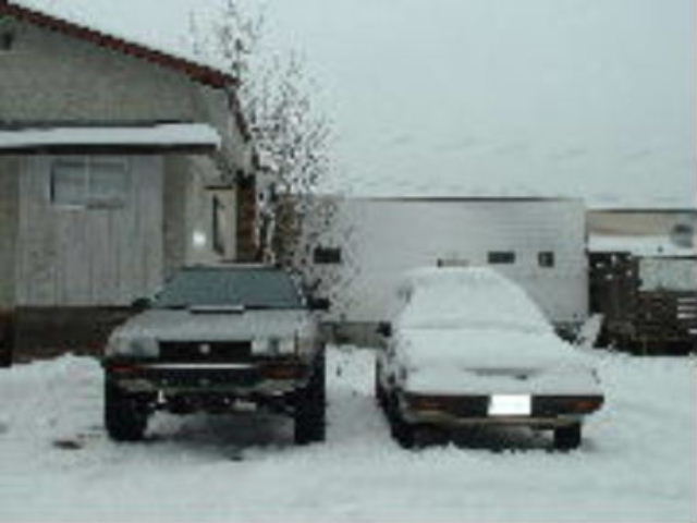

Still have to install the LSD, the oil cooler, and fix up the paint around the wheel wells but i took her out into the snow today, man I LOVE the ride height! Snow banks, ditches, water bars, no problem clearance is not an issue any more! I'm still haveing probs with resizing, better qualitiy photo's are in my user gallery, I will try to fix these photos.
