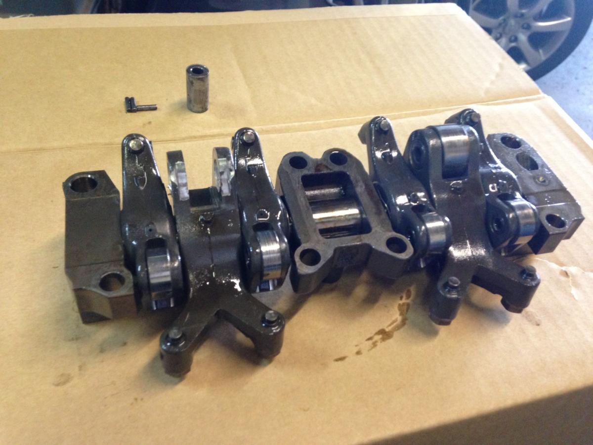

EJ22 broken rocker arm?
pvenuti replied to pvenuti's topic in 1990 to Present Legacy, Impreza, Outback, Forester, Baja, WRX&WrxSTI, SVXIvans Imports thanks for the thought we will have to look into that. Right now the engine builder is sending hydraulic lifters as they feel the solid ones where a problem.
pvenuti replied to pvenuti's topic in 1990 to Present Legacy, Impreza, Outback, Forester, Baja, WRX&WrxSTI, SVXI agree. I guess its good not to hear that this is a common problem or the combination has been found to be bad.
pvenuti replied to pvenuti's topic in 1990 to Present Legacy, Impreza, Outback, Forester, Baja, WRX&WrxSTI, SVXThis is great stuff guys please keep the thoughts coming.
pvenuti replied to pvenuti's topic in 1990 to Present Legacy, Impreza, Outback, Forester, Baja, WRX&WrxSTI, SVXNorthWet thanks for the response. Have you seen many snap is it a thing or rather unusual? Can anyone else comment on the rarity of this happening. I ask because we need to put it back together and want to know if the solid lifters and delta cam are a problematic combination. If so what do people recommend, would Hydraulic lifters be any more forgiving in this situation? What's the downside to going with the Hydraulic ones. Thanks
pvenuti replied to pvenuti's topic in 1990 to Present Legacy, Impreza, Outback, Forester, Baja, WRX&WrxSTI, SVXSorry I don't follow the question about the rockers used on the cams. I think you may be asking a similar question to above which is was the head originally setup with hydraulic lifters and corresponding roller rockers (YES). Where the solid lifters and rockers swapped into this engine as a performance mod with the new cam(also YES). As I understand it this is a pretty common thing to do so we where surprised to see the roller snapped off around 5k miles on a rebuild done by one of the larger compaines.
pvenuti replied to pvenuti's topic in 1990 to Present Legacy, Impreza, Outback, Forester, Baja, WRX&WrxSTI, SVXIt's an EJ22. I know the grind as low end torque. The rockers and lifters where swaped in.
This photo is of a broken rocker arm from an EJ22 using solid lifters and a Delta cam. Can anyone tell me how common an occurrence is it for a rocker arm to break? Is there any more likeliness for this to occur with solid vs hydraulic lifters? Any insight greatly appreciated.
