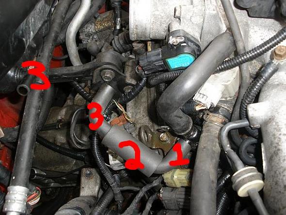

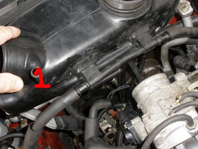

  12. I've got a 98 legacy obw with a ej 25. I've marked up a couple of your pictures. I'm calling the rubber pieces you can remove hoses, and the connections coming out of the airbox tubes. Hose #1 goes from the y in the pcv system to the tube that I've marked as #1 in the air box. The two hoses in the same picture as tube #1 should stay where they are in that picture. Hoses #2 and #3 don't attach to #1. They go from tube #3 that I've marked in the picture to tube #2, that is on the back side of the airbox -- opposite of where the airbox connects to the throttle body. So yes, hoses #2 and #3 route one tube on the airbox to another tube on the airbox. Don't ask me why. Hope this helps.
