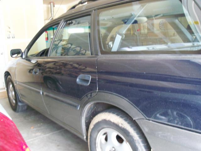

  4. Just took my first few pics of the car today...cant wait until the torque bind problem is gone and I can really drive it.
