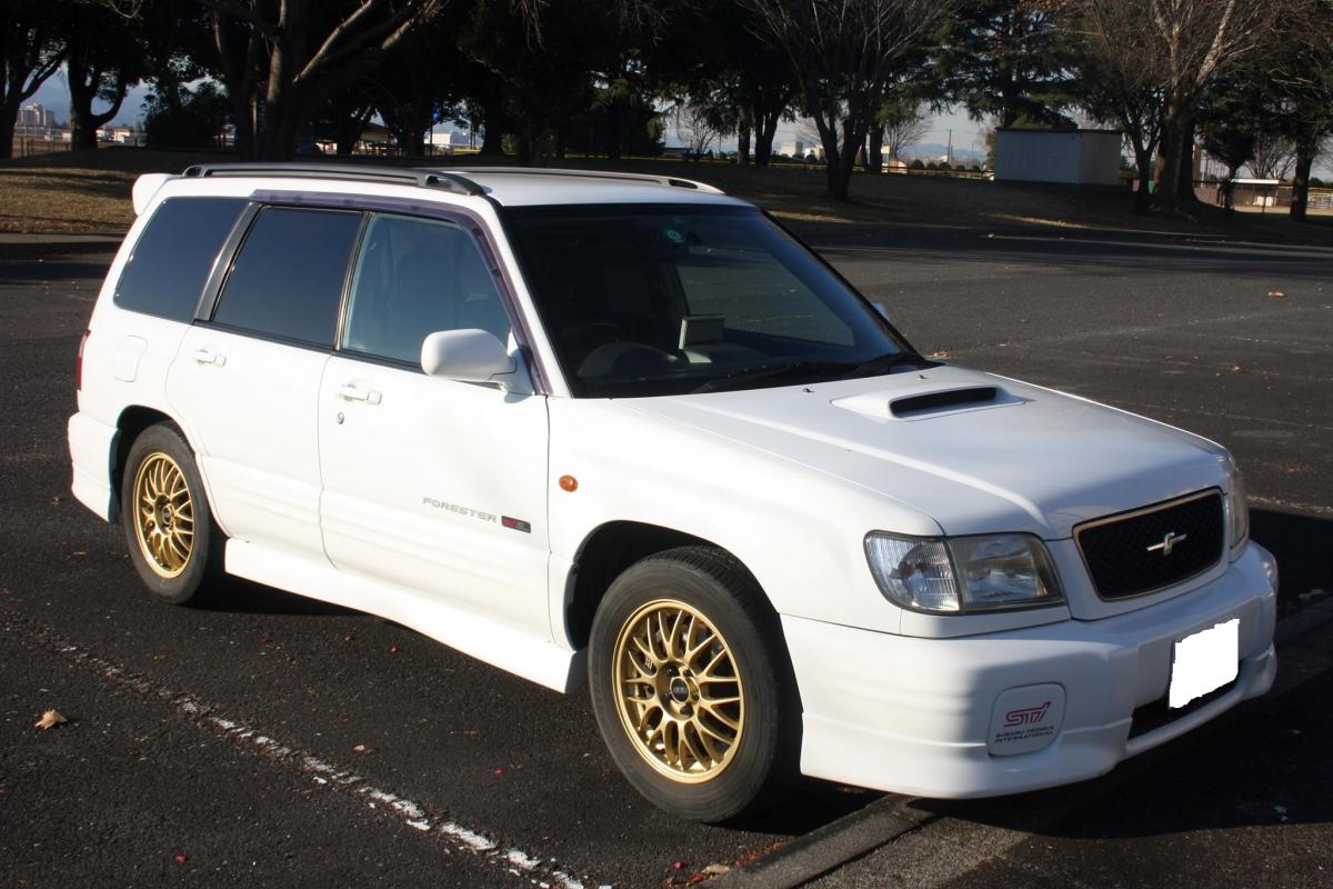

So while I was here in Tokyo I ended up buying my first Fozzy... 2000 STI Forester (SF5 flavor). The idea is to gut it to bare chassis and swap it into a USDM chassis, as close to 100% swap as possible. Any insight on what years would be best for compatibility? At present, I plan on putting some minor holes through the firewall to make the donor RHD but swap a MPH overlay onto the existing speedo rather than flash the ECU. I have heard tales of Jspec OBD-II being incompatible with US readers as well.
