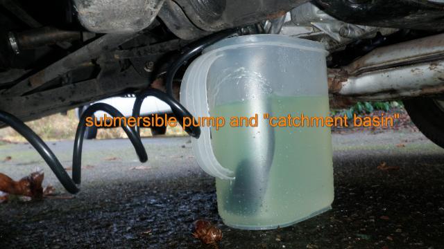

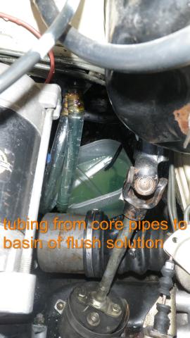

  1. I think the slow core flush worked! Well, i won't be cooking gas station burritos, but it's waaaay better. Hot air blowing out driver side and passenger side on the floor. I set up the system and let it run for about 4 hours today while I was making money for the cause. Tomorrow's a short day at the coal mine, so I'll probably mix up some fresh solution and let it flow while i'm putting everything back together in the cab, maybe squeeze out a few more degrees. The water in the catch basin started as clear water and finished as whitish-green murk. I could barely see the pump in the bottom of the basin when I opened the hood (maybe 4-5" under the surface). i hear snow's on the way, so it's going up to the local ski hill for the first time next week! 4wd and heat---plush!
