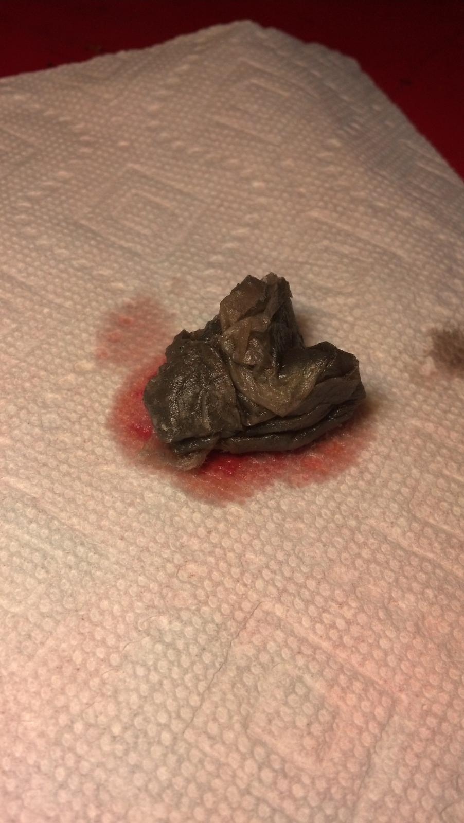

  6. While a gauge may be good protocol, i dont think i need further data on this one. Look what was inside the oil pump.
  7. Hahahaha, its easier to check if i didn't JUST pull the radiator. -sigh- I'll throw it back on and refill, because with my luck, I'd R&R the oil pump again, only to have it be a hose on the snorkus. Thanks.
  8. Well, yes, my concern isnt for the longterm health of the oil pump. My concern is that it seems to not be working correctly and being such a simple object, I'm confused as to what could be wrong. When I fired up the engine after reseal, I primed the oil pump with cranking and the HLAs got quiet, which seems to indicate some oil pressure. Then the OPS started coming on intermitently, so I began looking into things.
  9. Okay, today I resealed the oil pan, pickup tube, and PCV seal at back of oil pan. I also replaced the Oil Pressure Switch. Unplugged coil, cranking never puts out oil pressure light. No identifiable difference, but I'm knocking out options. I got a cheap oil gauge today, but the fitting is wrong, so no data from that. I'd love to hear some ideas about why oil pumps don't do their jobs after a reseal. I'm going to hack into it tomorrow anyway, but really appreciate things to look for or consider. Thanks.
