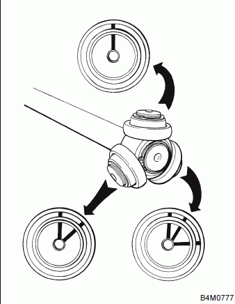

  17. Uhm... I guess that's where bad luck may show it's ugly face... The reason I'm considering doing the boots on the car is because a thread at NASIOC say it's possible (and because I really want to avoid being under a car with the current heat wave). I actually found the page on the FSM about replacing the boots, but on one point they say not to remove the axle, and the next one they say to do the same as the full axle overhaul (i.e. remove it, mount it on a vise, etc.) BTW: on the FSM I can see nothing resembling a disc other than the bearings on the trunnion... are those the one you are talking about? I wonder if someone around here has re-booted axles without removing them... the thread at NASIOC is kin of old to revive it... Edit: Sorry Fairtax... I didn't see your post on time. Somehow I had not considered juggling the transmission, although the FSM implies it's possible to remove the axle without any weird manouver. And while I agree it may be a PITA, reading about broken breaker bars, pullers, brass hammers and whatnot are starting to sound like $time$ to me...
  18. Question for GD: The Permatex instructions say it will fill gaps of up to .050" or so when used with a primer ("activator"). Any idea how/if it works on large gaps without the primer? Not that it applies to the water pump (nice machining there), but I can see some places where the surface may not be that flat (i.e. oil pan). BTW: I was really considering using the nice gasket that came with my Aisin water pump...
  19. Wait... can the axles be separated from the transmission without taking anything else apart? That can't be true, can it? Then what is it that's going to bite me in the butt? The outer boots seem to be fine, and I already spent all the money of the "since you are there" allowance so I'm not replacing the axles without confirming they need to be changed. So I'll be replacing the boots and yes, I'll probably be doing it from inside the engine bay instead of doing it from underneath. Uncomfortable and messy beats uncomfortable, messy and with a lot of crap falling in my face I need to clean the mess inside the engine bay as well (from the axle grease and the oil leak that lead to the demise of the EJ25D)... that's going to be some serious fun
  20. I guess the right question would be: is it really that easy to pull the inner end of the front axles from the transmission as some threads suggest? What's the catch? I'm waiting for some parts to arrive to start putting together my '99 OBW, so the EJ22 is still on the stand and I have good access to the sides of the gearbox. Both inner boots are shredded, but the previous owner told me he had not noticed any noise coming from the axles, so I'm thinking about just replacing the boots. My goal is to separate the inner ends of the axles from the transmission, clean everything, reboot and put together -said the optimist guy-. But I know there's something ready to bite me in the lower back -there's always something ready to mess you up when fixing a car- so... what is it? I have read about removing one of the strut bolts and loosening the other one, and the one I like better: removing the bolt holding the front suspension arm -if I remember correctly-. On the last one, though, there's a note saying "this is for a EA81". Is the post still valid for a '99 OBW?
