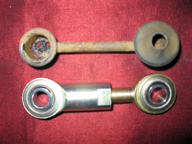

I would imagine the Whiteline links are still available somewhere.. but I remember them being pricey ($150)! I believe the part number is KLC044. I agree the rear OE links are pretty weak, mine disintegrated a while back (of course it is awfully salty up here!). I made some out of heim joints (1/2") and they seem pretty solid. I've been meaning to post completed/installed pics. http://www.ultimatesubaru.org/forum/showthread.php?t=114353 Have you tried contacting Rallitek? I wonder if they have other "straight" links that are close length wise. Could always go with the "MOOG" links from rockauto/local auto store, but they aren't exactly cheap either, but look thicker than the stock ones. On a side note, how do you like the front/rear sway bar setup, been thinking about picking up at least the rallitek rear bar. Cheers. -
Interesting, the PVC is strong enough? I wonder where I could find that.. I actually was able to find a couple rod end/heim joints locally this evening. While they weren't cheap, still less than most OE/aftermarket replacements. ~11/piece x 4 pieces (I'm sure cheaper if I ordered online). I opted for the 1/2", but the sway bar hole is only ~3/8" (or whatever the closest metric is), so I would need to get a sleeve to reduce the size for those bolts. Plus some washers, a lock nut, and maybe some rubber grommets. Still seems very strong and adjustable to boot! Maybe going down a size to 3/8" would be a cleaner solution, and stil strong enough? Compared to the OE links I'm sure they'd be tons better!

'02 OBW. Recently discovered one of my rear end links had broken apart. I'm trying to figure out what the best replacement/upgrade route is and wanted to see what folks thought. Pretty positive that in the next month or so I'll pickup a new rear (maybe front too) sway bar from Rallitek or Whiteline. I can't quite justify spending 100+ for new Whiteline links. So I'm wondering if it would worth it to go with the MOOG aftermarket OE-style end links which seem a bit sturdier, and run about $60-70. OR stick with OE ($50) or a lot less if I can find some in decent shape at a local yard. Thanks for the suggestions!

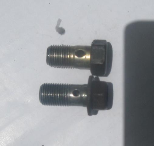

So I'm swapping some front '03 (pretty sure) WRX calipers over to my '02 OBW. Upon pulling the banjo bolt I noticed the sizes are slightly different. (14mm WRX, 12mm OB). Pitch is the same, but the "newer" WRX bolts are slightly shorter... maybe 5mm-ish, the holes on the side of the WRX bolt are also dished a bit. So.. maybe they changed the size of the "banjo" piece on the end of the brake line to a narrow one hence the shorter bolt? Thoughts on which I should use, or maybe it doesn't even matter. Thanks!! Edit: Pics, Hmm, maybe they are closer to the same size than I thought.

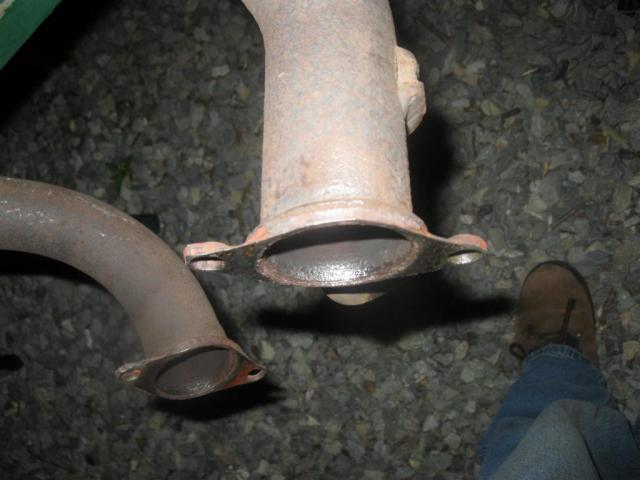

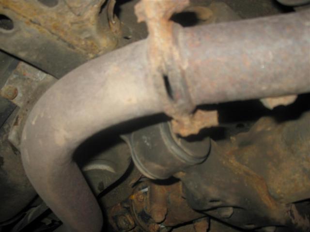

The rust is definitely pretty weird. I noticed that the flange on the back of my cat is rusted fairly bad, but the flange on the front of the pipe that goes to it looks new. Go figure. Must have something to do with the salty mess they throw on the roads up here and how it splashes and sticks to stuff. Also, I could be completely wrong, but I can't imagine those springs do all that much once they get rusted up after a few years. There seems to be a lot more give in the rubber exhaust mounts in the back half of the system.

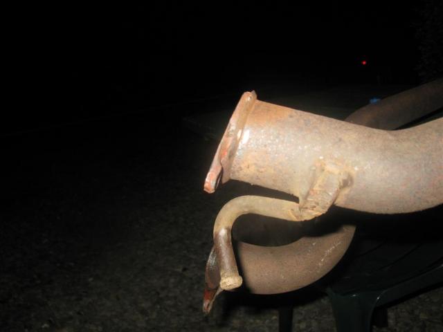

Hehe, definitely does look thin. Probable has to do with my low-light outdoor "garage". A quick measurement in the dark says it's a tad under 1/8" i'd say maybe it's 3/32. Not quite as thin as 1/16. Definitely can not bend it by hand, in fact i put a good amount of heat into it with a torch when i punched the bolts (or what what was left of the "bolts") out.... Hmm, might have just answered my own question. Good idea on the high temp paint. On a side note, the rest of the pipe is solid, why can't the make the flanges that good?
Kinda funny that there have been a couple, recent threads related to this. http://www.ultimatesubaru.org/forum/showthread.php?t=111381 http://www.ultimatesubaru.org/forum/showthread.php?t=110512 My question is; how little is too little? I had an exhaust leak appear at the axle back joint, I assumed that the flange was completely toast so I planned on just trimming things down and welding in a permanent one of these (so long gasket): However, after grinding/punching the bolts out there does appear to be a "decent" amount of flange left. My question is, I have no idea how this compares to the stock amount. Your thoughts on just bolting this back together, will it last a month or two, a year or two maybe? Cheers and thanks, Nick
