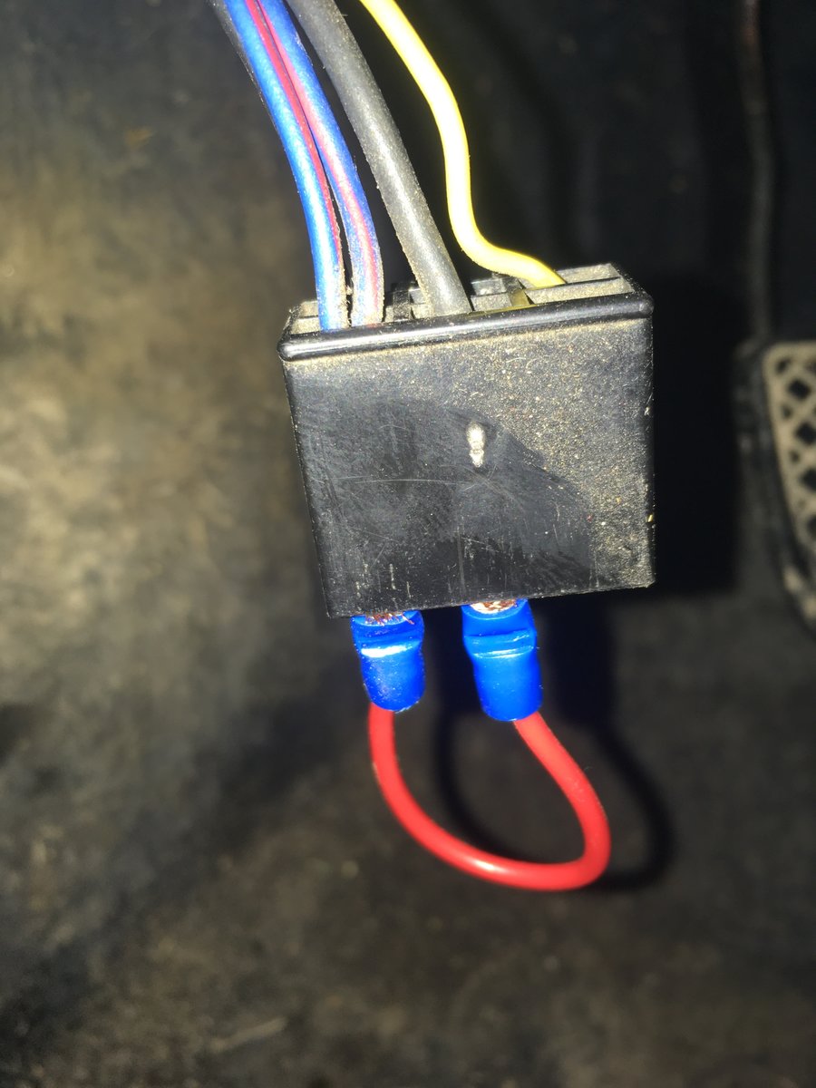

Thank you Guys.. my Grandson is stoked to get it..Taking out the welded diff tommorow. Let him learn the ropes before he gets in trouble up in the woods or having to replace wheel bearing ect from driving with the differential end welded up..Thanks again ,Todd so i put this on and Nada....the pump worked hotwired from the battery but not like this...is that hooked up right ? i will go check the fuses ect...thank you again for the help,todd
roll over switch ?
cool ...I will check that out ,Hope your doing ok in these crazy times insert big thumbs up Hmmmmm ? its just over the years i have replaced that to get the pump going...and assumed it was bad.so can a guy just run a hot wire that the key can shut off to the pump lead on the revolution senser ? or just spend the cash and do it "the right way"?
roll over switch ?
Hey gang.my grandson is buying my 1984 hatchback. the roll over switch ? (the small blue box just above the hood latch ) is bad. I have it hot wired off the battery now,but need a more permanent solution ... can a guy buy one of these somewhere? is that the right name/ i was always told it was a roll over switch..? so...... any thoughts ? thank you ,todd

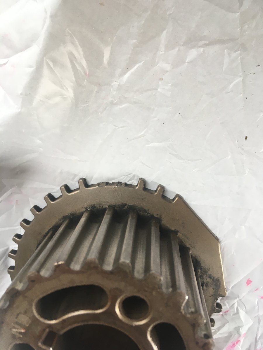

1996 opps 1998 2.2 imprezza timing belt install
Well guys... i just got a belt that matched the one i took off...and that part is fine..But the no start ...After looking everything over 50 times hahah i realized I had broken a few teeth on the outside of the crank shaft sprocket while prying it off.....The ones that line up with the sensor ...duh ? Live n learn.... put in a good one and VaRoooom..easy peasy Japaneasy....Thanks Guys .
Now don't be starting trouble old timer hahaha well now you have haha...,this engine had the newer style tenisoner on it and it needed a longer belt.it was impossible to put the stock one on. the one i got at the dealer matched right up .it was for a 2000 2.2 with the newer style tenisoner .now beside all that ...i still can't get it running.all the hash marks are straight up ,matched up with the belt marks and NADA.. its firing some but won't start ....... just tell me a quick fix hahaha
