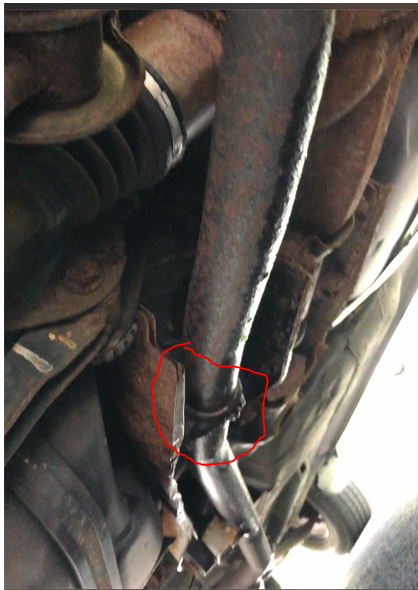

  2. Thanks for the replies. The problem area is where #7 and #9 connect in lmdew's diagram. So, that is why I thought there was no donut and spring involved. Do the above answers change based on that location? Here is a picture taken from the rear side of the car (red circle is the problem area). The top of the picture is the rear side. The muffler is not in the picture, but it would be above the top side of the picture after an additional bend toward the rear. The tires you see at the bottom of the picture is the front of the car.

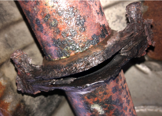

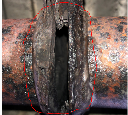

  3. lmdew - you said donut gasket, as did heartless above, but then your last response said thin gasket. So, I'm a bit confused. Pardon my ignorance. Is the rounded collar looking thing (circled in red below) the gasket that is going over the 2 pipes to connect them, and the the two pipes are just straight pipes, or is the rounded piece on the pipes actually part of the pipe itself, and the gasket is just the part between that has the broken gap?
  4. Sorry one more question. You said a donut gasket. The connection I am talking about with these 2 pipes is towards the back of the car. So, the bad connection is not the catalytic converter connection. So, I am thinking it's the thinner gasket, but I must admit it looks kind of thick in the picture.

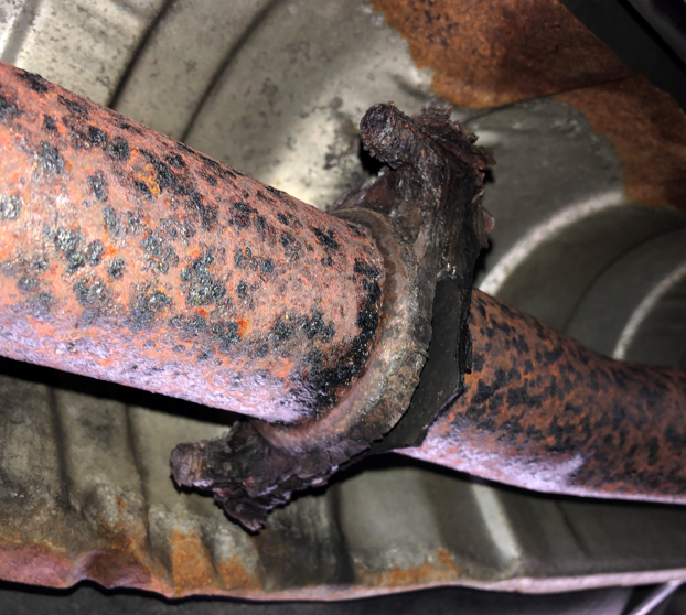

  5. Thanks. I've only posted a couple times in the past, so I don't know who GD is, or where to find the post. But, I think my main question is: How am I going to separate the 2 pipes that are still attached with the 2 very rusty bolts?
  6. I have a 1999 Subaru Forester. I have an exhaust leak between where 2 exhaust pipes connect. The connection between the 2 pipes is all rusted. I think there is a gasket that would need to be replaced, but I'm not sure what to do to overall as I am not sure if the collar looking piece around both pipes is permanently attached or comes off (I think it's attached). I have attached pictures. If it is attached, then how do I fix this? Thanks.
