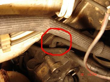

This is a picture of the hose on the passenger side of the tranny that I think is the vacum module, I couldnt find any other hoses that it could be. The picture is the passenger side top of the tranny right below the firewall. Is this hose a vent or something else? Also I can not find the modulator under the car, I heard ten inches behind the passenger axle but I cant see anything their, or find a hose going to it, any guidance would be great.

I found two hoses, one of which is on the passenger top side of the transmission and the other is right in the middle top of the transmission, They are both not connected to anything and were bound togehter with a zip tie. Anyone know what these are and where they should be going.
