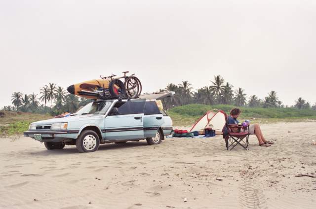

Well, just to add another story. I have a 1989 GL-10 Turbo bought for $50. The engine blew on the Blue Ridge Parkway and was replaced with a 1988 XT MPFI non turbo engine with 120K miles. The care then made it back to Colorado where it became a daily beater. When the engine had 150K and the car had 225K, the road trip started. We left CO for Bozeman, MT and back. On the return trip we had a additonal gear in the form of a whitewater raft frame and all need accessories. Once back in CO, packed for a 6 month journey through Mexico and Central America. The car was loaded down to the max. All camping gear and supplies needed to make the journey, including a Mt. Bike, kayak, raft oars, raft frame. When we crossed from La Paz to Matazlan, the car was weighed and based on the Subaru specs, we were hauling about 1200 lbs of gear. The trip took us from Colorado to SF, CA then south through Baja then after a ferry crossing to Matazlan down through Guatemala crossing from west to east and into Honduras. After touring Honduras, we then drove through Nicaragua to our temporary (3 month) location in Costa Rica. While in Costa Rica, we lightened our load on most occasions for our local trips. But when going to Panama to renew our visas and to complete the journey to the Panama Canal the load was only about 1/2 of the beginning of the journey. After returning to Costa Rica, we sold the raft to lighten the load. The car was evaluated by a mechanic and a few minor problems were fixed for $50 including changing the oil. The mechanic valued the car at $1500 - $2000 usd. With confidance in the car, we took an almost completely different route on the return taking us through new terrain. We encounterd various road conditons ranging from perfect high speed highways, to low speed highways with pot holes that a full size truck could not get out of, to the worst washboard roads known to man, to rally style dirt road driving, and even an attempt to drive up a volcano where only the steepness and lack of horse power turned us back. After retruning to the US (exactly 6 months later) into Arizona back to SF, CA and then back home to Colorado. Unfortunately, the car blew a head gasket after the 25k mile journey in 7 months with only oil changes, 2 flat tires (same tire, different holes and repaired on the road) and a rusted out exhaust pipe near the 2nd catilic converter (easily replacable in Mexico). We were less than 150 miles from our final destination but were able to limp the car to its final destination where I am going to put another 88 XT MPFI non turbo into the car to let it live again.
