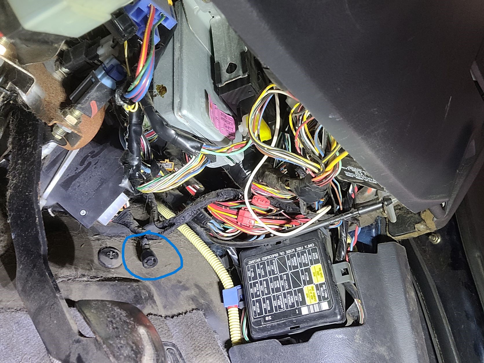

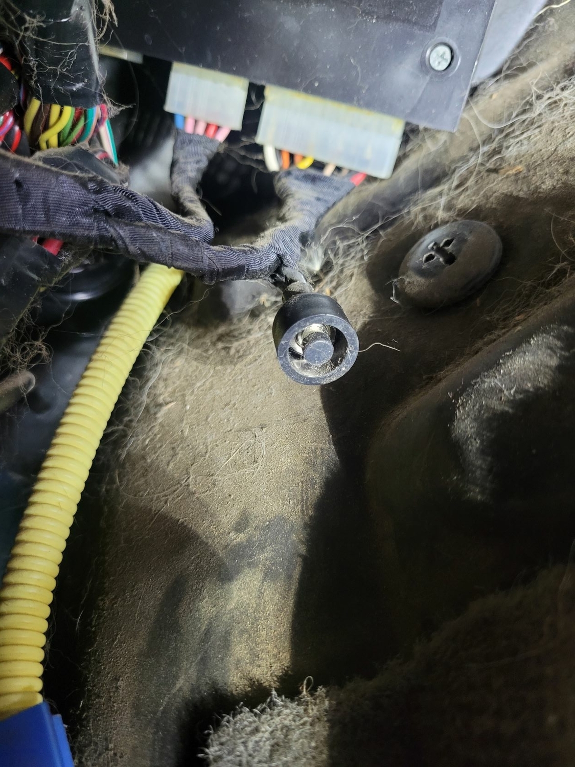

That's interesting. Thanks very much. On my car, when I unhook the battery or it goes completely dead I get the flashers going off but not the horn (lucky me). I don't have a key fob, so whenever that happened I'd have to remember what I did to get the flashers to stop. Usually I would end up coming here or google. I eventually learned that if I disconnected the battery, turned the key on, then hooked up the battery that the flashers would stop. I don't recall ever seeing anyone referring to that little switch before. Again, thanks. Learn something new every day. Hooking up the battery with the key turned on doesn't really sound like something you should be doing.
I was messing around still trying to figure out why only one of my cooling fans was coming on (I have another post for that), and I noticed something that had never caught my attention before. It's this little black button switch thing coming out of one of the wire harnesses down under the dash near where the fuse box is located. It looks like some kind of a reset button or something. Does anyone have an idea what this thing is, or what it's for, or what it's supposed to do? 1996 Legacy Outback, 2.2L, manual transmission.

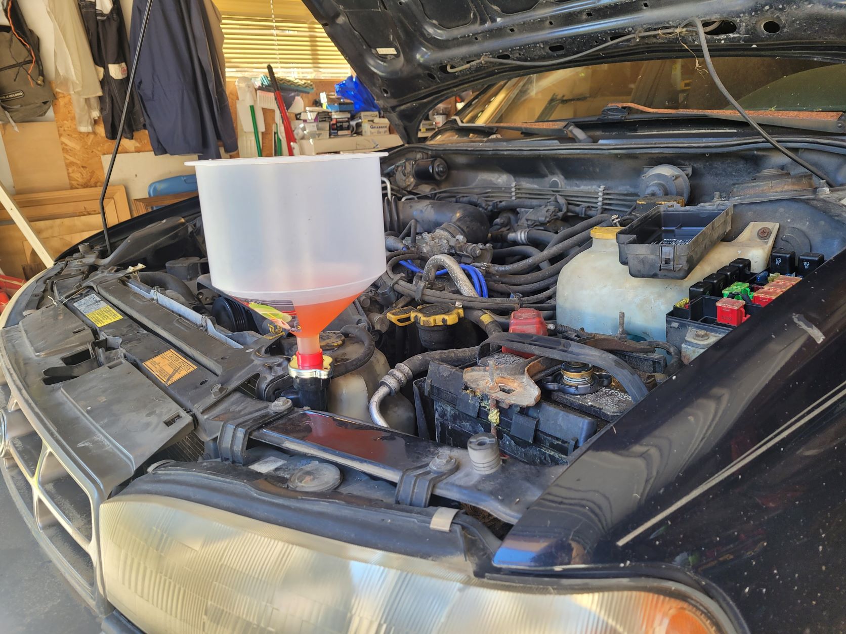

Well I am pretty sure I have all the air out of it by now. It sat overnight with that funnel on it and I just ran it for a half hour or so in the garage and no more bubbles, even when I rev it. I can't get the temp gauge to go above the mid level sitting in the garage so I'm going to put it all back together and start driving it. I guess one thing that confuses me is that I have owned and driven this car since 2007 when it had 57K on it. I put 250K miles on it over 15 years. I have had plenty of opportunites to remove and replace the coolant over that period. I knew about getting the air out but all I ever did was fill it up, drive it, and check it again later. I never worried about meticulously making sure I got every breath of air out of it before. I also still can't get that back up fan or sub fan or whatever it's called to come on, which was the original point of my post I guess. I still don't understand when it's supposed to come on. Now, when the gauge gets to about half way between C and H, the right side fan comes on. Seems normal. Is the left side fan only supposed to come on when the air conditioner is being used? What is supposed to trigger it seperately from that which triggers the right side fan? I'm thinking I have seen the left side fan on before but TBH I'm not completely sure I have. I verified that the fan works by disconnecting it and powering it up with a battery charger and a couple of nails and I checked all the fuses. At least I think I have. Again, thanks for all the replies. Much appreciated!
Yeah I agree with that sentiment. I'll drive it around the neighborhood the next couple of days and keep an eye on the coolant level and the temp gauge. It would not surprise me at all if my head gaskets were leaking. It is a 2.2L but I've got 308K on her! I am hoping that the coolant I added today was because it just hadn't replaced the air in the system yet. Even if it were leaking coolant to somewhere it doesn't belong I hadn't driven it enough to get rid of that much coolant. I was trying to get a feel for whether or not I could tell if the bubbling in the funnel was an indication of a head gasket leak, but I don't know enough about what I am looking for to make that determination. It wasn't like there was a constant bubbling in the funnel. There was intermittant bubbling, but there were long periods of time where there were no bubbles at all. When I reved the engine it would bubble a bit. I don't know if that's indication of a head gasket leak or just pushing more air out. Anyway, thanks again. I always appreciate it.
Thanks for the replies. I checked and swapped that 20 amp fuse. That wasn't the problem. I had already tested the fan that wouldn't come on by hotwiring it with a battery charger and the fan definitely works. I was just messing around with it in the garage, and the "burping the air out of the coolant" phenomenon presented itself. I had heard that it can be difficult to get all the air out of the system. I guess I just never knew for sure whether it was critical or not. So I got one of those radiator funnels or buckets that have the funnel built in to an included radiator cap with a bunch of adaptors. I put the funnel in place and started it up. It probably took about a quart or maybe even a half gallon to fill it, even though I had tried to top it off a couple of days ago. I started it up and let it idle for a while and watched the bubbles come out. I didn't really have to add all that much to keep fluid in the funnel. I kept an eye on the temp gauge and it got up fairly close to the H. Higher than it should have sitting in my garage. The "main" fan clicks on when the gauge gets to about half way. The other fan never did come on. Here's where it gets crazy. I stopped the engine, started it again, and watched the funnel some more until I was sure there were no more bubbles coming out. Then I gave the upper radiator hose one good squeeze. I hear this "bloop" and it sucked all the coolant out of the funnel into the system. I had previously given the hose a similar squeeze two or three times previously without the same effect. It sucked in about 1/4 of the capacity of that funnel bucket. Maybe not that much but a pretty good bit. As soon as that happened I filled up the funnel again. I noticed that the temp gauge dropped back down to mid range and it's been staying there ever since. Could that trapped air actually have made that much of a difference? From running up near the H, to down to mid level all just sitting in the garage idling the whole time?
