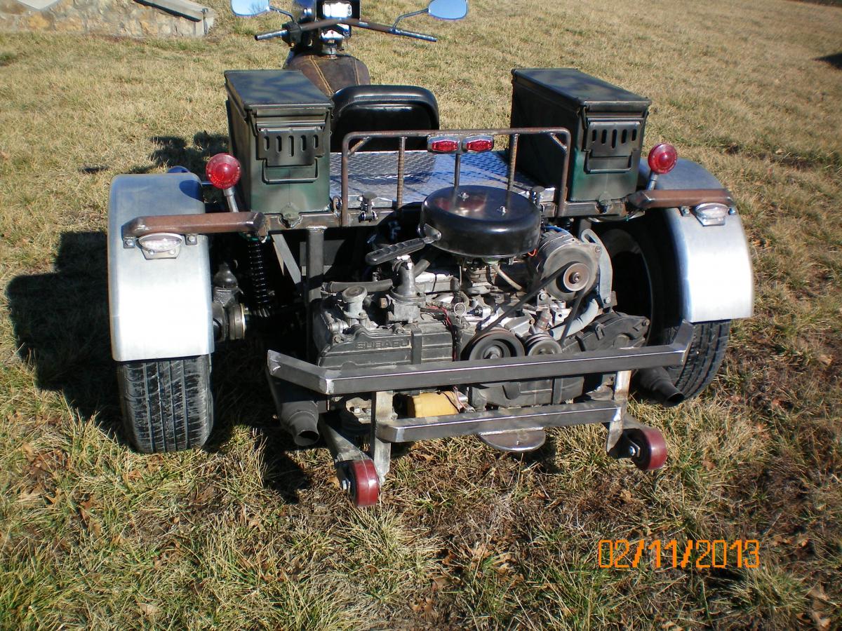

  2. Picture from the front. 2 GoldWing radiator's in front of rear fenders for cooling. Runs around 176 Deg. Adapted to a VW full auto trans. Kennedy adapter. 10 gal fuel. 32 MPG. Have 20,000 trouble free miles (ceptin sometimes a lifter tick). I have built around 10 trikes, VW's, Corvair's, 215 Buick, 151 Iron Duke motors, this by far is my favorite. Don't need no stinken paint, rust is like teflon--nothing sticks to it.
