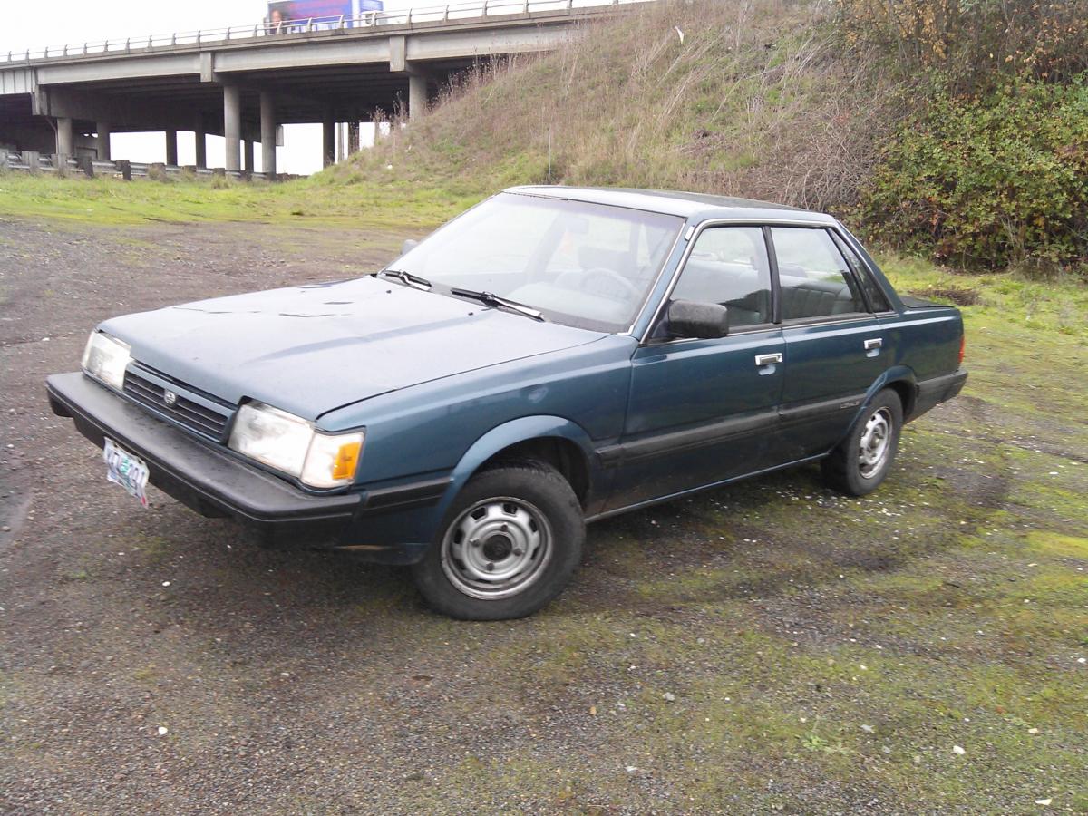

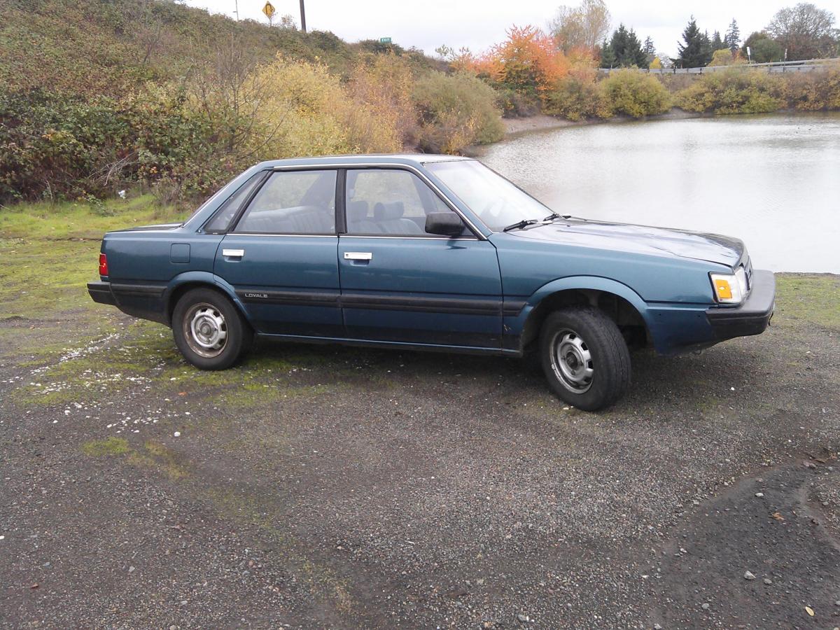

My new 93 loyale sedan
My new loyale 1.8l fwd 5-speed only paid $350 for her runs good, has a few issues but its hard to find a running car for 350 in todays economy.
