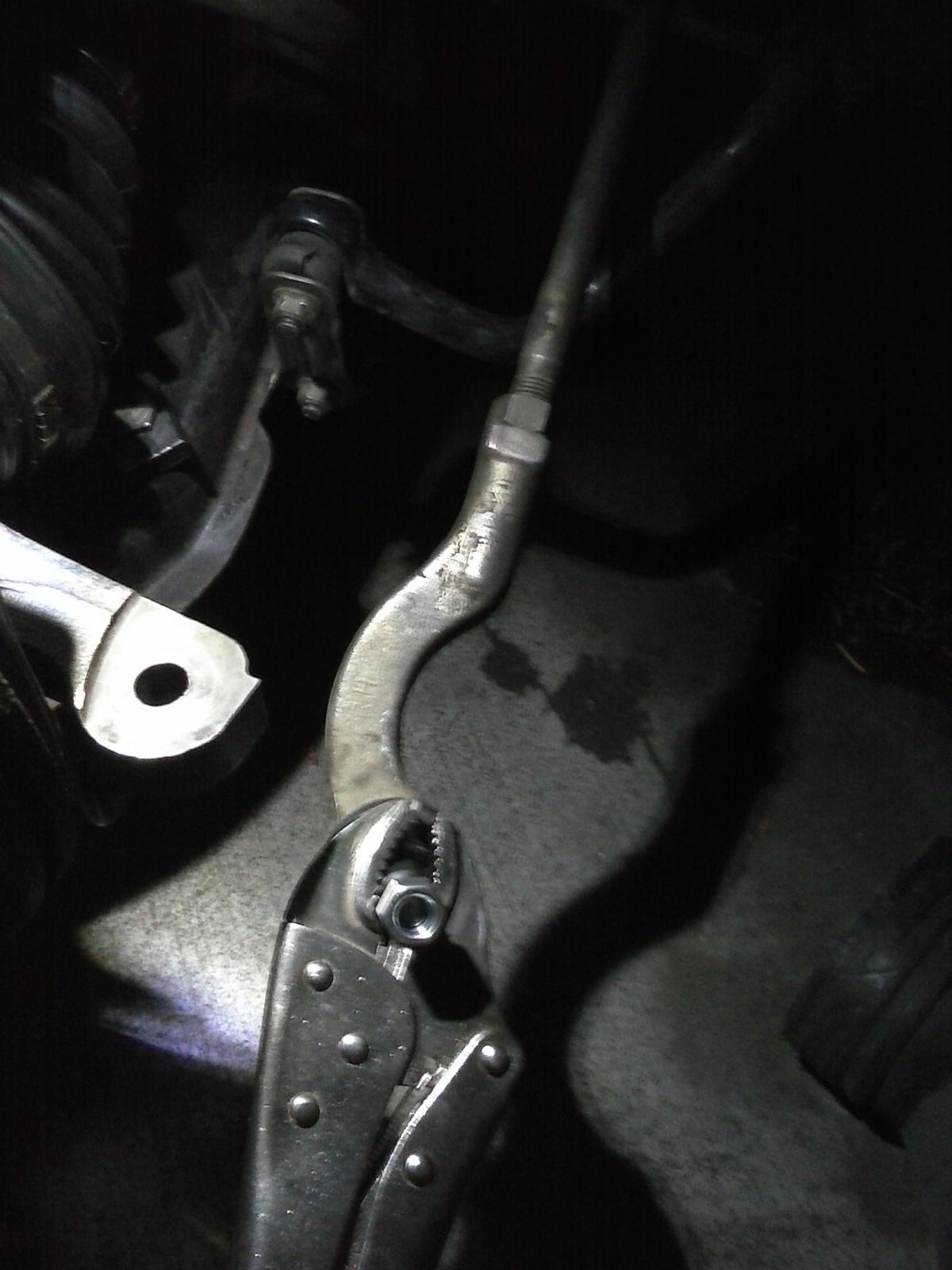

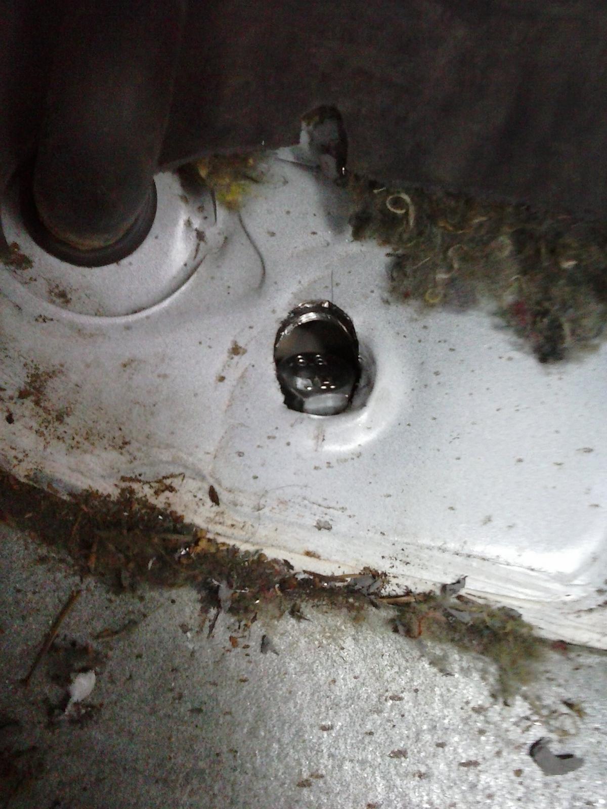

  7. Fixed a few days ago. Drilled out captive nut ( whose threads were stripped ) Got 60 mm , 12-1.25 bolt and lock washer. Repurposed old lug nut to hold it all together. Btw I LOVE air tools !!!

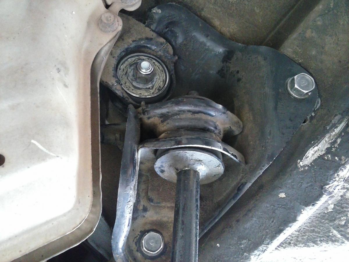

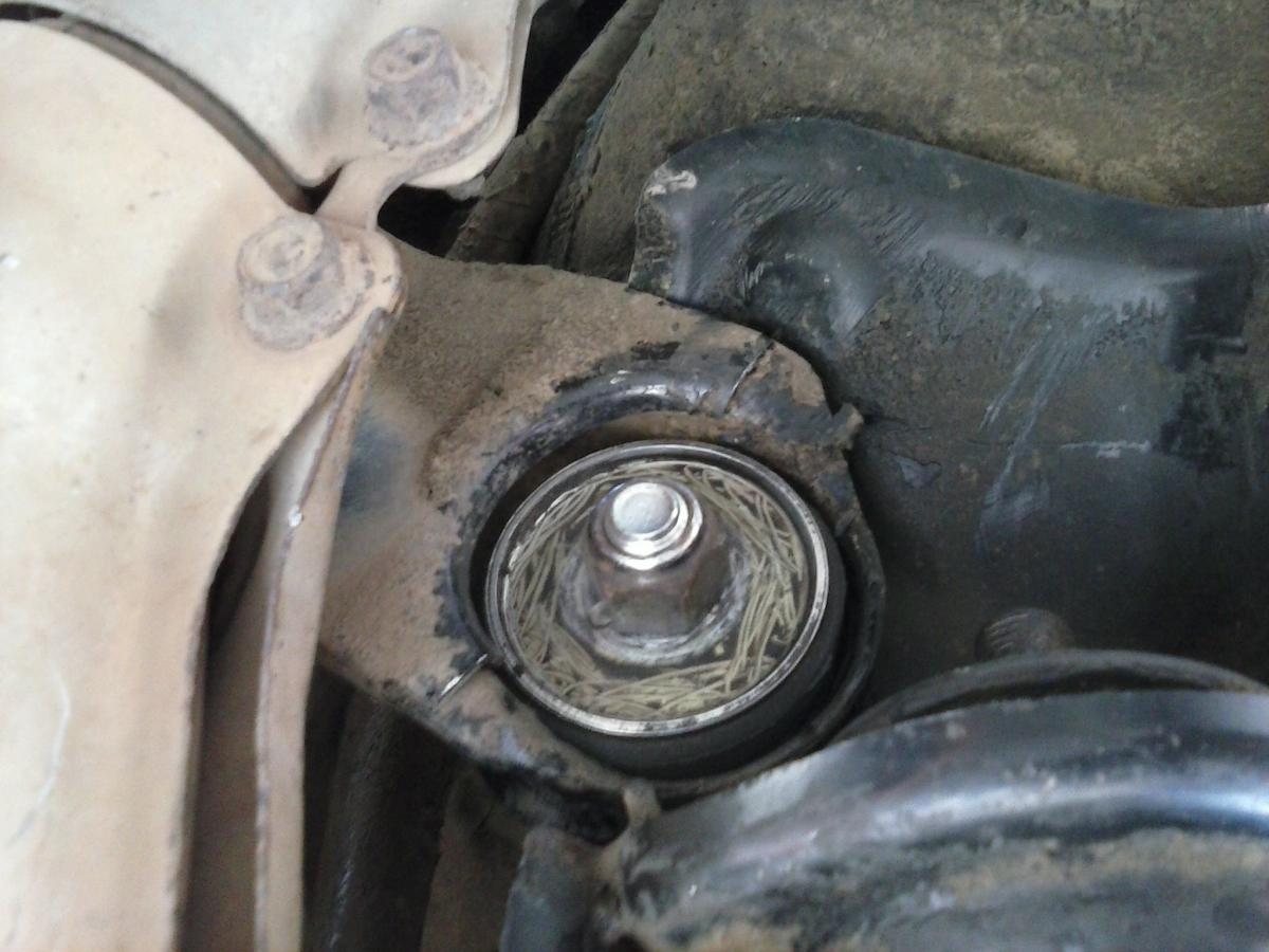

  11. So I removed the strut rod to allow for easier access to the cv-axle replacement. After tighten the 3 bolt that hold the strut rod mount plat to the frame / uni-body There is now a clank and i can see the plate moving when I bounce the car. It clank whenever I drive forward and / or when i hit a bump. Feels like the bolt stripped the nut off the sheet metal, INSIDE the uni-body. Question: Are there captive bolts inside the sheet metal? How screwed am I at a quick fix to this ? Will I have to cut open the sheet metal and weld up a bolt and bracket to fix this ? Video of movement and a little sound: https://www.youtube.com/watch?v=YcVGhVMevRs
