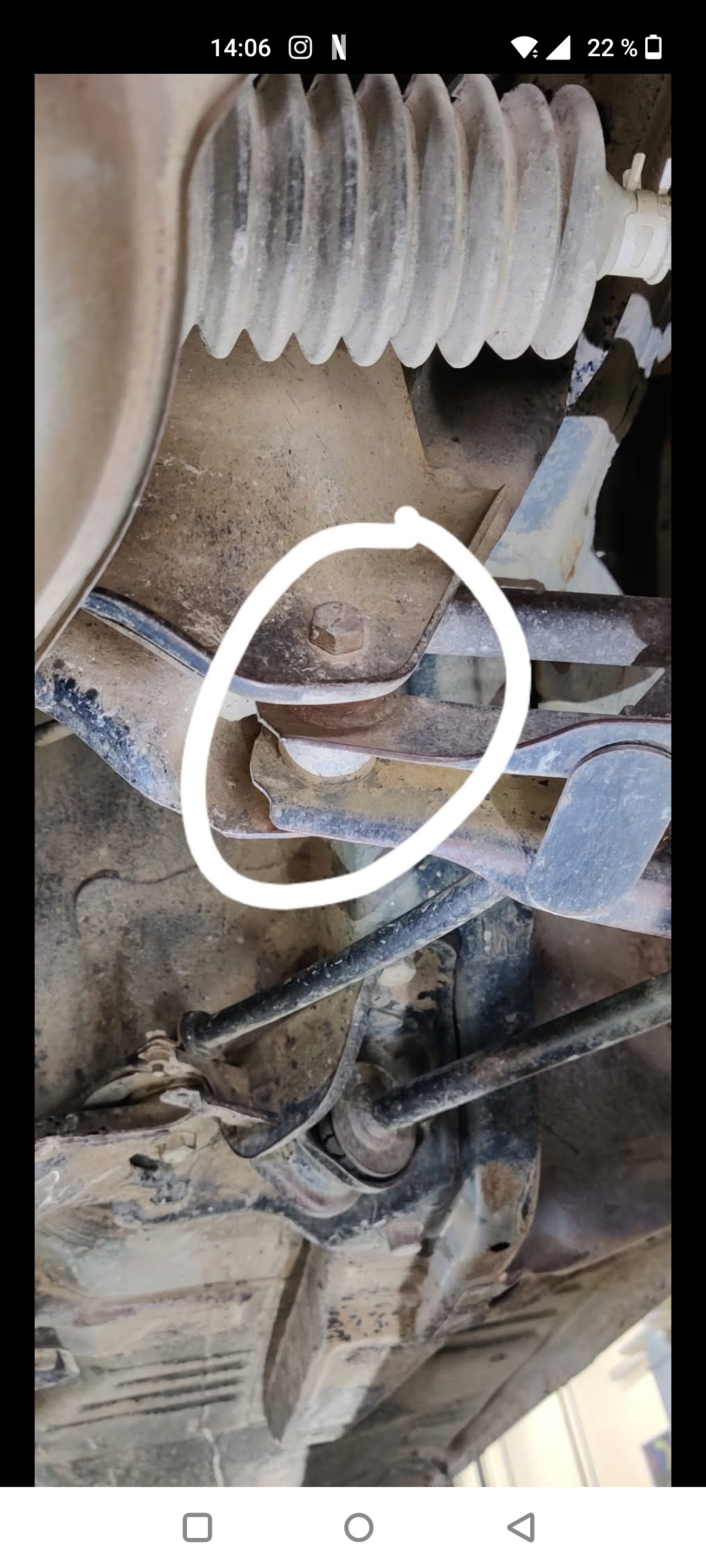

Hello i have a Legacy 3.0 2007 saloon wich pulling to right. Before the first wheel alinment the steeringwheel was as it should be but when i let it go the steeringwheel pointed about 5° to the right and the car goes at the same direction. Had a wheel alignment but there was not much to do because the rear link adjuster was rusted. Well i changed it with new bushings and bolts and new strutst and shocks back. At the front i replaced all the bushings at the transverse link, new front stabilizer and new bushing stabilizer. Had a new wheel alignment but still no good. Now the steeringwheel points 5° to the left when i drive straigh. And if i centerd the steeringwheeel the car goes to right. this is the wheel alignment specs in Swedish. Vanster=Left Hoger=Right
