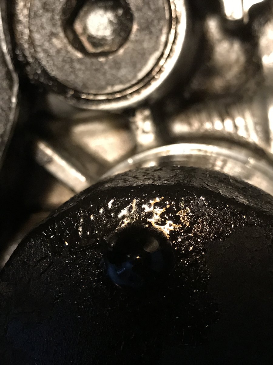

  21. Here's a pic that shows the headgasket area and front cover a little better. I do see a bit of oiliness on the bottom of the front cover although it doesn't seem very heavy.
  22. It’s a brand new filter and one one did the same thing. I’d see a bit of oily residue under the timing cover so a leaking seal is a possibility. A complete timing belt job is due, so aId rather it be that than headgaskets.
