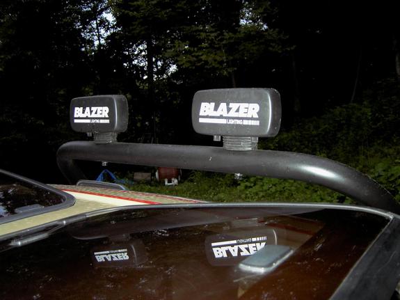

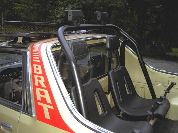

here are mine, not as impressive as some of the others, but they look nice P.S. you would need a rollbar to mount yours like I did, and a Brat
