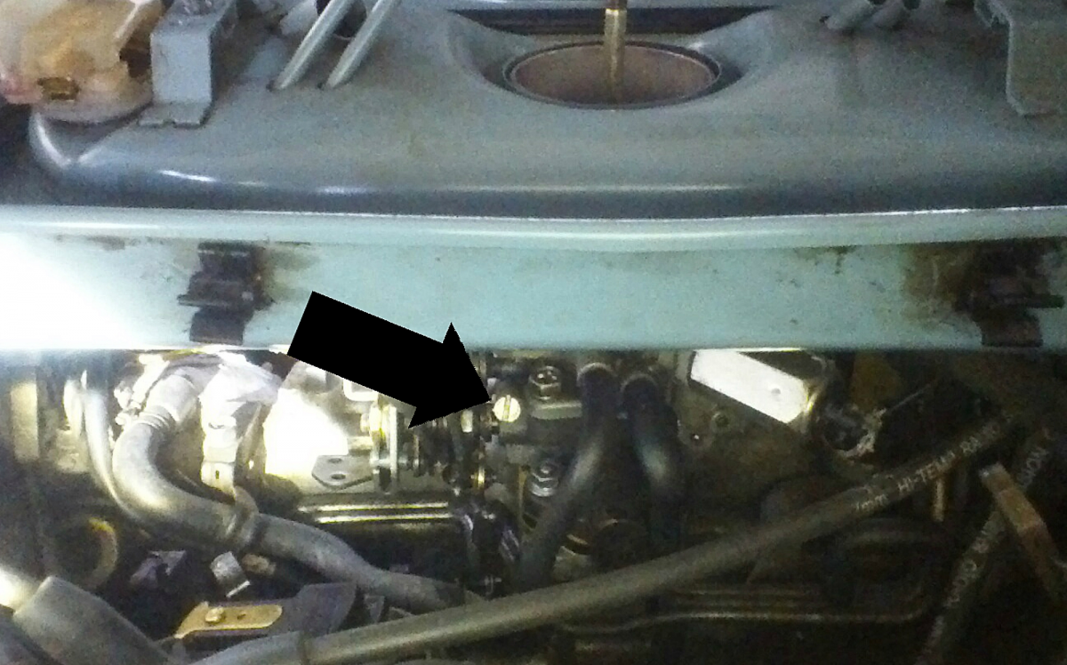

High Idle and Overheating Problem
Sapper 157 replied to benjamachine's topic in Old Gen.: 80's GL/DL/XT/Loyales...
Sorry if took me so long to upload this. Hopefully you have fixed the problem by now but in case you haven't here is the pic. -
