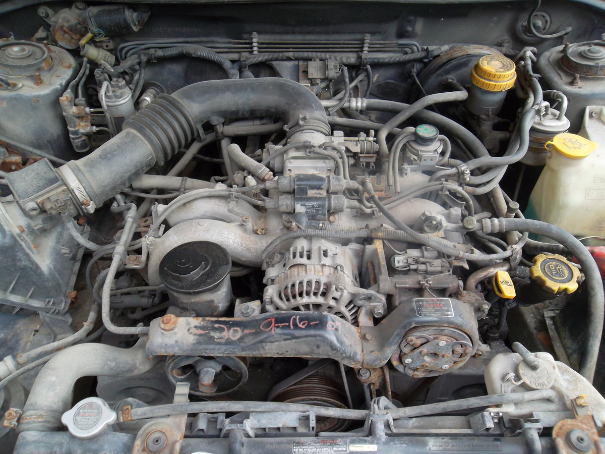

cold start problems 95 imprezza

scdrtramp replied to scdrtramp's topic in 1990 to Present Legacy, Impreza, Outback, Forester, Baja, WRX&WrxSTI, SVXthis pic is my original cars throttle body

scdrtramp replied to scdrtramp's topic in 1990 to Present Legacy, Impreza, Outback, Forester, Baja, WRX&WrxSTI, SVXno It's never smelled flooded. these cars don't have a fuel pressure test port do they?? since it starts so quick with start fluid I'm thinking it's starving. it's getting 25 mpg and plugs look like it's burning good. I'm going to take a couple pics to show how different the two engines are.- cold start problems 95 imprezza
scdrtramp replied to scdrtramp's topic in 1990 to Present Legacy, Impreza, Outback, Forester, Baja, WRX&WrxSTI, SVXwith a shot if start fluid it will start right up. Also as I said I have two cars. Both are '95 imprezza outbacks. one runs great and is an automatic, but has serious rust issues. The one with the start problem is a 5 spd. both are 2.2's. The thing is the throttle bodies are completely different. The 5 spd car has some sort of speed control deal on top of the TB, the automatic has none of it. is whats on top of the TB the IACV??- cold start problems 95 imprezza
scdrtramp replied to scdrtramp's topic in 1990 to Present Legacy, Impreza, Outback, Forester, Baja, WRX&WrxSTI, SVXThanks for the replies. I replaced the temp sensor with no change. Today I cycled the switch like Lucky Texan suggested, still wouldn't start. It does eventually start, but it takes many times of cranking , and cycling it off. When it does start it is barly running about 4 or 500 rpm. It dies if I hit the throttle. If I just let it run like that for about a minute or min and a half it will smooth out and sit and idle at about 1g till it warms up. Drives good at that point. I have two cars and have changed the maf, coil, wires plugs, all new. temp sensor new, I was going to swap pumps, but they are different. one car has three lines, and the other has two. I'm stumped.- cold start problems 95 imprezza
