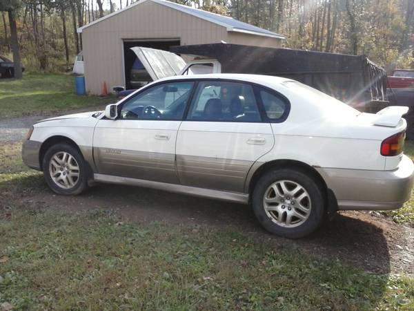

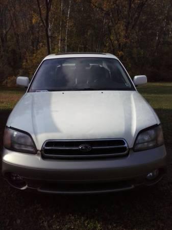

  10. Hey, joined the forum when I was thinking of purchasing an old Subaru for winter and was concerned about the enagagment delay in drive. Got that all cleared up and followed what I was told by adding Trans-X last night and so far so good. But yeah I'm from PA purchased a 2000 Legacy Outback Limited, its in pretty descent shape for its age, there is a smalll rust spot right behind the back door on both the driver and passenger side above the gold. I know y'all have seen Subarus before but here's what I picked up.....
