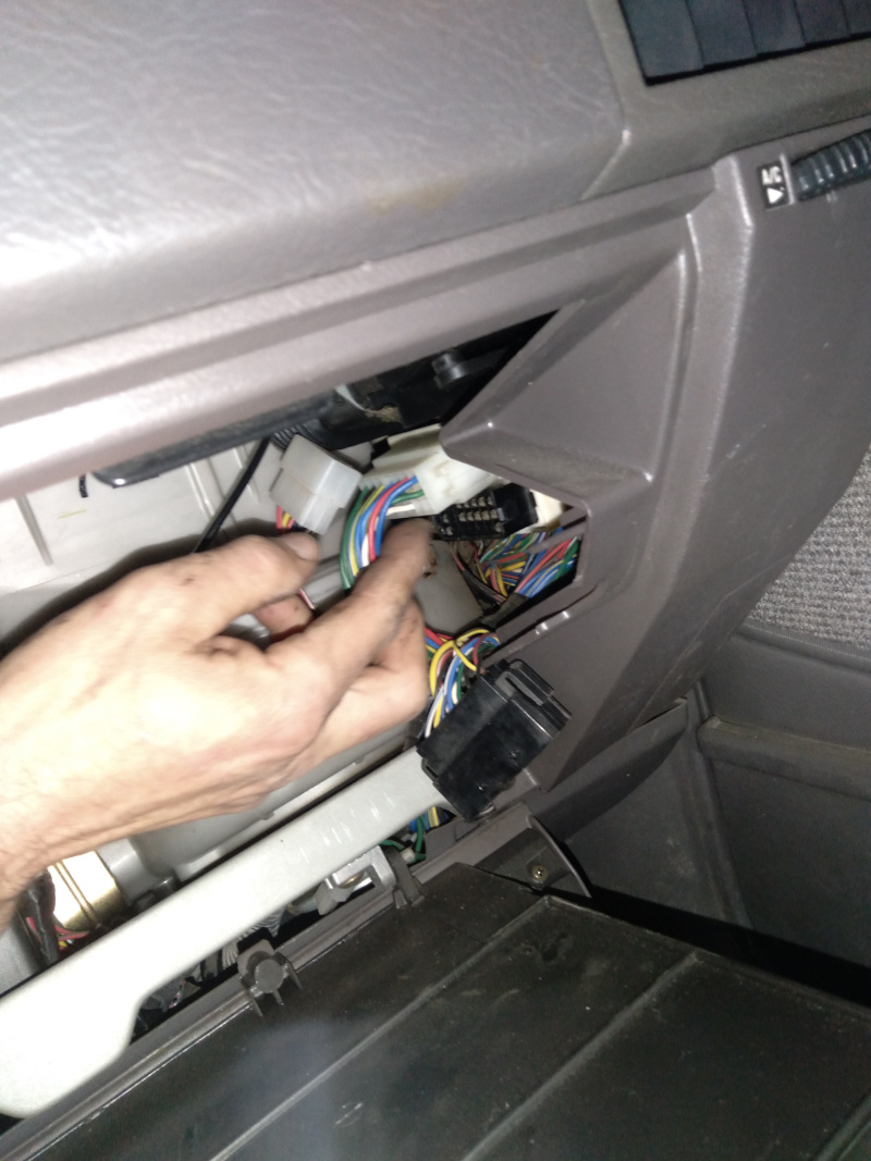

  1. It turns out it was the seatbelt controller unit, not the ECU, which on my 19 loyal wagon is in the back, behind the drivers side cargo panel. I never would have found it if it were not for a faint clicking sound when i was messing with the wiring pictured above. I removed it (and replaced the fuel pump with an 87 F-150 pump) and it seems to be running fine now, except the seat belts are mildly annoyingly static, which honestly i don't mind, but i do imagine selling the car one day and would like to have the belts working as intended. Which brings me to the question of where can i find a replacement seatbelt controller that actually fits?

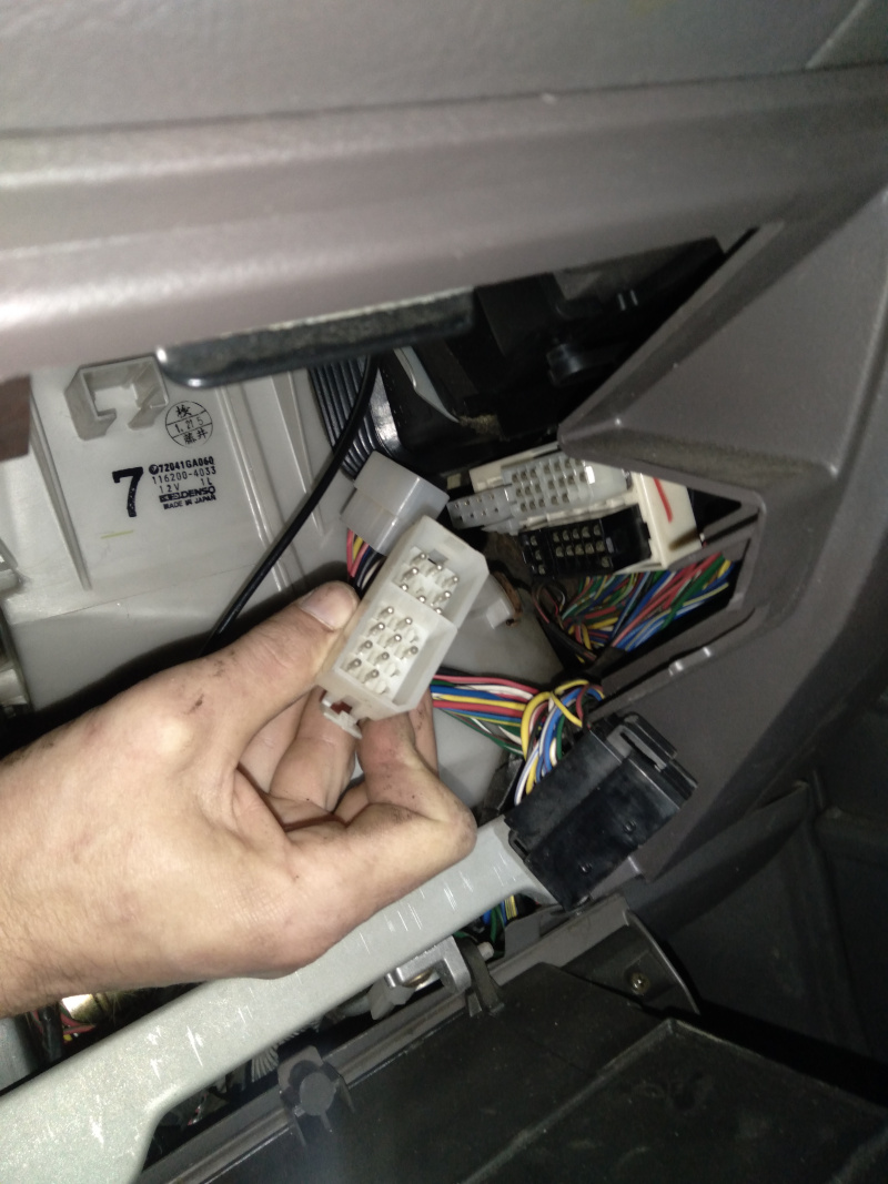

  2. After several hours of unplugging all the plugs i could find, i finally unplugged this one and the parasitic draw dropped to zero Any idea what it is? Next step would be to test the pins, but I have to know what they're supposed to be before I can make any meaning out of it
