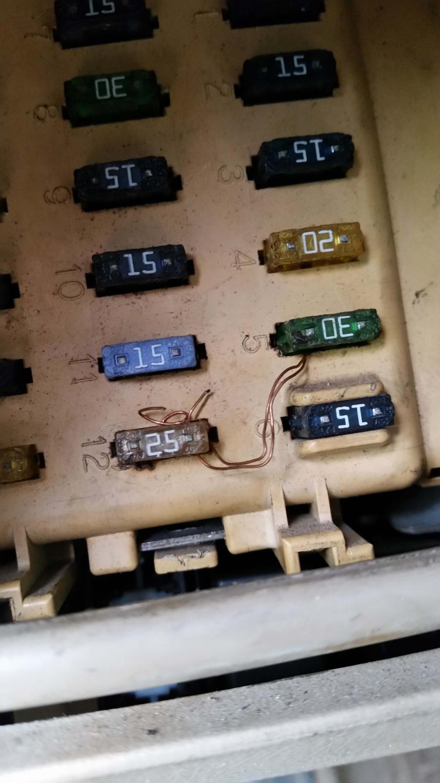

After a lot of time and struggling to follow subaru diagrams, I found that the park light switch was not providing continuity on its normally closed circuit. I jumped it and all taillights work now. Now its time to figure out what the previous owner did with the airbag circuits
03 Outback Electrical issues
I have found a link to the JDM FSM. Not sure if i need the USDM instead. previous owner cut some corners. He had overfused the illumination and used it to feed the taillight clearance circuit, which shows no voltage. When i measure voltage on illumination fuse with lights off, I get 2.5v. On headlight fuses, I get 1.5 with lights off. there is a wire run through the firewall to the back of the fuse box, but i think i need to pull the wheel and fender liner to see where it goes...
