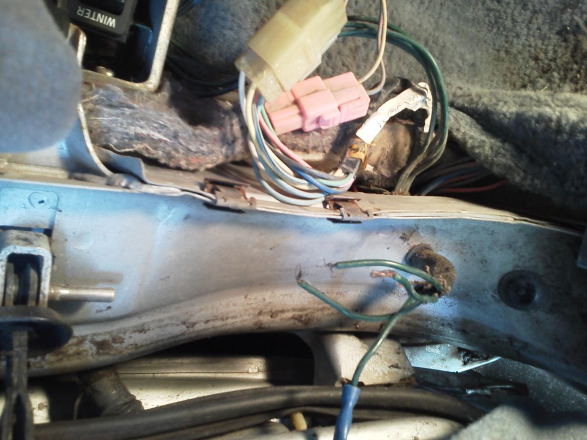

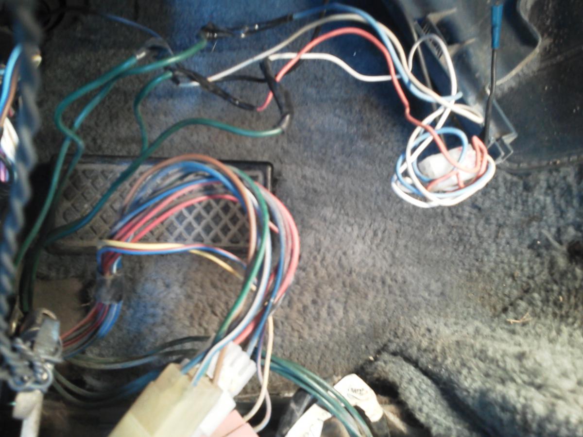

Can you be more specific as to the location of the wires on the passenger side. We also are trying to track down faulty window wiring Thanks -
power window/door wiring help
Kbsubie replied to Kbsubie's topic in Old Gen.: 80's GL/DL/XT/Loyales...

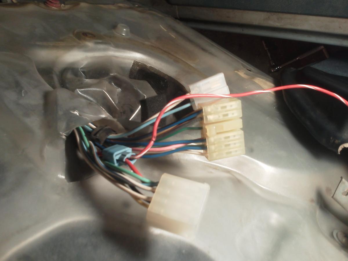

the plug on the left has power coming in on a red wire, they tapped in with the red white wire the plug in the middle has power at a blue/black wire was the green to light supplying ground? i have not found an empty plug, yet -
86 gl mpfi ea82 previous owner apparently needed the wiring to do something instead of figuring out what was wrong... would love to get this rewired appropriately the four green wires end up here with only one connected to a light blue wire coming back into the car the divers side window functions well which is fine but we've got all winter to get this redone so far have not found the wires coming from the inside that go out the door thanks!

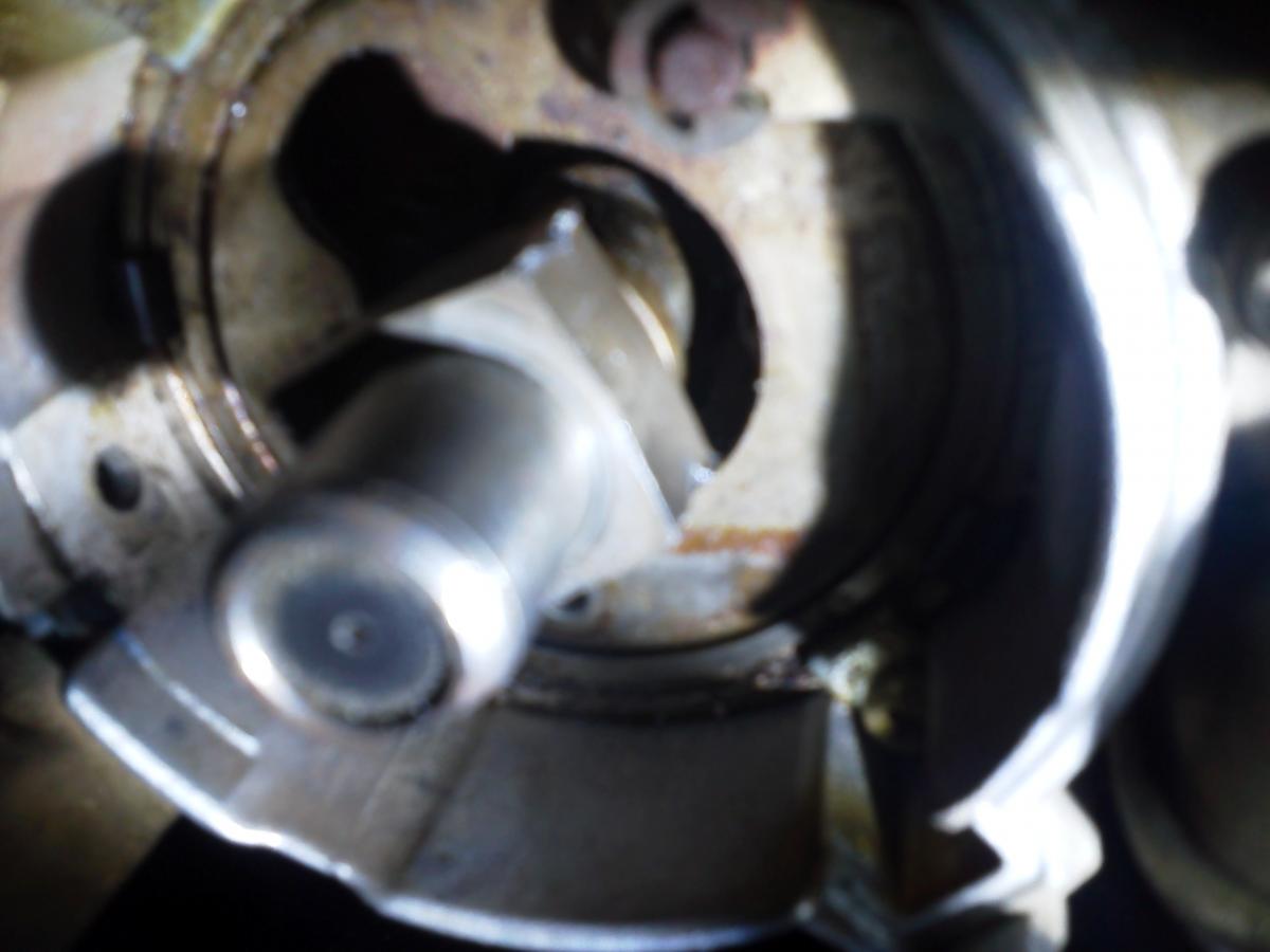

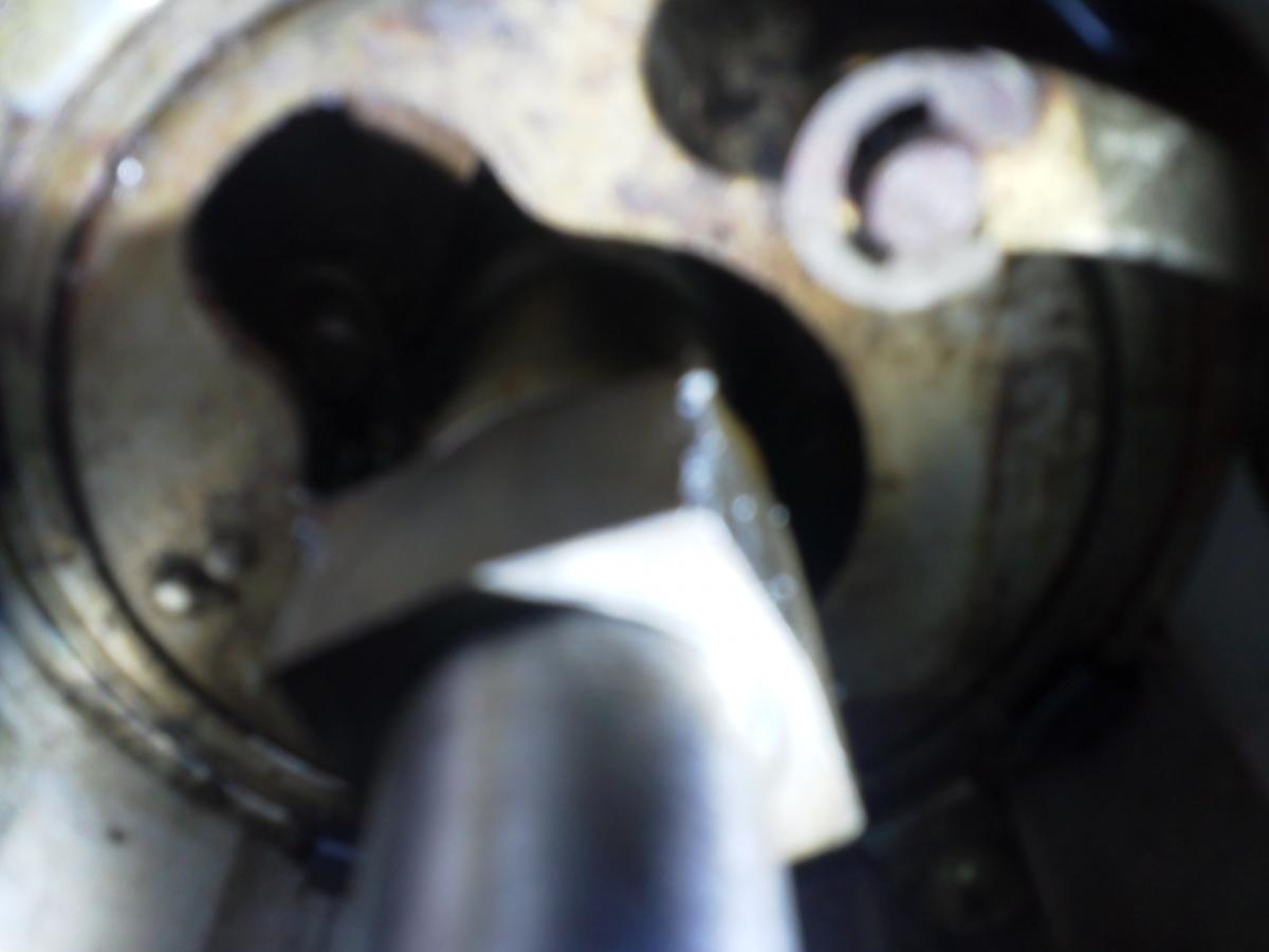

Even wth the gouges off the distributor we were able to set the gap appropriately adjust the timing and .... It runs!!! Hopefully it will keep goin. At some point the pickup coil was making contact causing some significant metal work. Is it ok to even the edges off and re adjust the gap should this run only temporarily? Thanks everyone for the help!

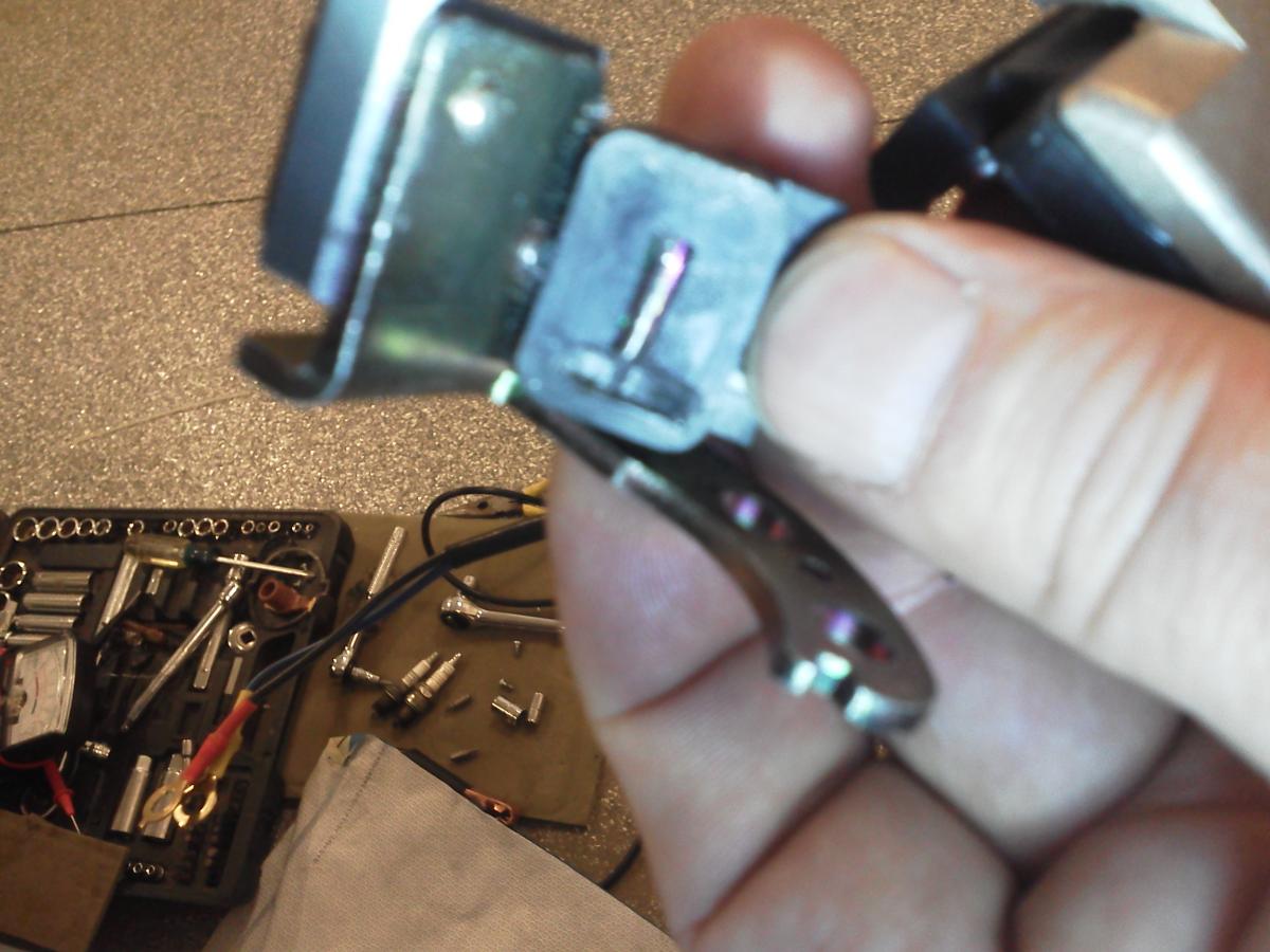

well could this be THE problem or is it a separate bad problem while replacing the ignition control module we noticed some metal shavings stuck to the pickup coil the distributor shaft corners are gouged/filed off!!! was the pickup coil the wrong part or did the distributor shaft wobble??
Replaced the module, but had to pull the distributor to get at the bolts due to stripped grooves Was difficult to tell with the test light if the module was bad. had pulsing light not flashing on/off as we were anticipating and was different if we wired the test light directly or took the wire to the module off the coil Have not had time to readjust the timing and check for spark. Will also redo grounds again Thanks again Happy New Year!!
