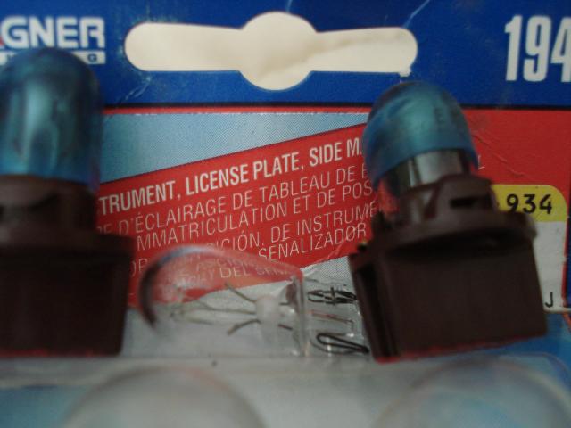

  9. 02 legacy GT Have speedometer cluster semi-apart to change bulbs that illuminate gas gauge,speedo tach etc (one is out...figure I'll change all) Take a look at the pic...aside from the blue condom slipped over the bulb, they look like a standard bulb (these were used in the front subaru corner parking lites in older models) OR...are these something special??? Please, no guesses...I don't want to take the dash apart again thanks
