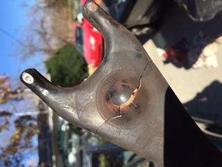

  2. I'd be willing to bet that this was the original fork @ 200k. It is good steel, If I bounce it off the tile in the stove room, I could tune the guitars to it.
  3. In retrospect I think I was just bitter because the same year Forester fork is $20, and mine is $40. Pouting.
  4. The fork in my OBS broke across the pivot cup in typical fashion- from east to west, right across the center of the cup. I ordered a new one from subarupartsandaccessories.com, and it was $40. This price figure has me contemplating welding up the old one to keep as a spare. Anyone had any success running a welded one? I very much understand the implications of a shattered clutch fork imposing itself upon an unreceptive rotating clutch assembly, I'm just speculating. I'm a good welder, and I know better ones. It's early here, fog of morning may be impeding rational thought.

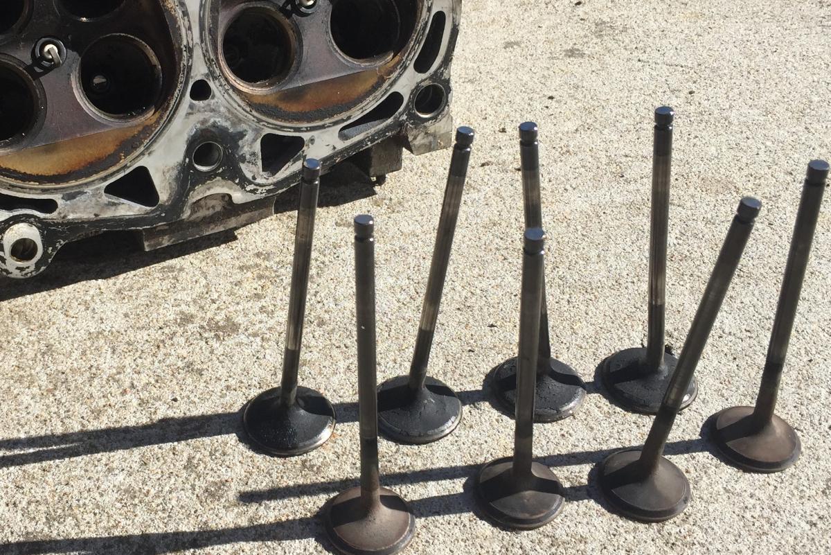

  7. FWIW.... eight of the victims. Seized water pump smoked it. Brush your teeth, take your vitamins and do your scheduled maintenance, folks.

  10. Bump from the dead, learned alot since I posted this. Pulled the engine, and the heads off the EJ253 from Forester, they are headed into KC tomorrow to be rebuilt. 16 OF 16 VALVES WERE BENT!!! I couldn't believe it. Cams will probably be sent to Delta, seems like about the best bang for the buck. I'd sure like to put the 253 into the OBS, seeing that it has 31hp, stock, over the EJ222 thats in it now. If this doesn't end up working out as expected, then the 253 will just have to go back in the Forester. I understand the swap is pretty straightforward, if you're using the intake/sensors/cam and crank pulleys from the EJ222. Still searching the forums currently, hoping to find someone that may have done this specific swap, but I'm about to just tear into it. I think with exhaust and a mild grind I should be able to see close to 200hp at the crank. Not bad for under $1000 (that figure includes the acquisition of the complete Forester) and in the little wagon it'd be a blast. I've spent the last year rebuilding everything else on the car, so as winter comes on, and my work slows, I need something to keep me busy. This is it. Any advice or criticism welcome, if I'm missing something or not seeing something, chime in. Will keep updated.

  13. This sensor has been cracked since I bought the car 6 months and 15k ago, and I've been doing this for probably 4 months. I also have a cracked one on the '99 Forester I have used the same method on, until the water pump gave up and she bent SIXTEEN valves. As long as I don't smash through any lagoons they remain functional.
