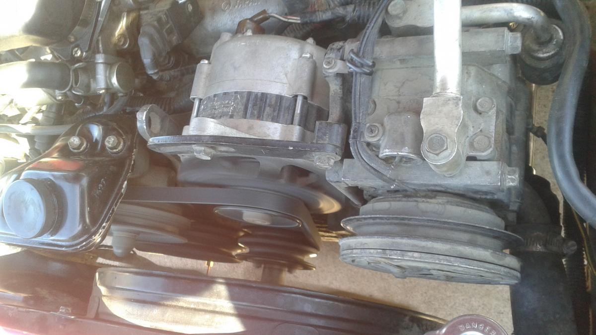

good call on the string technique.I'll brave the local napa again and hope to find one..that adjustment bracket is for the alternator only..unfortunately..sorry for the crappy pic..thanks guys!! -
when i got this 1989 gl ea82 wagon with dealer installed outboard a/c...the prior owner had no belt on it..i have ordered two different sizes...(napa #17480 and autozone #17450) one is about 45.25'' (WAY too tight...other is close to 48''...WAY too long...but slips on...)for the life of me i cant seem to find any adjustment idler or anything on the pump itself.. anybody know? or am i possibly missing an adjuster of some sort? pump seems to be mounted solid...thanks in advance! appreciate the help and patience with this newb...ima learning!

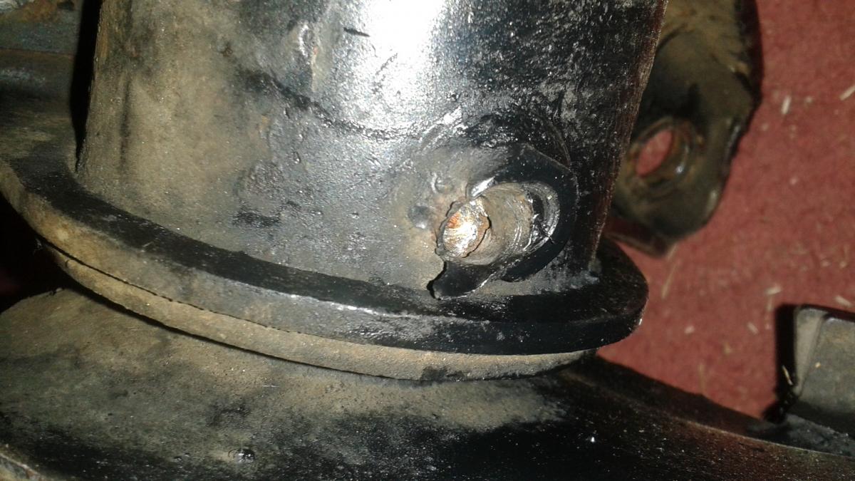

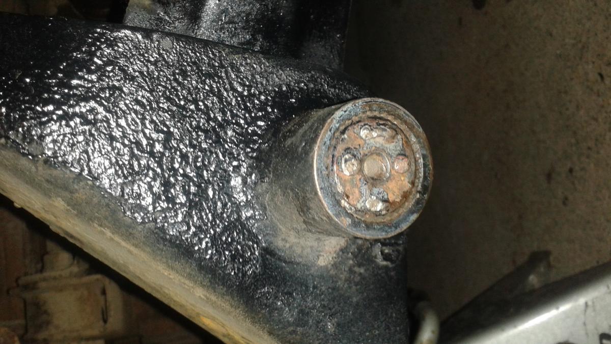

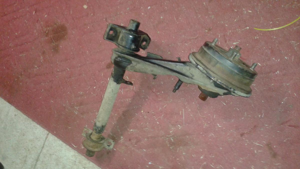

how do i "clock" my rear end?
junker605 replied to junker605's topic in Historic Subaru Forum: 50's thru 70's
woops..ima idiot..pretty sure staring at it long enough i figured it out..confusing part was the drilled out 12mm bolt..but hopefully i get it fixed tomorrow..thanks guys..feel free to delete original post..my bad.. -
yes..I'm a confused newbie to gen 1 brats! but I'm at a loss on how i go about getting them "clocked" back to ORIGINAL height! ugh..i see a spot where it was drilled out..? i just pulled the entire assembly off to see if i can somehow save them..anybody have advice? special tools needed? just hoping to get them back to ORIGINAL..they have been lowered bout as far as i can see possible.. (were riding on bump stops)..ANY help beyond greatly appreciated!

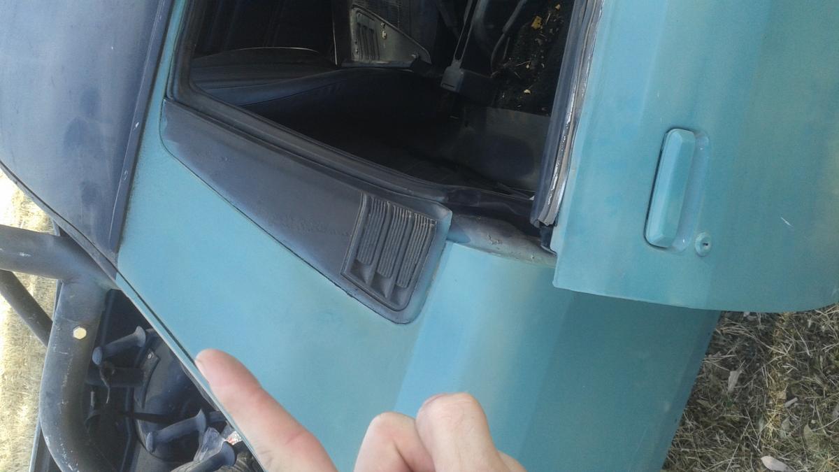

removing plastic pieces behind windows?
problem solved! for ANYONE down the road wondering..good luck NOT breaking at least one of the three clips holding each one on! i used a long flat blade screwdriver..they are held on by what's similar to door clips on panels..ugh..thanks guys! now onto more prep for paint! -
i did that hoping i would see something inside..but nothing? im afraid to try and pry them off..unless I'm missing something obvious..thanks guys
