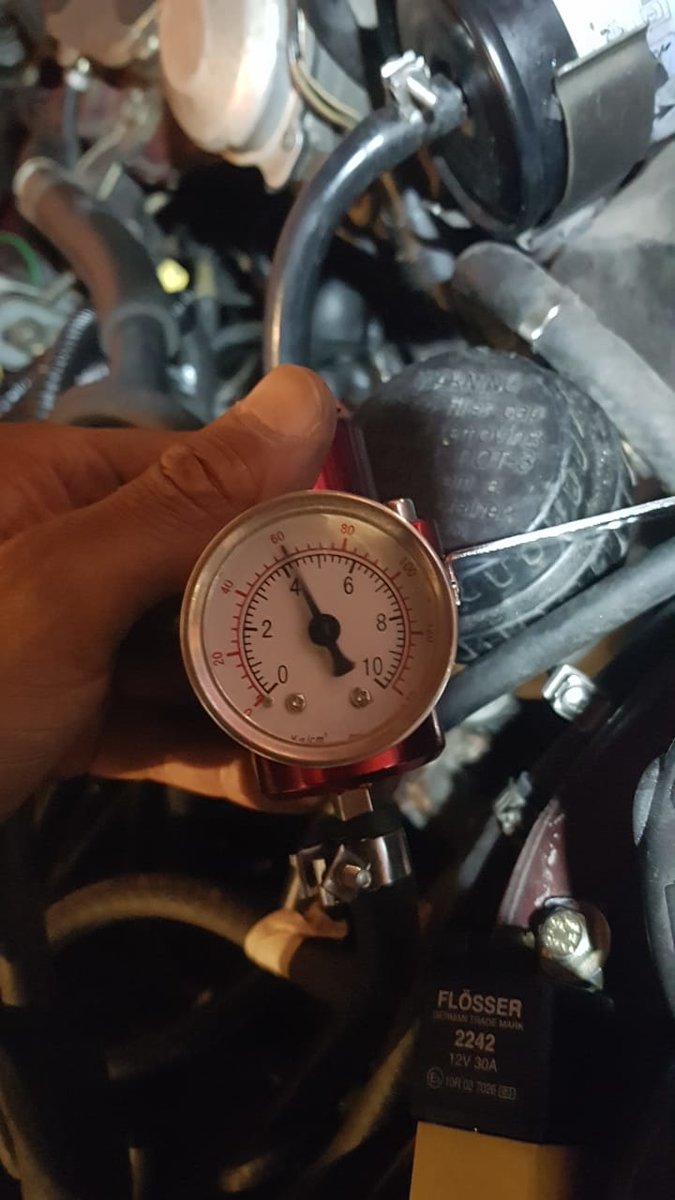

  2. @1 Lucky Texan @idosubaru I have replaced the fuel pressure regulator with an aftermarket one with a gauge. I set it to (+/-) 65 psi based on the FSM that indicates a "discharge pressure of 61-71 psi" for a MPFI. I noticed some sort of improvement, but marginally. At one point only I stepped on the gas and it launched forward nicely. Then I went for a longer ride and again it stumbled. My foot is down on the pedal, but the car is showing 500 rpm or less. But it doesnt die, it doesnt fall back. Then it picks up again and it goes forward. Like a WAVE. Which is why I suspected the fuel pressure regulator failing to maintain the fuel demands, or even the fuel pump unable to meet the requirements. Both are new now. And the problem remains. I have canceled the appointment for the yearly inspection as I dont think it will drive steadily. Ill try @1 Lucky Texan method of squirting some starting fluid through the air duct tomorrow I tend to think now about the MAF, whether it is faulty somehow. But the thing is, at idle it remains totally steady, no surging, no waves of up and down idling, it doesnt die.I have to MAFs no changes when interchanging them. Transmission wise..ATF is fine and I hear the gearbox working, changing gears, kicking down, downshifting.. (Just in case, reaching out for a mechanic is just out of the question) No money for that and even worse, no qualified mechanic that knows about this particular type of EA82. Again, I wish it was an SPFI or carbureted. I had both types before. It was a start up and drive-away affair. This one is a "start-up (if it does) and see what's wrong now"

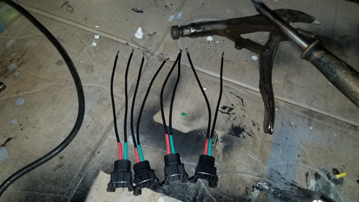

  14. Happy holidays to you all! @idosubaru @john in KY @DaveT @el_freddo @naru2 This is where I am now : I fixed the alternator's wiring by adding the line labeled "S" that stands for "voltage sense" this was cut and left on the side. I reattached the wires I had cut suspecting they were shorted. These wires were all fine all along. I prepared 4 new injector harnesses by cutting the old ones and soldering the new ones then using heat shrink on their solder joints. I fired it up. It started. But with a clanking noise, I let it run for a good 10 minutes. And then I noticed it smoothed out, at first it was like a wave, it would run ckanky then I would hear the typical EA82 purring. In the end it really seem it got a lot better. I noticed injector #4 still leaks fuel, but at a lower rate. When putting a long screw driver it sounded as if that injector 4 was clicking. The computer (damaged after a short when attempting to find the injector pulses) works good enough to run the ignition and distribution and in fact, it gave me code 42. Very clear 4 long pulses and 2 quick ones. Reading about it, it is related to "Injector" stuck open or closed. Which makes all the sense considering all the issues with injector 4. Perhaps that injector is faulty despite thought of being fine otherwise. However, reading on USBM, someone mentioned that code 42 refers to "Idle Switch" this would be consistent with the car's behaviour now. After the auxiliary air valve was released of keeping the idle still, the car couldn't maintain an idle any longer. The suspicion now is that the pin in the ECU that controls the iddle switch is fried. (Most expected) With all this, I'm calling it a massive improvement! The next actions include an oil and filter change, a swap and test of the injector #4. Waiting for the new ECU that is on its way. And fixing the relays for the radiator fans. Yes, I eliminated the fan clutch and placed 2 radiator fans. However I need a separate relay for the now main fan. It drags too much current for the current auxiliary radiator fan. I'll keep the updates coming

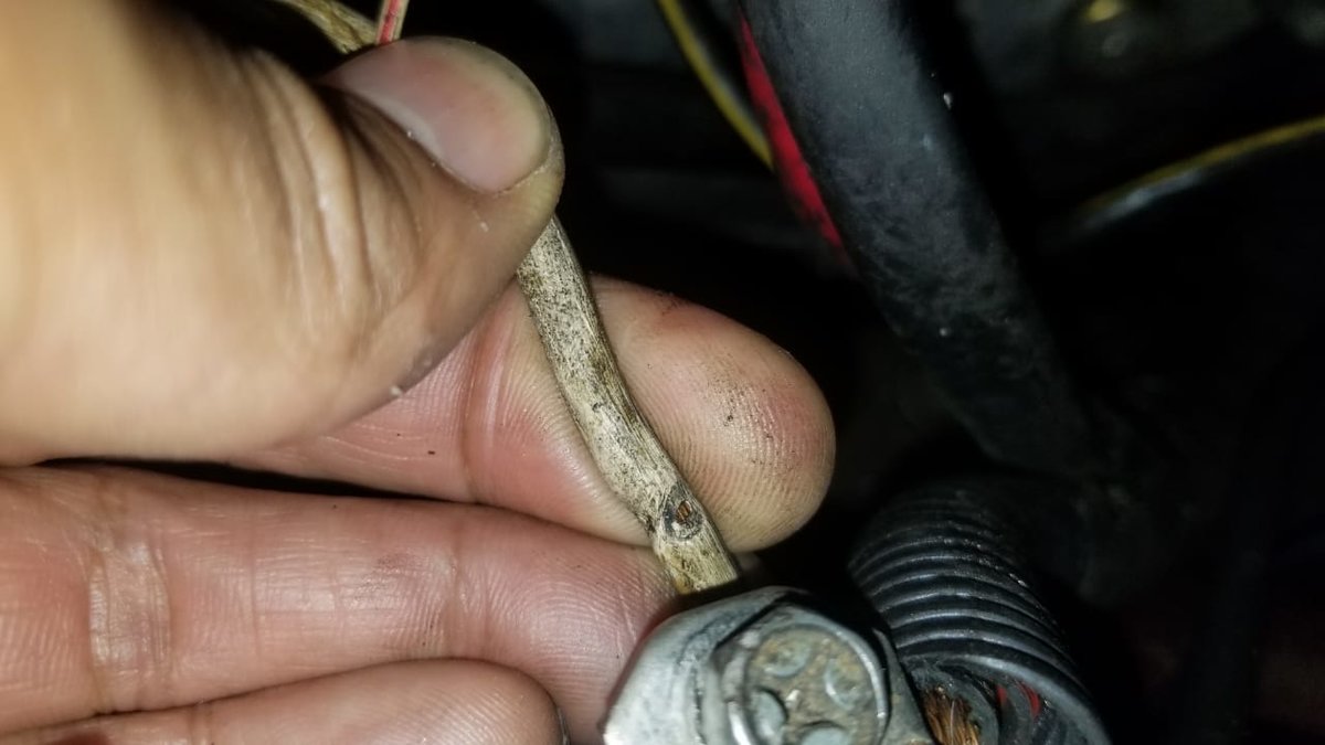

  15. The rubbed / torn wire is position "A" from the alternator to fusible link #4 (1.25). And it was strangled by position "L" that heads to the "Charge" indicator on the digital meter out of the alternator. Might not be a culprit but for sure does not look good. I found wire "S" that heads to fusible link #2 (0.85) from the alternator is disconnected. I will fix the connector properly the next time I have a chance.

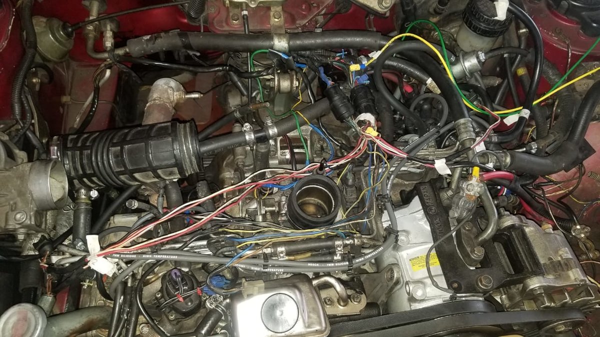

  16. This is where I am at the moment. @john in KY @el_freddo @DaveT @idosubaru Checking all wires in the engine bay. I found a torn exposed wire related to the alternator and a couple of "orphan" wires. At one point the car blew the fusible link perhaps associated to the starter or the alternator. So the fault could be there. Even the alternator could be the culprit, it could be shorted somehow now that I think about it. The injector harnesses look fine although I will put new harnesses and verify that they aren't shorting each other afterwards.
