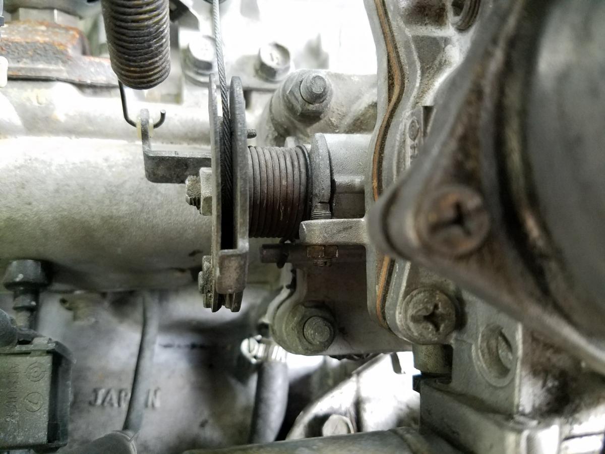

I have been trying to fix my idle issue for a very long time. The engine was rebuilt before I bought the car and it's still pretty fresh. Can anyone take a picture of their throttle plate stop screw? I am worried that someone has adjusted mine. I am also wondering if the TPS is set correctly. I messed with the today. Didn't seem to help anything I have checked all the vacuum lines a million times

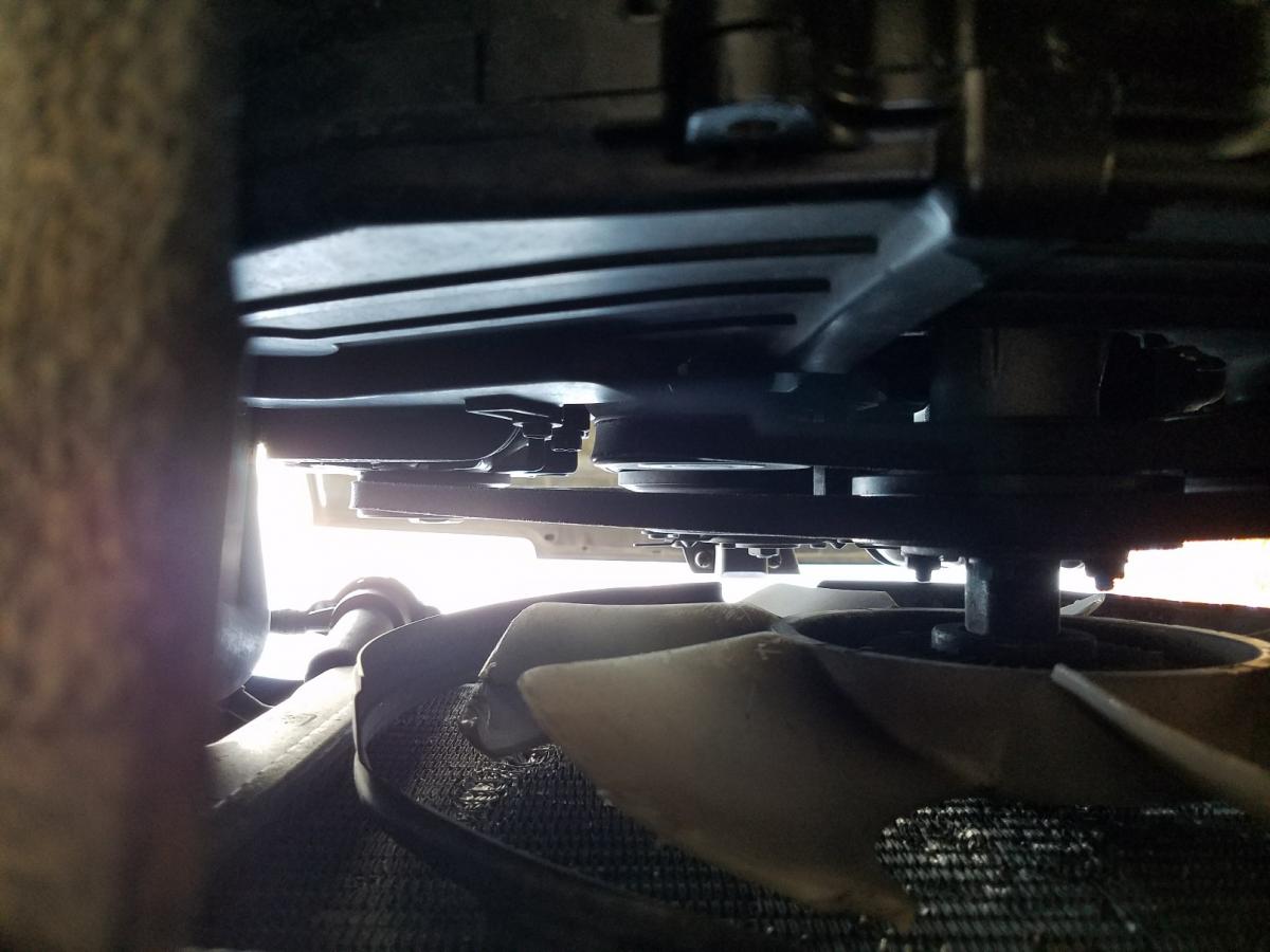

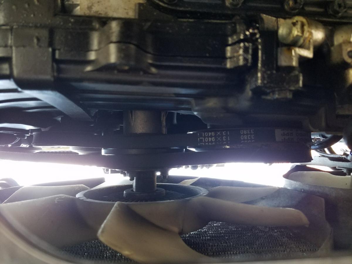

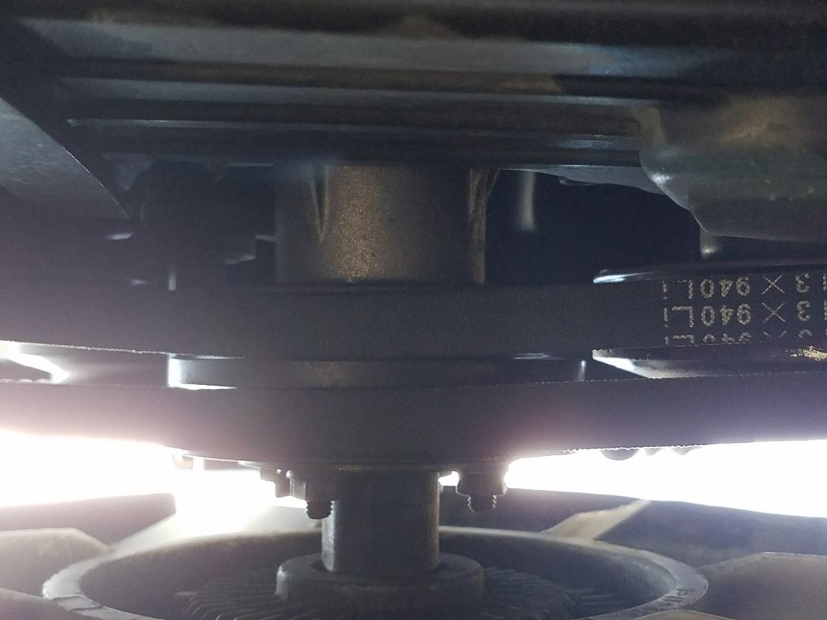

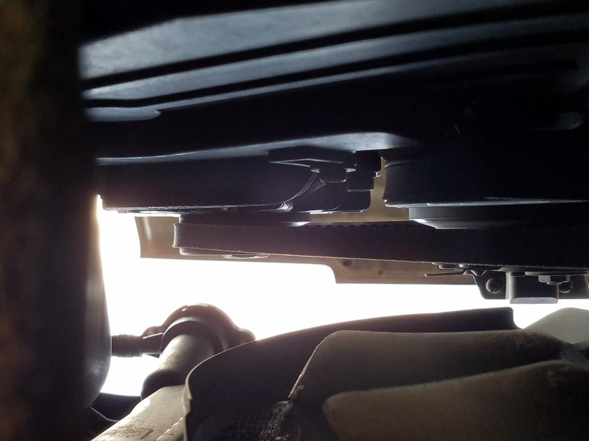

I will check the pulley tomorrow. I've been meaning to swap the fan for an electronic one anyway... Most likely I will take full dimensions of the pulley with calipers so we can put that info on the forum for others who have this issue. I definitely need to upgrade my Alternator! I just replaced it with a new one, and it's still not cutting it for what I want to do. -

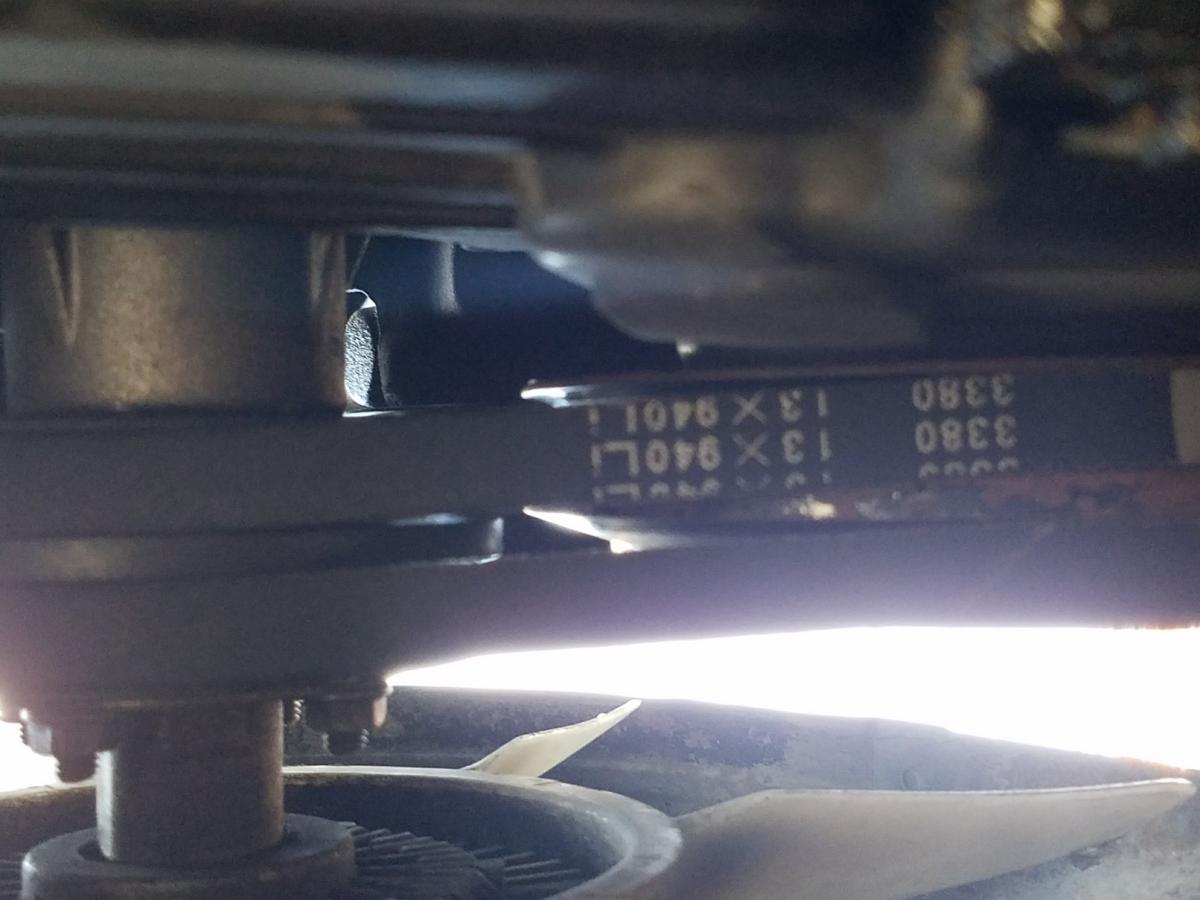

Wow thanks for the info! I knew it be something weird liked that. My car has AC, so I bet I have the longer pump with a pulley from a non AC car... its gonna be fun trying to find this pulley... ha or could i have a non AC engine in my AC car? oh my -
I was thinking maybe the bearing in my idler/tensioner pulley was going bad because its noisy, and I noticed that my water pump seems to be sticking out too far.... Look at the pictures. You can see what I am talking about. Maybe this is causing stress on the pulley making the bearings go bad. The engine as rebuilt last year before I purchased the cat

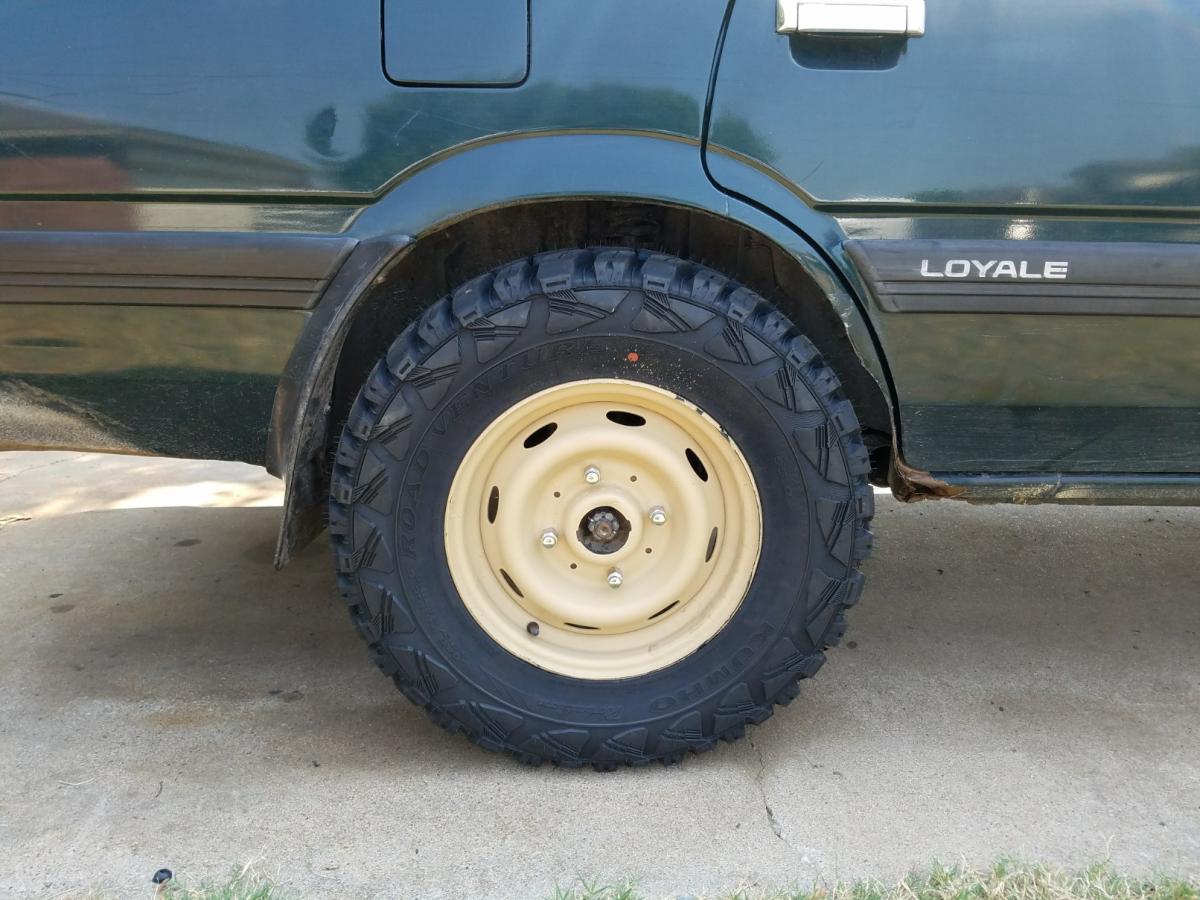

Updated picture with the new tires and wheels. 2 Inch lift in front. No lift in rear. Some trimming done. Waiting for my 4inch lift before I trim anymore -

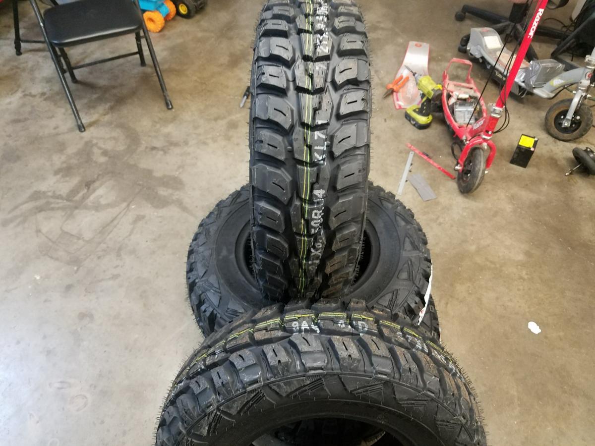

Tires just came in! Check out these beasts! One of my 14inch Peugeot wheels is beyond repair so I cant use the tires until I find one more wheel! I need a 14inch steel wheel. Not the spare. -
