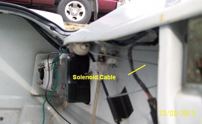

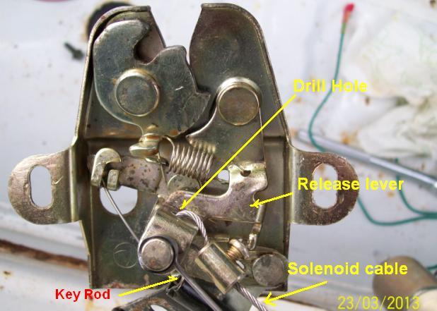

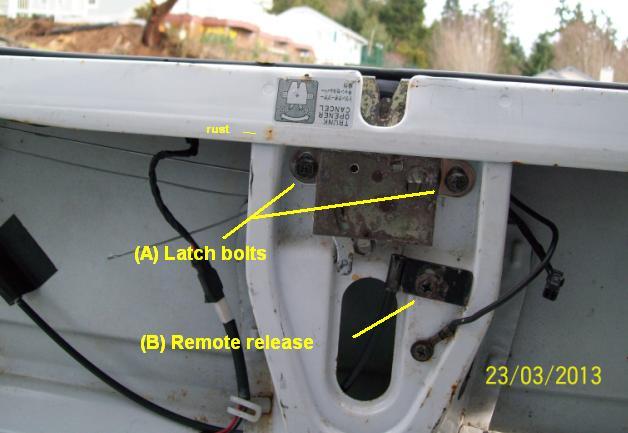

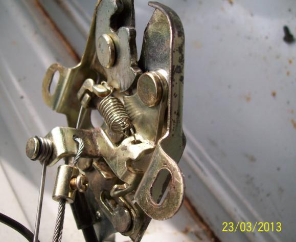

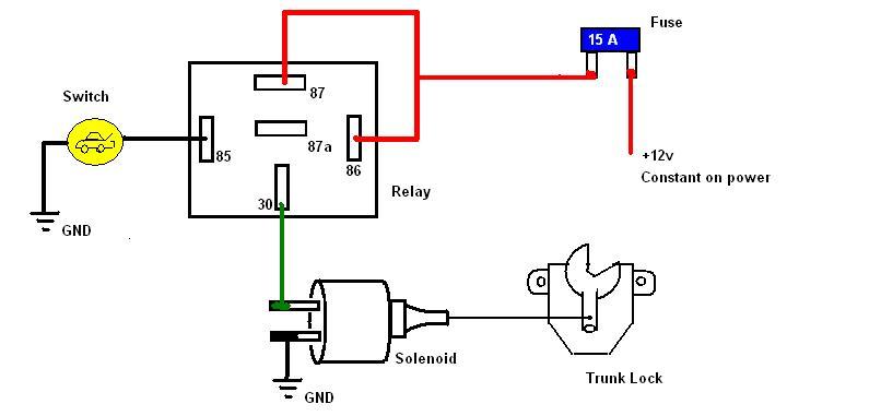

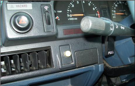

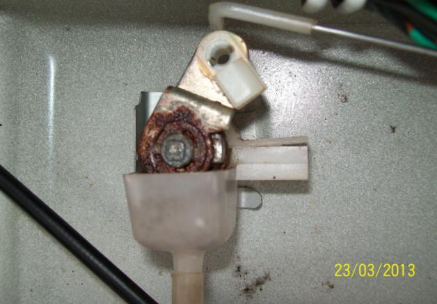

My Loyale sedan model didn't come with an automatic trunk release. Oh sure I have the lever on the driver side. But that is still a cable manually releasing the trunk lock. After having added the LED trunk lights to my Loyale sedan, I decided I wanted to do something more. Then I came across an offer on Amazon for a trunk pop solenoid kit for less than $15 and figured why not? It will make a nice addition to the car and if at a later date I decide I want to add keyless entry, they usually have a function for popping the trunk. If I decide to go that route, this trunk pop project will already be done. Adding a trunk pop solenoid is a fairly easy job. Basically you have a solenoid with a cable that is connected to the latch that opens the trunk. When a button is pressed, a current passes through the solenoid and it pulls on a plunger, much like a doorbell mechanism however instead of pushing something forward, the trunk pop solenoid pulls a cable that trips the trunk release mechanism. I chose the Directed Electronic 522T trunk release solenoid kit. It comes with the solenoid, wires, fuse and a yellow button with a trunk symbol molded into it. The image below shows all you get: If you think at some point you might want to add a keyless entry system and wire in a trunk pop function, you will also need a relay so that you can have a control signal rather than a drive signal. Most keyless entry systems will offer an output of 250ma (milliamps) maximum. This is not enough current to drive the solenoid that pops the trunk. Therefore, a relay is needed to control the solenoid circuit. This is the option I chose. Mounting the solenoid Although there are brackets that come with the 522T kit, you don't really need them. Why drill holes in your car if you can avoid it? The solenoid itself is the right size to tuck in between the lip of the trunk and the right brake light housing. The advantage here is that while it is snug, it is also easily removable for servicing. The picture below shows the solenoid in position: Connecting The Cable The next thing needed is to connect the cable coming out of the solenoid to the trunk lock release latch. I found it easiest to follow the trunk key rod to where it attaches to the trunk lock mechanism and connect the cable there. This means drilling a hole in the release lever and threading the cable through and securing the loop with the cable lock screw that came with the kit. The steps are shown below: Start at the trunk lock rod just behind the keyhole. Rotate the retainter clip down so the rod can be released. Remove the rod from the key hole lever. Now undo the two bolts (A) holding the latch inside the trunk as shown below. Also, you will need to remove the bolt ( holding the trunk release cable: You can now remove the latch mechanism from the mount. Disconnect the release cable and slide the key lock connecting rod out through the mount along with the complete latch assembly. While it is out of the car, clean and lubricate the mechanism for optimum performance. You will need to drill a hole in the release lever that the key rod is connected to so the solenoid can move the lever in the same manner as the key. Then thread the solenoid cable through the latch mount and through the hole and secure with the cable clamp as shown below: Secure the latch back into the mount by threading the key connector rod through the mount and to the key turn mechanism as it was originally. Connect the release cable to the latch and secure the latch using the two bolts removed earlier. Be sure to position the latch in the same vertical spot as it was when you took it out. If the latch is sitting too low, it won't catch the striker bar when the trunk is slammed shut. Connect the key rod and test the trunk by closing the lid and opening with the key. If the trunk won't close, the latch is too low. Loosen the two bolts and slide the latch up a bit and retest the closing. Now tighten the cable release holder. Go to the front and test that it works as before. Adjust if necessary. Make ssure these work properly before proceeding. Initial test of the Solenoid Testing often and early is the best way to ensure each step of the installation has been successful. Attach the spade connector of the green wire from the kit to one of the solenoid terminals. Attach the black wire spade connector to ther other terminal of the solenoid. Tuck the solenoid between the brake light housing and the trunk lip as discussed earlier. If the cable to the latch is taught (e.g. no slack), you need to unmount the latch and adjust the cable clamp to allow some slack. If you can, add slack merely by sliding the solenoid forward a bit without making is so loose it will fall out, then do that instead. It is important that there be some slack for the solenoid to be able to gain enough momentum to trip the lock. Using a battery charger, connect the green wire to the positive. Now touch the black wire to the negative clamp of the charger with it set to 12V. You should here a clunk from the solenoid. If you do not, recheck the wires to the solenoid and that the charger is on and set to 12v. Once you verify the solenoid works and pulls the cable, the next test is to see if the cable is adjusted correctly to trip the trunk lock and open the trunk. To do this test you will need to be outside the trunk with the wires accessible and the trunk lid closed. You can do this by removing one of the rubber grommets in the trunk floor and feeding the wires through the trunk floor to the outside of the trunk. Close the trunk lid and connect the wires as before. The solenoid should clunk and the lid should pop open. If it clunks but doesn't pop, there may be too much slack in the cable. Take up some slack by adjustung the cable connector or sliding the solenoid back. Restest. If there is no clunk but you see a drain on the charger, you probably need to add slack to the cable. Adjust the cable and retest. Once you have successfully popped the trunk this way 5 times in a row, you are ready to wire the relay and switch. Adding the Relay And Switch The diagram below shows how the relay and switch are wired to the circuit. A signal control wire goes from relay pin 85 to the switch at the front of the car. Also a +12v red wire will need to be run from the trunk area to the relay to power the relay control coil as well as the solenoid itself. Be sure to use the fuse that came with the kit. Find a spot to mount the relay. I put my relay behind a trunk support as shown in the attached image below: You can mount the switch using the included bracket and screws.I preferred a more factory look. I took an access cover for an option that never came with my loyale and mounted the switch there as shown in the attached image:

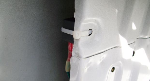

My 1993 Loyale Sedan did not come with a trunk light. Lack of a trunk light wasn't a big deal at the time I bought it new in 1994. I never really thought about it until recently when I was in the auto section of Walmart and came across a section with LED light add-on accessories. I got to thinking that an LED trunk light might be a nice thing to have. Even better was the idea of a couple of LED light strips that would light up the trunk better than any factory bulb. This mod story shows how I hooked up LED lights to my 1993 Subaru Loyale sedan trunk. No warranties, promises or guarantees of any kind are offered nor are they implied. The information provided below is for light hearted reading purposes only and not meant to imply anything at all. If you mess up your car, your boat, your house or your marriage it is on you and you alone. You should always seek out the services of a qualified professional to perform any maintenance or alteration of your vehicle in proper consultation with the appropriate manufacturer's representative. I picked up the Pilot Automotive 12" white flexible LED Strips at my local Walmart. They are available elswhere too. They come in other colors as well, like blue for those that prefer the inside of the trunk to resemble a bordello. If you look for this product on the Walmart web site, it doesn't show the bubble pack that it comes in at the store. This is important because not only do you get the flexible LED light strips, you also get it prewired with a battery source that includes ten 1.5v tablet batteries in a nice pack prewired to a switch so that while on the store shelf, consumers can hit the "try me" button and see the strips light up. The strips are flexible with LED lights embedded and can be cut to be smaller. Yes, you can cut them smaller and it won't ruin them. The important point is that you only cut at the designated spots as mentioned in the instructions - those little bits of paper you typically crumple up and throw out when you rip open a new toy. Since they are wired in parallel out of the box, cutting out some won't affect the others. The strips come with double sided sticky tape and they are flexible so they can be mounted just about anywhere you wish. And for 18 bucks, if it is a flop I haven't lost a whole lot. I still got a good switch and 10 of those little tablet batteries in a nice case. Here is a good picture showing what comes in the pack (note, there are two strips but this only shows one strip): I also took a pic of the bubble pack as it comes from the Walmart store. See the attached image. There are two options on how to power the 12v LED strips, either use the included battery pack as is, or wire it up to the car's 12v system. There are advantages and drawbacks to each approach. Initially I connected them up using the included battery pack (option one below) but then I changed it to wire it to the 12v Loyale electrical system (option two). Choosing which option to use is a matter of budget and experience level working with electrical systems in cars. If you are a cheap bastard like me, or a man of lesser means, then the batteries included option is probably the best way to go. But then again if your lazy rump roast side (again me) doesn't like changing little tablet batteries, you can opt to wire it to the car electrical system. Both options are explained below. Option One: Using the included battery pack If you decide to use everything as is out of the bubble pack, you basically only need to unpeel the sticky tape on the strips, mount the included switch so the light comes on when the trunk opens. Throw in a few dabs of hot glue here and there and voila. The advantage with this approach is the simplicity. There is no wiring to the Loyale needed so no chance of frying your Loyale's electrical system (important point if you are a novice at electrical circuitry), it won't run down your car battery and if you are stranded with a dead car battery, at least you have a lighting source by opening your trunk. Since these are LED lights and a trunk light is typically used only momentarily, it is a feasible solution to just use everything as it comes out of the package. The disadvantages are that the batteries will need replacing eventually and the included switch is a normally open type which means you press down to make contact to complete the circuit. This can complicate how to mount the switch. However if you are a novice and the thought of touching the car wiring bothers you, this is probably your safest, easiest and cheapest choice. Option Two: Using the car's 12v Electrical System By wiring these strips into the Loyale electrical system, the need to change those ten little tablet batteries periodically is avoided. Since they are LED lights, they use way less power than the typical single incandescent bulb typically found in trunk lights. The strips tend to light the trunk brighter too. The disadvantage of this option is that it is necessary to bring the 12v power back to the trunk which means running wires and connecting into the wiring system. You can potentially cause a short in your car's electrical system that could be very expensive if you are a complete novice at electrical systems and wiring. You will also need to buy a few more parts: wires, electrical tape, connectors, fuses (please for the love of god, don't connect without a fuse) and other bits which increases the final project cost. If you prefer a more stock than schlock look, understand car electrical systems and have the tools and patience for the job then this is the option for you. Mounting the Strips This is the easiest part of all. Just peel off the protective paper and stick them wherever you want light. I prefer a recessed illumination where the harsh glare of the bulbs doesn't blind my old fart eyballs. My choices were up under the fender wells or under the back lip of the trunk by the seat back. I chose the latter because the distance between each fender well meant possibly splicing wires and I didn't want any electrical potentially spark prone devices right over the top of the fuel filler neck that intrudes into the passenger side of the trunk. Yeah, I know that is a sealed LED and the chances of explosion are very small. Still, I don't want to be THAT guy that wins the Darwin award along with the topic of late night comedian jokes. Mounting The Switch Even though the Loyale Sedan did not come with a trunk light, it did come with a built-in bracket to mount a switch (at least mine did). Under the right hinge (passenger side: see attached images) is a bracket that can hold a switch so that when the trunk is closed, the switch is pressed. When the trunk is open, the switch is released. Using this bracket means that the included switch cannot be used. What is needed is a switch that when pressed turns off the lights and that is the exact opposite of the switch that came with the LED strips. In electrical speak, the included switch is a normally open momentary contact switch whereas what is needed to use this bracket is a normally closed momentary contact switch. It is similar to the switch used in a refrigerator to turn on the light when the door is opened. I broke my cheap bastard rule and decided to buy a normally closed momentary contact switch at Radio Shack so I could take advantage of this bracket. It is a mini SPST (single pole single throw) momentary pushbutton switch catalog number 275-1548 and set me back about four bucks for a four pack. I cut a square plastic adapter plate with a hole since these tiny switches won't fit the Loyale bracket exactly. The attached images show the switch and the final mounting. Do you have to buy a new switch? No you don't. You could mount the switch that came with the LED strips. You would need to mount it in such a way that when the trunk opened, it pressed the switch. When the trunk reaches the top of its travel and is open all the way, the hinges have stops. The included switch could be mounted there so that when the trunk is open all the way, the switch is pressed and the light comes on. This means however that the light doesn't come on until the trunk is open all the way. I prefer the light to come on the second the trunk is popped so I chose to use the existing bracket. Powering the LED Strips If you use the batteries included option, all you need to decide is if you will mount the little battery pack using hot glue, double sided tape, zip tie or bubble gum. You are done. If you are using the hardwired option, your fun is just beginning. If you want to do it right, you will need to run wires under the trim pieces along either door jamb of the car. Since the chassis is ground, you will only need a single 12v wire from a constant on +12v source. This is easier if the rear seats are out. Luckily our friends at Autozone have provided a handy diagram of how to remove the back seats in the Loyale as shown below. While the seats are out, you may find enough change to offset the cost of the LED strips or even a not too old french fry that escaped the bag from the last trip to McDonalds. I don't advise you actually eat those old french fries you find. Though your doggy might be happy to have them.

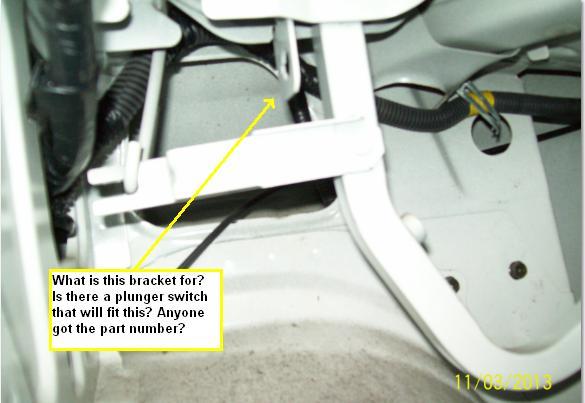

Loyale sedan - what is this for?
MR_Loyale replied to MR_Loyale's topic in Old Gen.: 80's GL/DL/XT/Loyales...
Cool thanks. -
In my 93 Loyal Sedan, under the passenger side trunk hinge, there is a perfectly stamped keyed bracket that looks to me like a mounting point for either a dash indicator switch or a trunk light plunger switch. I suspect this was an option on a GL version of the sedan or something. Does anyone know what this is for? I would like to add a trunk light so that when I open my trunk, a light comes on. If there is a pre-fit part, say for a GL version or something that will just snap in, that would be great.
