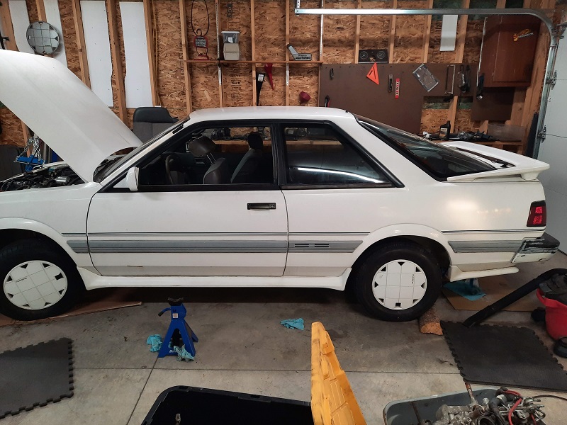

  22. Oh yeah, got the tires on, alignment, and cleaned up my hub caps. I am a huge sucker for 80's styling and this is definitely cherry in my book. Love it.

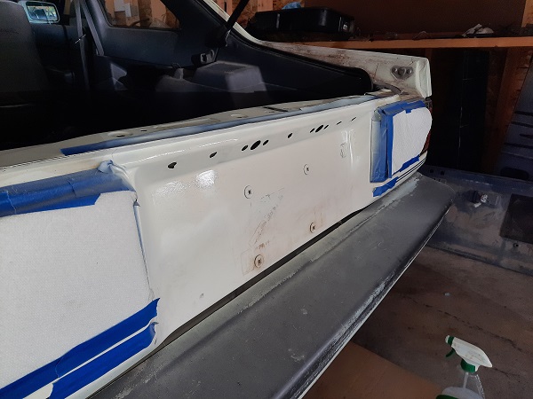

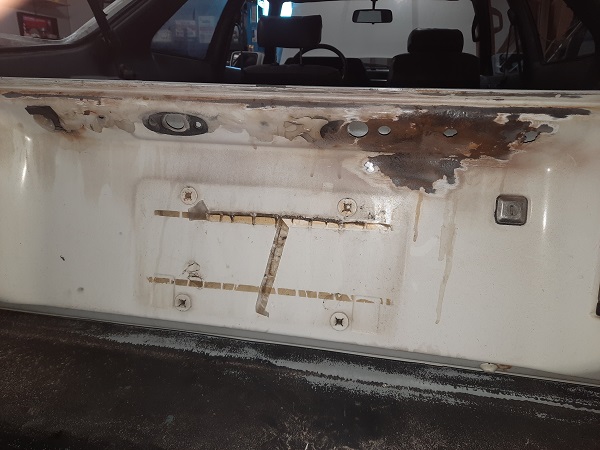

  23. It's not perfect, but it looks better and hopefully wont rust anymore. Oriley's couldnt mix a can of my exact paint but its pretty damn close. No clear coat since this was single stage from the factory. There's another really bad spot behind the passenger side rear trim - but I haven't taken any photos of that yet. Other than all that - I fixed various pieces and lights in the interior, I replaced every single brake light bulb/running light. I fixed the passenger door window switch. I cleaned and wiped down all of the interior trip - and reinstalled all of the trim that was removed from the previous owner. My next few to do items are: Install more sound deadening in the rear of the car Repair the rear carpet, and clean it as best as posible Replace the particle board covers for the rear storage WELD THE TORSION BAR (I have to learn this one, which will be difficult but I want to do it.) Install the new interior once the upholstery guy is finished. -------------------------------- Weld battery tray, fix small rust holes. and that's basically most of what I can think of off the top of my head. But I always find little things to keep my weekends occupied for sure.
  24. I also have been working on some of the body work - I'm basically a professional painter now:
