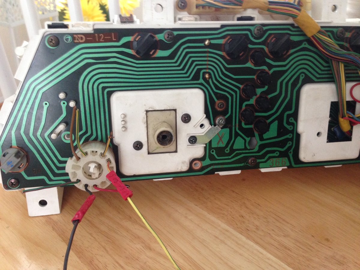

I pulled codes today and found nothing that would set it into limp mode, but I did read that this neutral could very much be my problem, could someone please help me find this part or a wiring diagram as my 88' gl doesnt have this (99' Impreza 2.2 phase ii engine) -

I thought the same thing but there's nothing behind it, I thought it was that too but it is literally an empty hole, no threads or anything, it looks like if there was a different model gauge that whole would be used, but not used on this model, and concerning the diagnostics, I probably messed up the wiring when putting it in the GL -

I'm pretty sure this was the fix, if I take the screw out and measure resistance while spinning the speedo there is no change... But with the screw in there is a change in resistance, still no voltage but something is different, does this mean it is working?? -

I'll see if i can find a screw to fit and retry it, UPDATE, that screw was connected to the red yellow, but it still doesnt generate any measurable current with a multi meter, will it work regardless?? -

Ok so the cluster isn't the problem, but which wires do I use for the vss signal then because I hooked it to a multi meter with many different wire combos, and everybody has said to use the yellow/red and black, but the multimeter didnt change in resistance nor did it change in voltage, and it isn't boost cut because it did it before when i drove it n/a -
Ok so some back story, I have searched the webs and many forums for this problem, I have a 1988 subaru gl with a ej22 phase 2 engine in it from a 99 impreza. I then turbo'd it and it runs fantastic at 8 pounds of boost, UNTIL, limp mode happens. Now I have gotten a dash cluster which I think is compatible but it's from an 87 DL auto, which i thought had the reed switch thing I needed for the impreza's ecu to be happy, apparently not. So my question is what am I doing wrong, is the cluster not compatible or is it simply im not wiring it right, because a lot of people say to use the cruise control, but i have no longer have the cruise control and/or wiring thinking I wasn't going to use an oem style speedo. Please help, even though it's probably been answered many times
