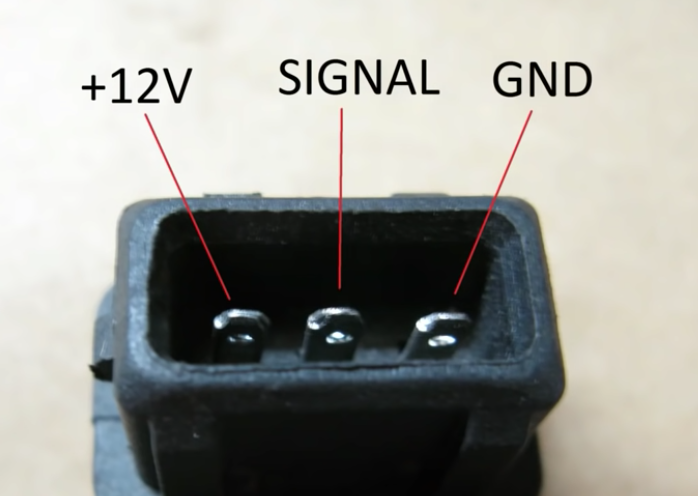

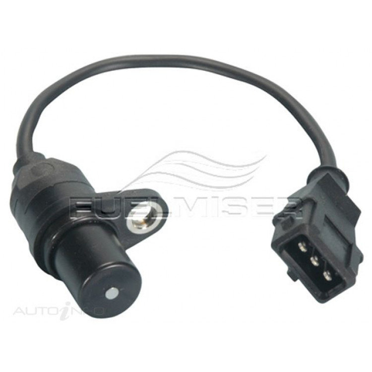

I used a DC volt setting on my multimeter as that is what I was Instructed to do, the reading hasn't changed at all since the first test I unplugged it and then plugged it back in again and my no-start condition turned into a starting condition last night, and it has cranked fine ever since - does that mean that it is most likely a dodgy wire near the connection? It is worth mentioning that it is a 3 pin crank angle sensor, like this one here. I'm not entirely sure about them but usually, don't they require voltage?

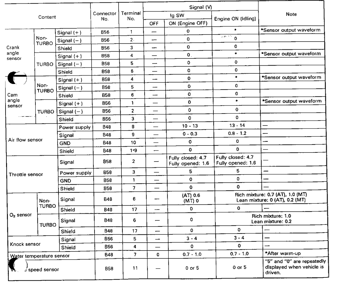

Hey team I am just wondering how I would go about testing my crank angle sensor and my wiring - I've been having stalling issues and starting issues since i checked the sensor last night and reconnected it, with a check engine code for crank angle sensor I have a multimeter, checked the wiring connector and it had continuity, but with the key in the on position I could not find any voltage running through - it had 0.05v running through all the connectors which obviously is nothing - but in the workshop manual, it says voltage should be zero as well. This is different from what I've learnt that usually there should be voltage running through it when the key is in the 'on' position. I have attached the page of the manual where that is found Thanks in advance!
