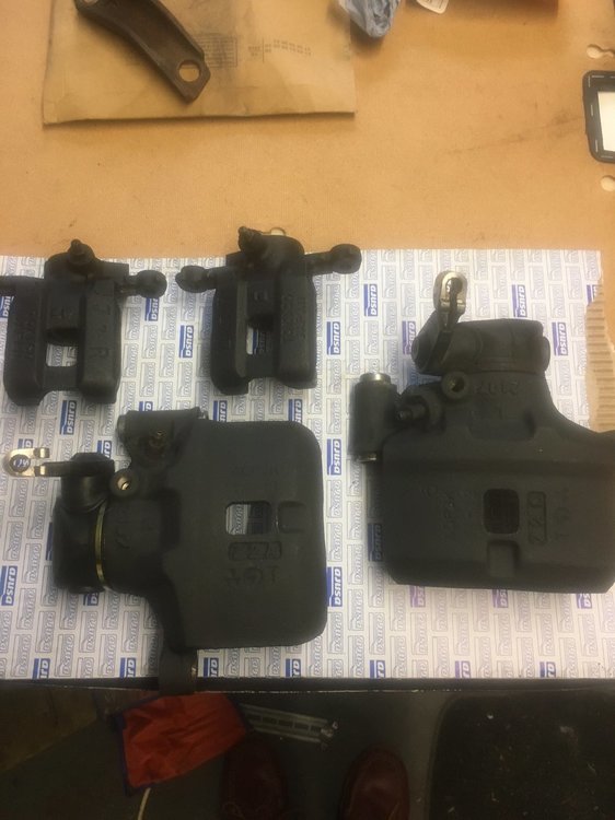

Bits and pieces done recently. Went shopping at Rock Auto and replaced the water pump and front brake seals. Just waiting for my UK supplier to deliver my rear brake seal kits and pistons then I should be able to move the car to have some welding done.

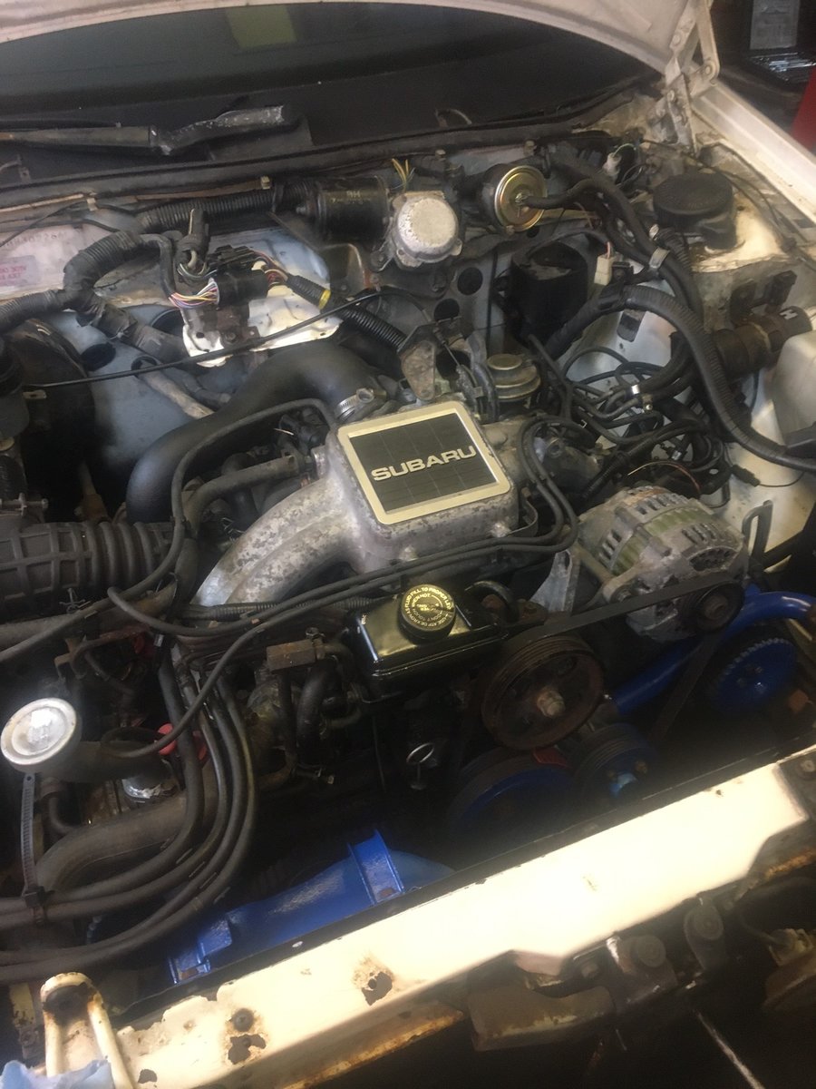

Cooling system is hooked up just weeping from the waterpump. The steam was from the radiator heating up as it was wet. No this is a Turbo, just missing the intake ducting. Need to get hold of one.

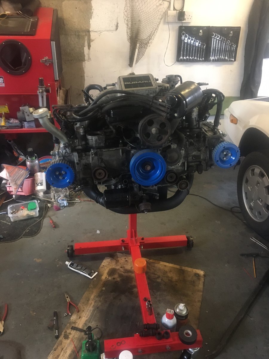

Still waiting for the waterpump but I got fed up having the engine hanging around so back in she went with the weeping original pump.

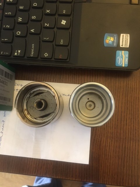

Thanks John I'll check. On the downside some parts have arrived, unfortunately the wrong parts. The waterpump is too tall by around 5 or 6 mm and will mangle the aux belt if fitted. The front brake pistons don't have receivers for the handbrake. 10 days waiting and crap arrives, great.

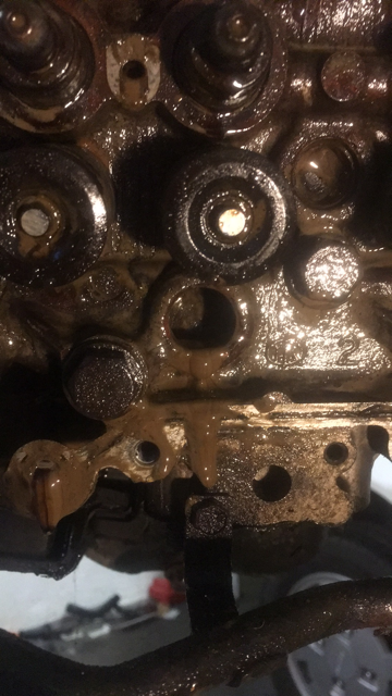

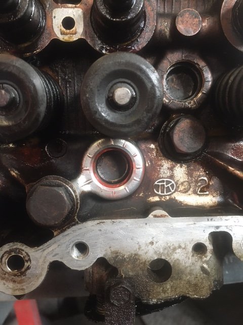

So the engine is out and I've found the culprit. One of the freeze plugs had popped out in the head. Just waiting for my water pump to arrive and I can do a pressure test on the cooling system to see if I need to delve deeper. Dropped the sump off and apart from a load of milky oil laying in the bottom it looks like the crank is in good condition. Also managed to free off the completely stuck distributor, given a clean up and back in. Good weekend so far.
