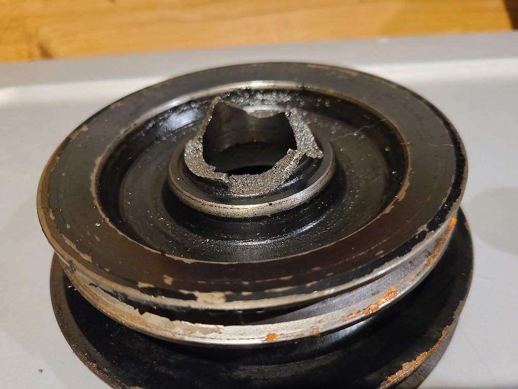

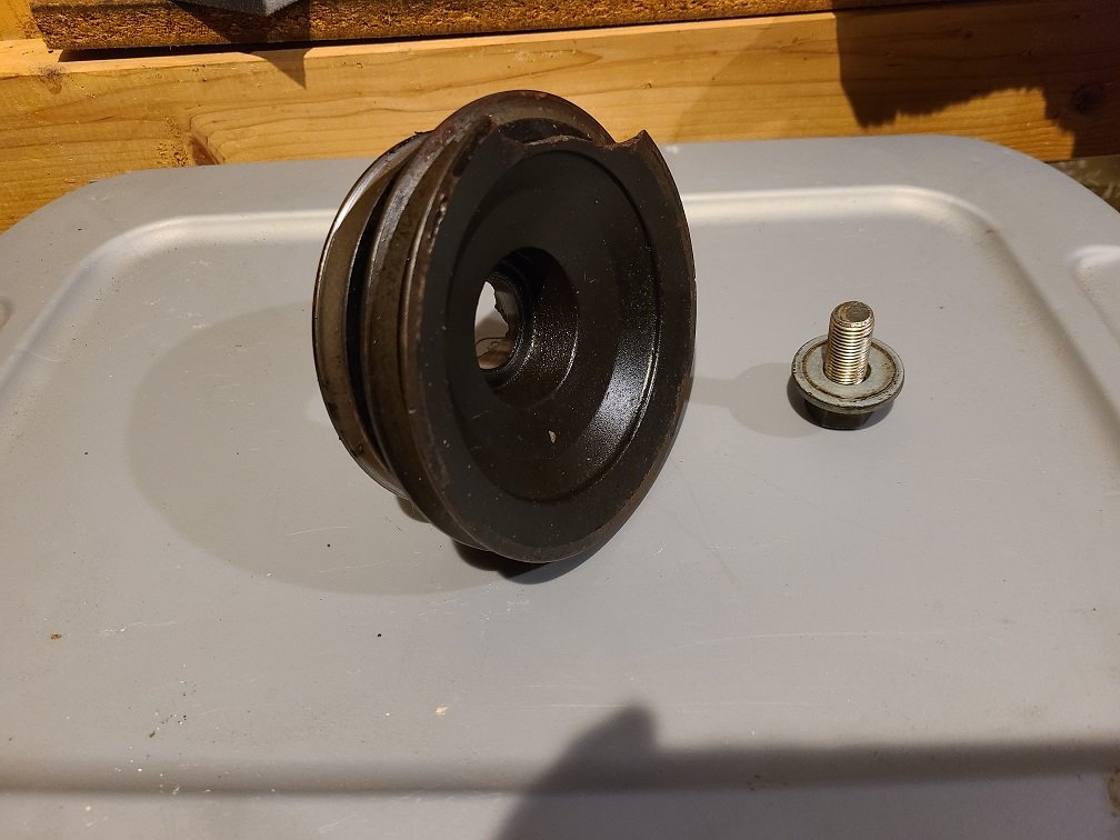

I went ahead and attached an image of my pulley, as you can see my crankshaft bolt appears to have survived somehow, so I think I'm just in need of a replacement pulley. EA81 engine, I think this is what's known as the "3-pulley design" but I'm not sure
