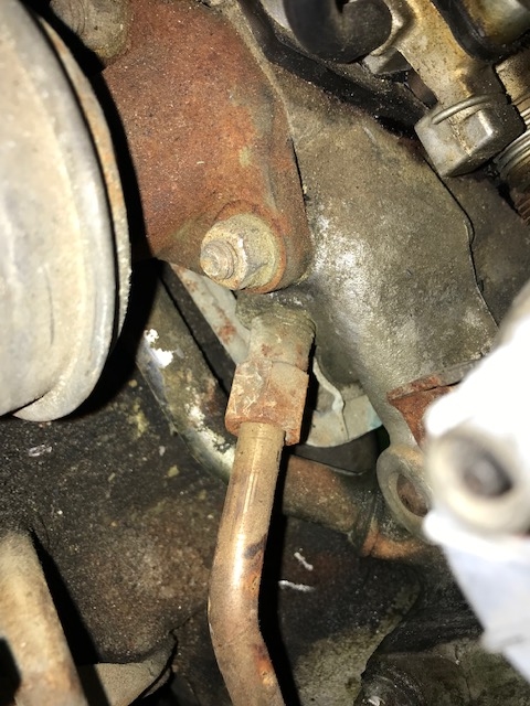

Thank you everyone for the help. Life has been a bit crazy recently, so my apologies for the late response. I had to ask this because I just did not want to risk breaking something that was not meant to come out. -

Hey Everyone, So I finally sourced an EA82 intake manifold to do a Weber swap because my Brat came with the 1 BBL Carter-Weber that needs to have either the Hitachi manifold or the EA82 manifold to allow the swap to be done. I am currently in the process of removing the EA81 intake manifold but I came across an issue. There is a pipe of some kind located near the EGR that is attached by one end to the manifold, and from what I can see it seems like there is no way that the manifold can be removed without the pipe being removed. However, I read in a different thread that this pipe I am seeing may possibly be pressed in and therefore should be left alone. I've tried removing it but it will not budge. Would anybody here have any suggestions and/or know what it is that I need to do to completely take off an EA82 manifold? Thank you -
