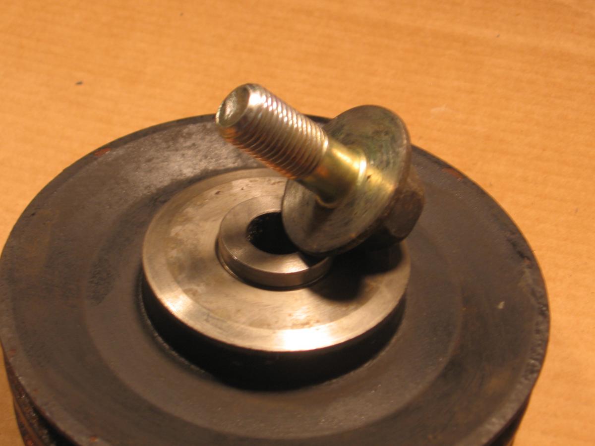

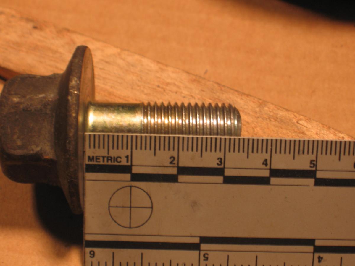

M14 thread with 1,75 pitch. Flange head bolt, flange diameter is 38mm. Under the flange, you have 12mm of unthreaded shank and 20mm of thread. Torque to 66--79 ft/lbs. If you use 'blue' threadlocker, torque to 66 ft/lbs. -

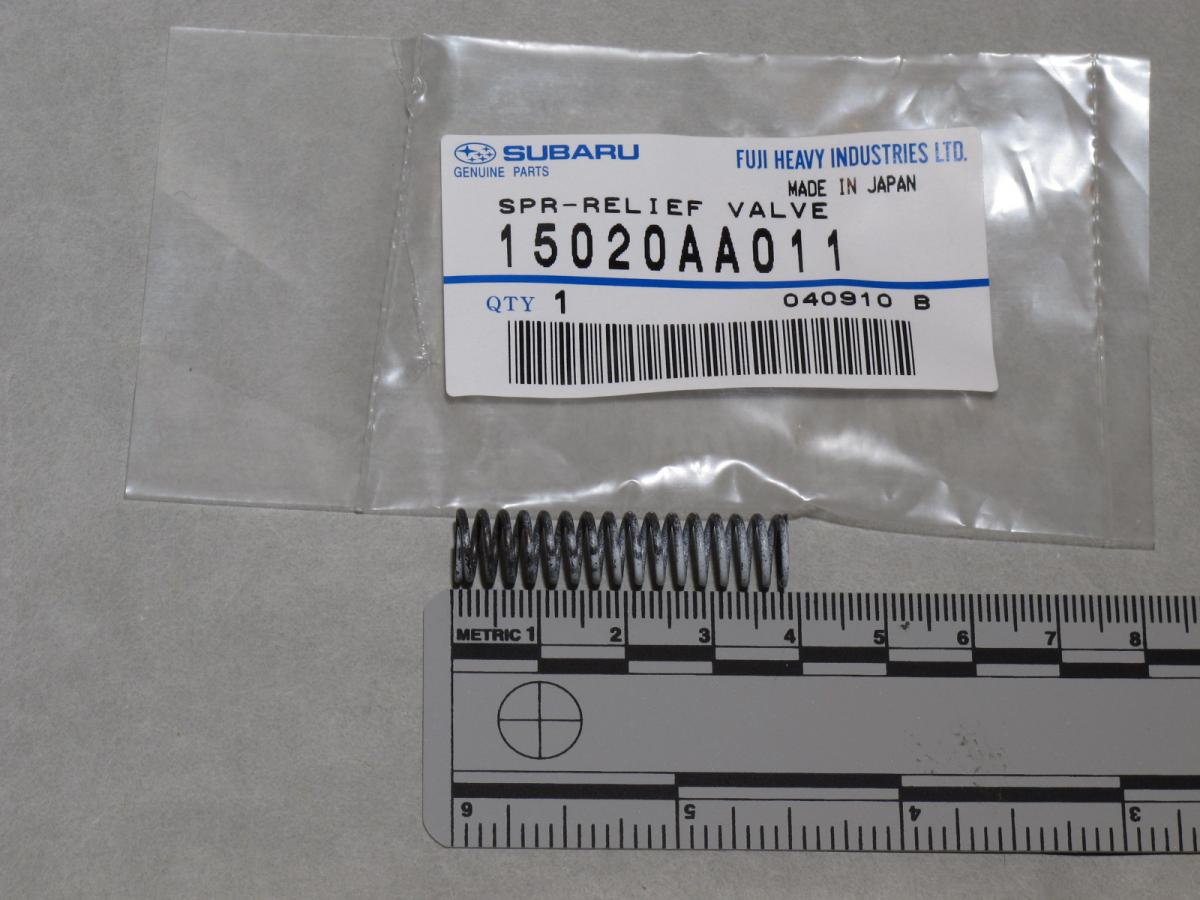

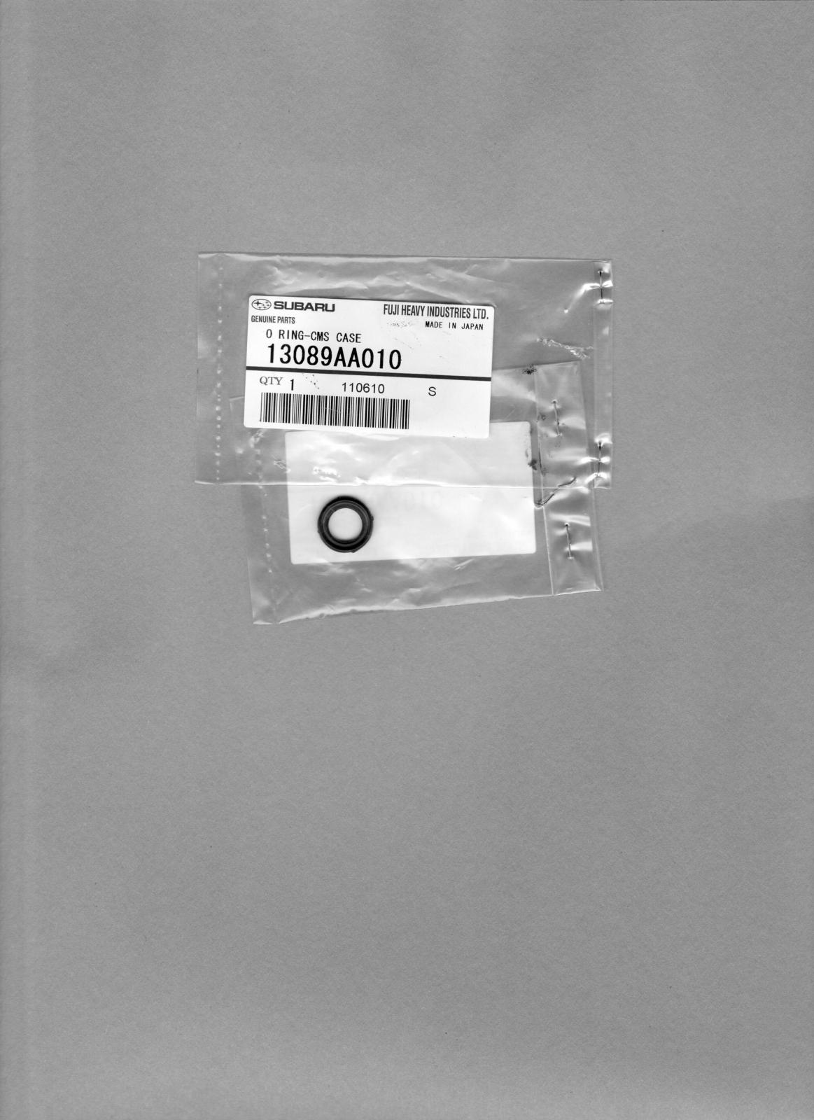

Here are a few details to think about. As mentioned previously, the special o-ring at the cam case is to be the Subaru o-ring. During my adventures at PnP and removing cam towers, I am not surprised to find brittle, deformed and crumbling o-rings. Bad idea to use regular o-rings. 'Oil relief tubes' at the cam tower. There are relief valves. The springs get tired. Inspect the springs. Stretch the old ones while you order new 'relief springs' from Subaru. Never use silicone on the cam towers. The infamous cam case o-ring. Don't leave home without them. -

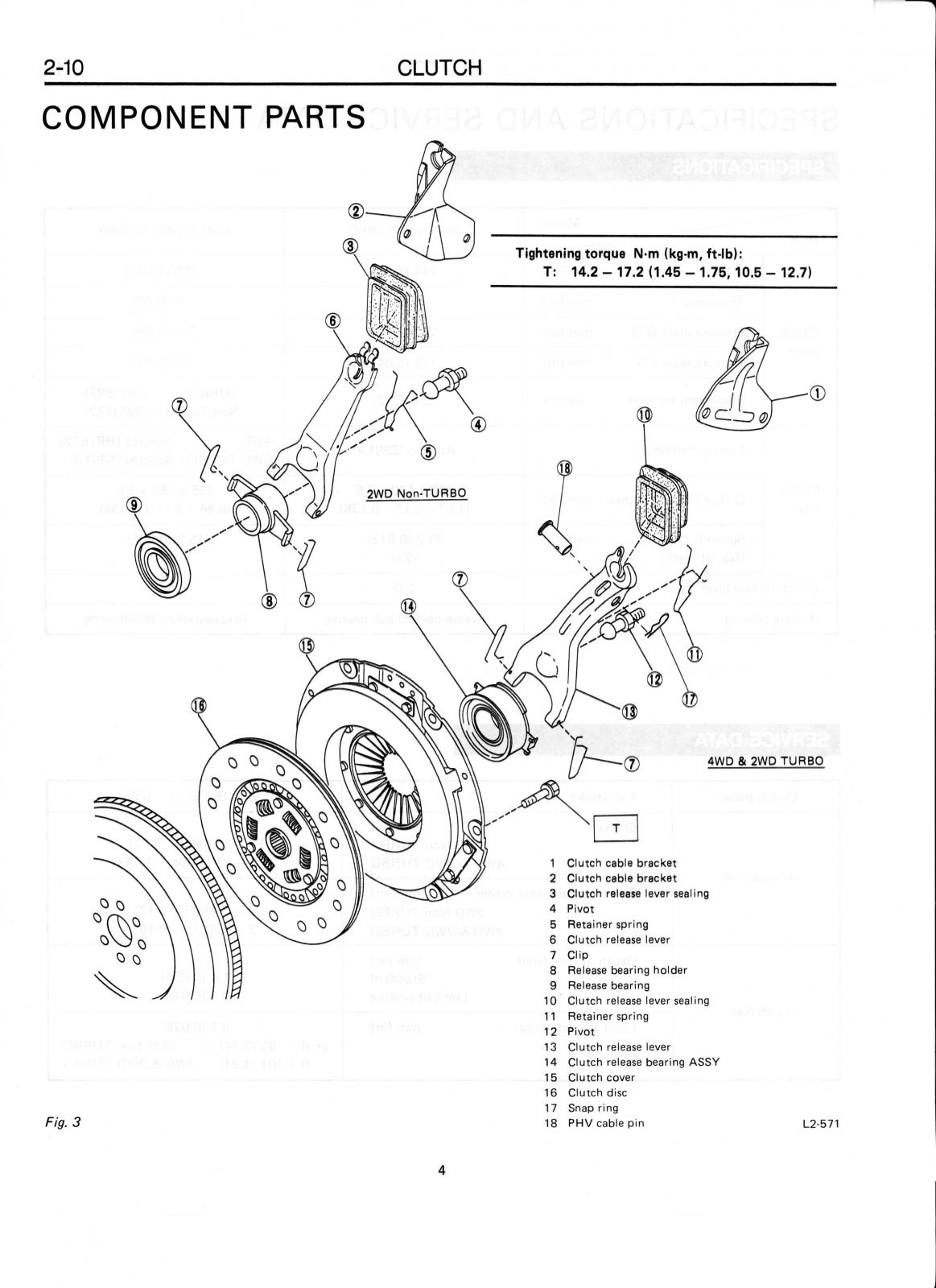

? Exedy #15008 clutch kit? You will receive a clutch alignment tool. It has 24 splines. Some manuals list the input shaft with 25 and that is incorrect. Not sure where you will be crawling around. If you are on soft terrain/gravel. put down a piece of plywood. The wheels of jacks will roll OK on plywood. If you drop a small part, it will be easier to find. Warmer too.
