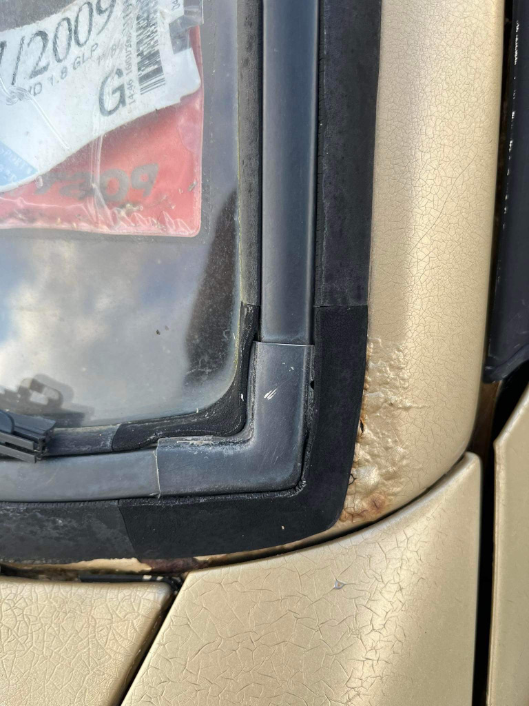

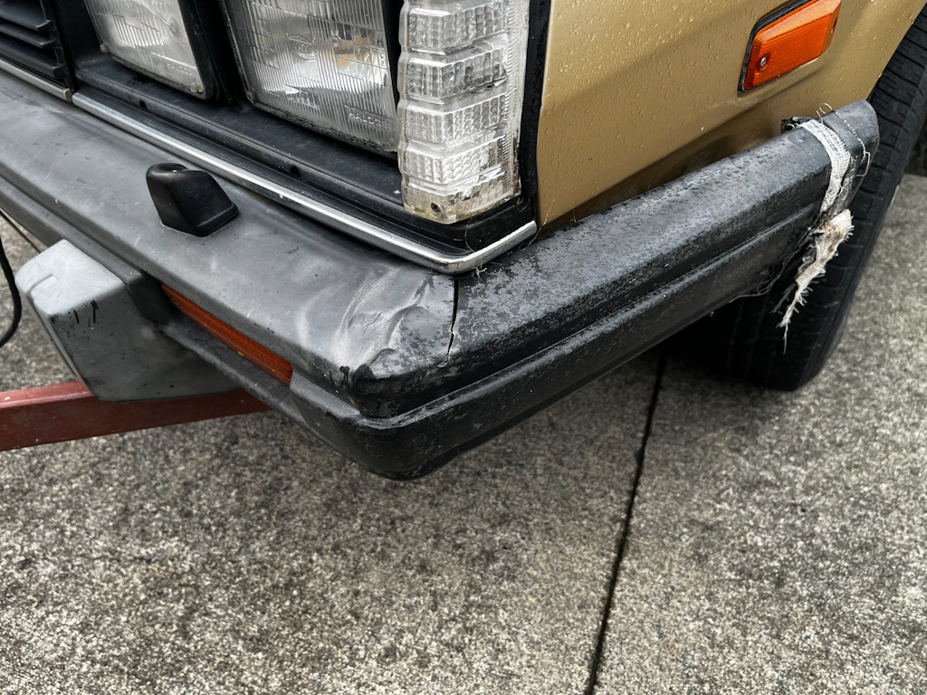

  1. Howdy Bennie,Your ozzie sun is likely crueler on the rubber than here,my side windows were decent. My donor was likely closer to what yours is like ,as tried to remove tailgate seal on that one also,but was too far gone and ended up ripping it,as too brittle. Possibly worth leaving insitu,and try this stuff,I used it to reseal where I had sliced the seal in a couple of spots,can’t even tell. It does say you can sand it to shape when set,so may be worth a go,cheers Westy

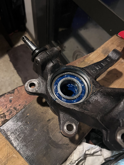

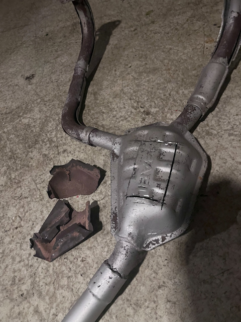

  3. Who stole my wheels! Nice rough rumble from front end during cornering at cruise speed,so jacked up front end and spun each,right front had vibe and gravel when spun so wheel bearings replaced that side. The guy that wrote up “How to keep your Subaru alive” document is an absolute legend.. Discs machined,new brake pads all round,new KYB rear struts.Had the fronts tested and results were fine ,so back on,just as well as no one makes those adjustable height ones these days. Adding to the wicked backfire from cracked exhaust y pipe,a harmonic rattle had started up in the collector muffler,so a little surgery found the baffle plates floating around and semi restricting the flow I’d say.welded up both and alls well,even a hint of rasp to the exhaust note now. Compression test all even around 170,which is unreal for a near 40 year old engine,bit of blowby from the oil filler pipe,but doesn’t blow smoke on accel or idle,so all you could hope for really. Lots of idling while faffing around with carb,but plugs look ok ,if a tad lean maybe..

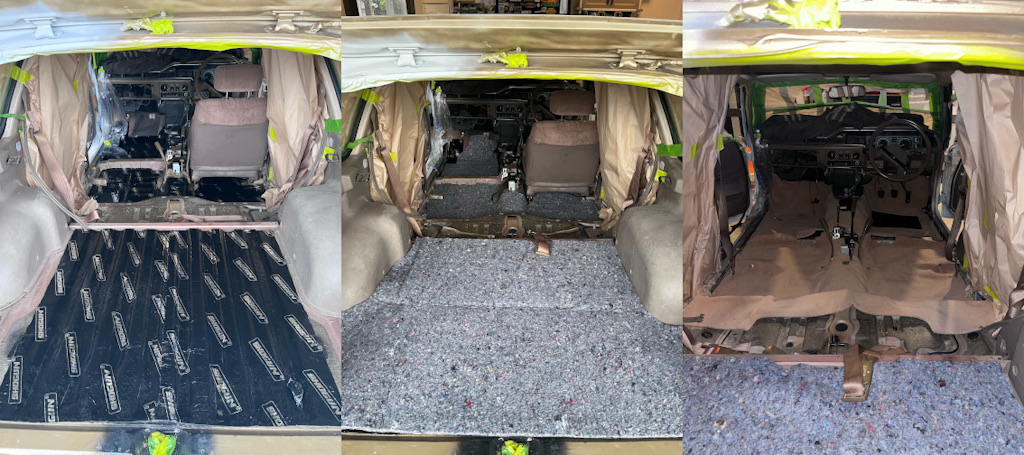

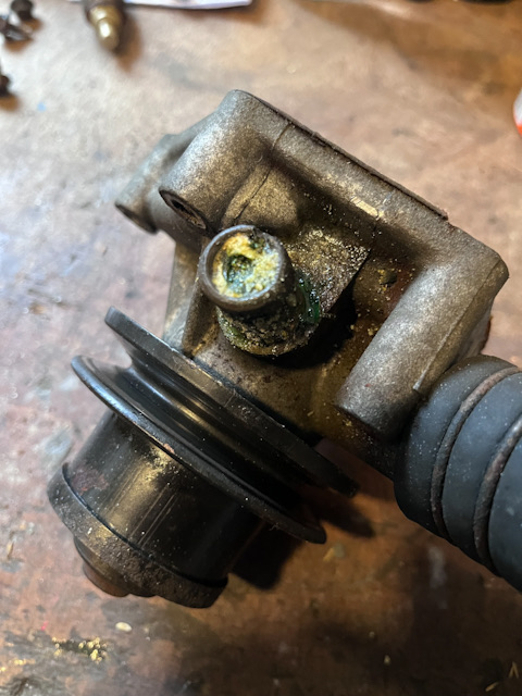

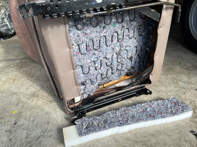

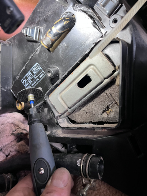

  4. Fun Bit Continues.. Glazing back in,Interior soundproofing and new carpet. Drivers seat cushion had lost most of its cushion,so you looked like a low rider gangsta styles.. Some firm foam and underlay tucked under spring base improved the ride height. Once again the donor to the rescue,my oil pressure gauge was low off the scale,likely in the past had earthed out and ruined the spring inside the gauge. New oil pump seals and a new sender unit didn’t change anything ,so instrument cluster out,exchange gauge,that’s fun! succes tho. Same deal on the fresh/circ vacuum actuator,behind glove box,original was a vacuum leak with its diaphragm gone. No heating to cabin,suspected the heater core blocked after sitting idle for 15 years. Too lazy to pull entire dash so attacked the side of heater housing with a dremel,extracted said core,and had decent flow through it,so put it back in,not the issue?? The heater hot/cold cable driven valve inside engine bay was working,so was stumped for a bit until as part of the refresh changed the waterpump,think I found the answer! Rock hard calcified coolant plug…

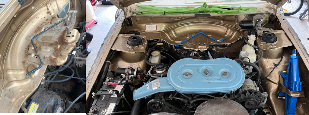

  5. The Fun Bit.. Surface rust removal and a quick spray had the engine bay tidied up. After hours reading posts on here with trials and tribulation getting the hitachi carb to play nicely,it became apparent that much of that angst is due to all the extra vacuum and emissions stuff that you guys in the americas got landed with. Down here we lucked out,as back in the day we were delivered this generation in its most basic form,at least my version is. Manual choke,no asv,no carbon canister,catalytic stuff,no emissions control,etc. This definitely makes things easier when you only have hoses to the air filter from the rocker covers and pcv,add vacuum from dist advance and the fresh/circ vacuum line,that’s about it ,as delivered new with the dcx328 hitachi carb. So I fully understand the frustration and effort put in on this forum dealing with emissions delete and Weber upgrades. Saying that,having rebuilt the two carbs i swap around into the wagon multiple times now to get it running right,they are 40 years old,and their design was flawed to deliver the best driving experience. Actually really enjoyed learning the quirks of the hitachi carb,but no matter what I do,each one has its own personality,bipolar and schizophrenic usually;)

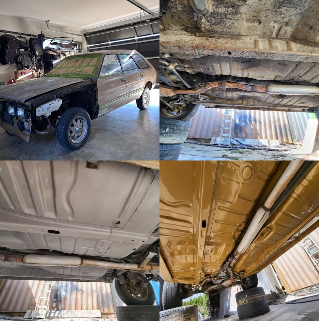

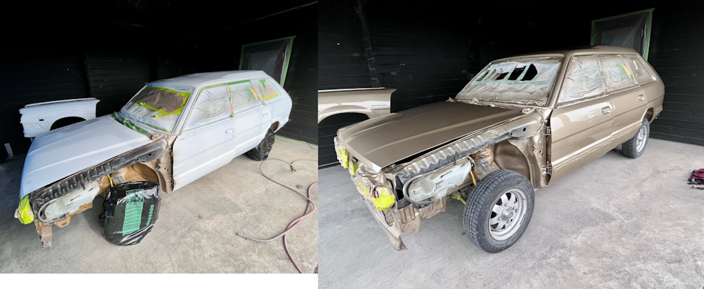

  6. GoldDust. Sporting its original paintwork,the car up close resembles a crazed Chinese vase,so started stripping it back for a new coat of subaru “Gold Dust”. 40 years of dings and creases on that thin metalwork dealt to,but I missed a lot on first pass. Sand Blasted the surprisingly intact hole free intact unibody underside. Wasn’t keen on slathering the underside with rubberised gunk,so used an epoxy primer and a tinted epoxy topcoat,should be hardwearing,turned out looking pretty sharp. My mate “Rocky” who is 4’2”,has setup his utility wagon as a mobile spray platform,so at the cost of $500 cash and a box of corona, got him to come spray the wagon in my open carport. Picked the worst day possible with driving rain and howling winds,so much of the paint ended up on the nearby trampoline;) Considering the conditions and environment,a few dry areas and challenging to get even coverage in 40kt winds,but we had a fun day,and turned out not too shabby in the end:)

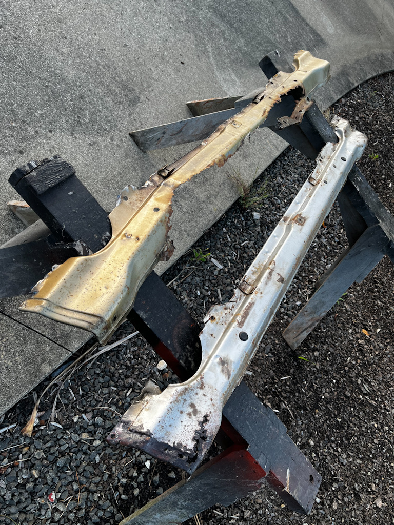

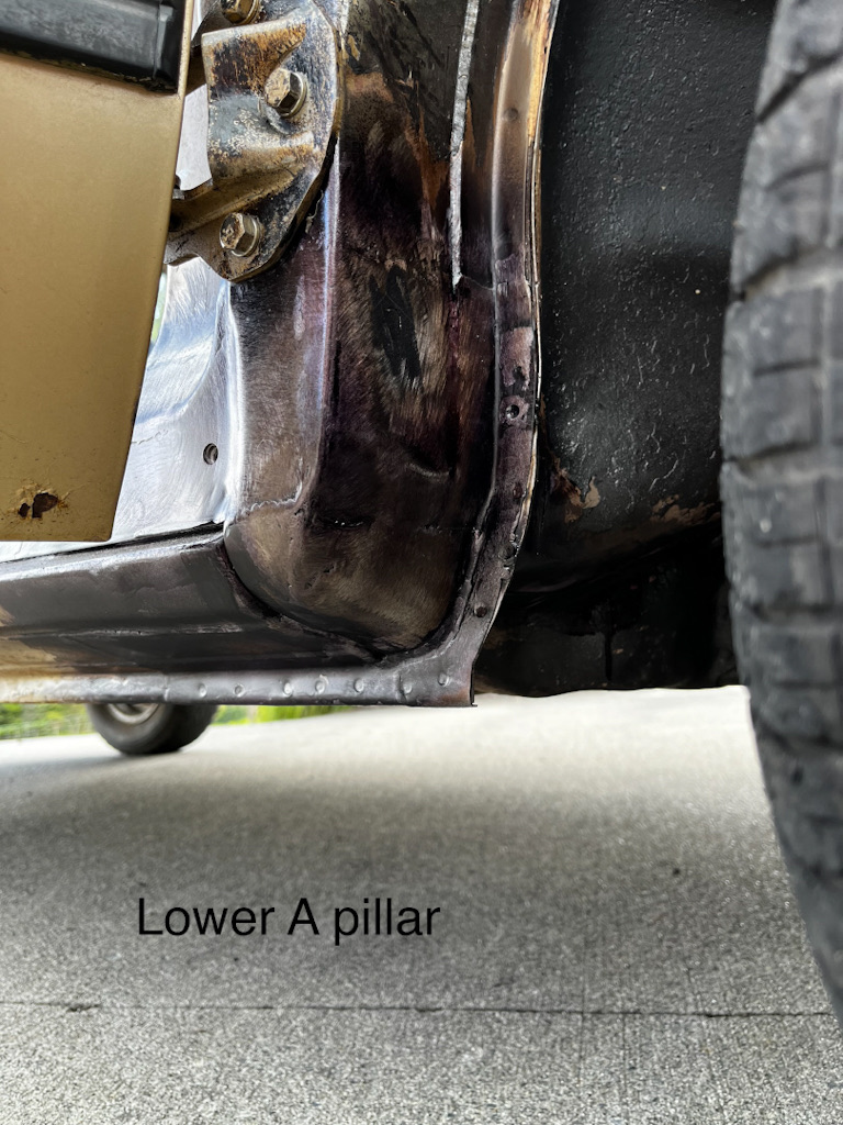

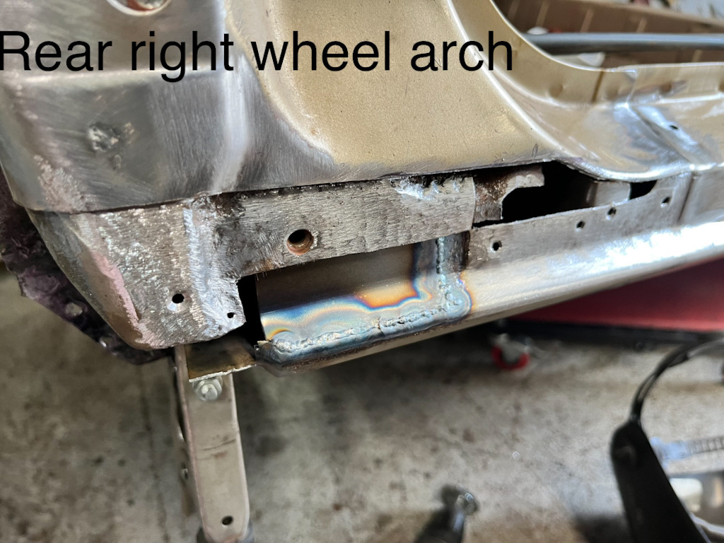

  7. This kind of repair exceeded my limited capabilities for sure! Hidden behind a post office, with no signage,years prior had discovered two young guys that had setup a metal work shop,you wouldn’t know they were there and they don’t advertise.Often the way huh. Immediately hitched up the the death triangle and towed it down.They didn’t blink,well maybe a bit,but ripped into it. So far this was a very cheap exercise,but happy to pay for their ninja skills.

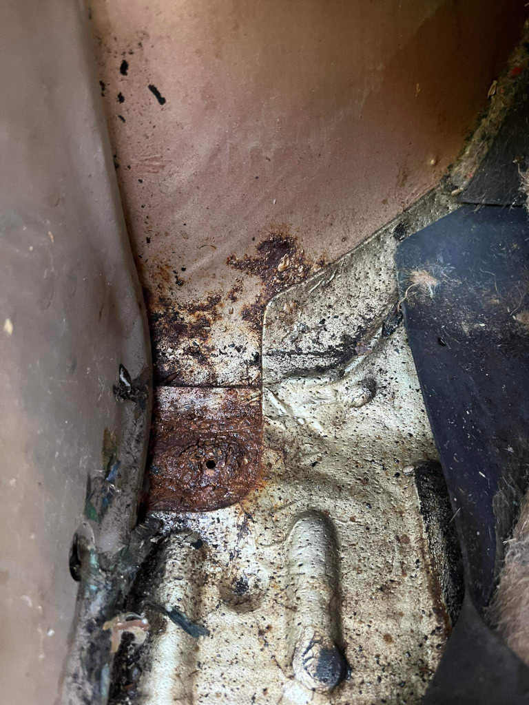

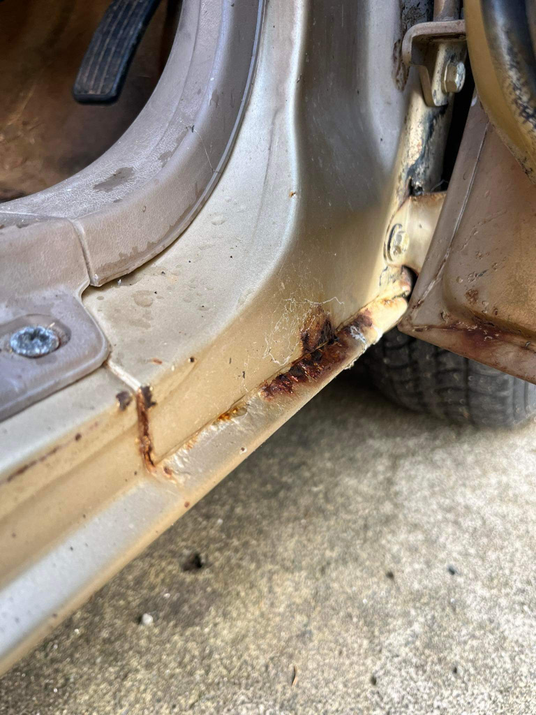

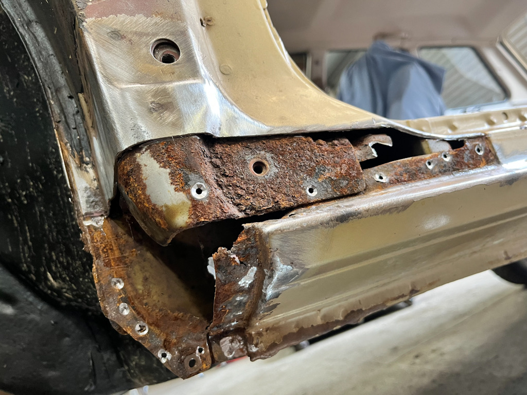

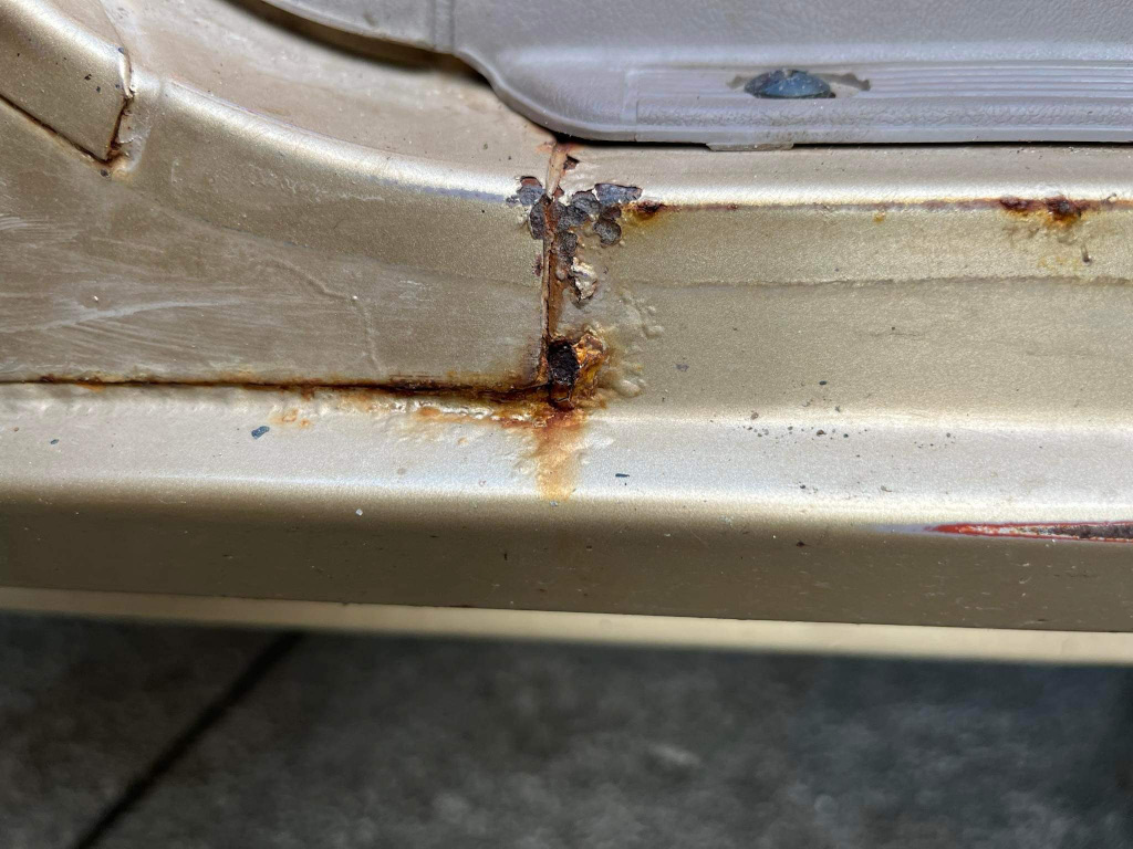

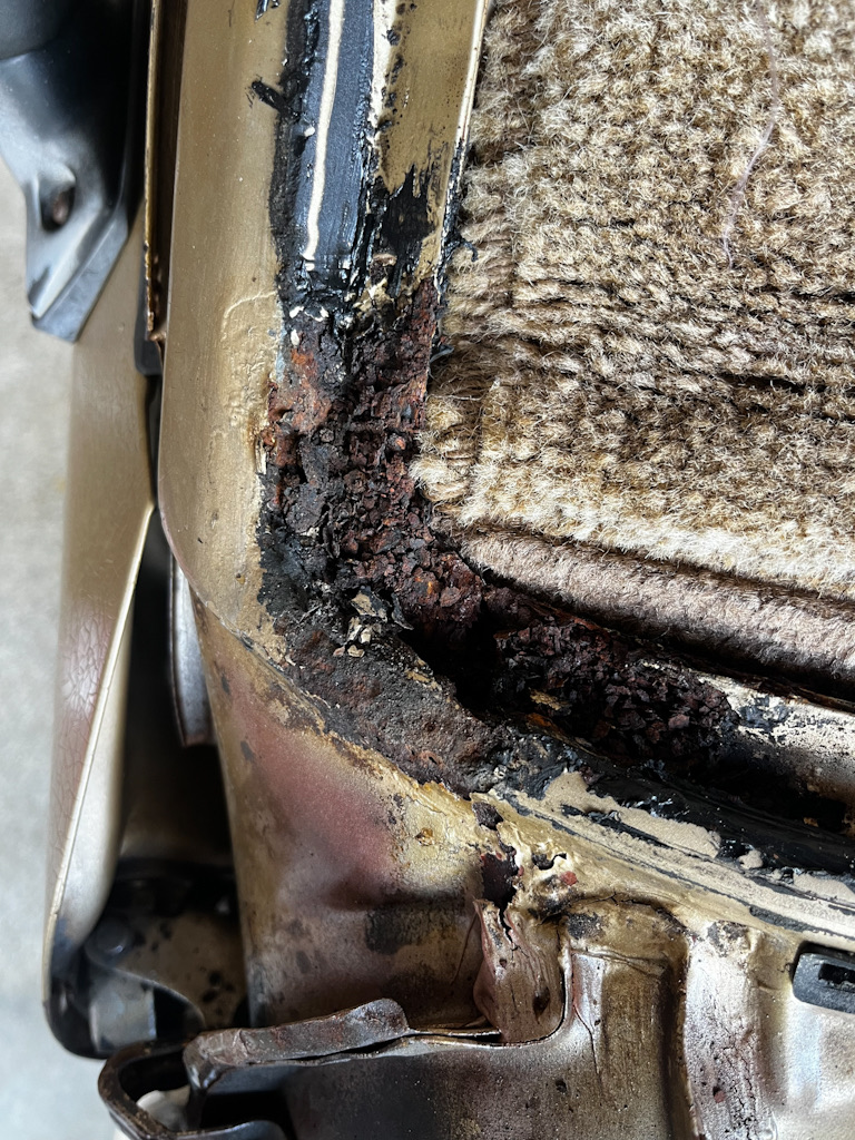

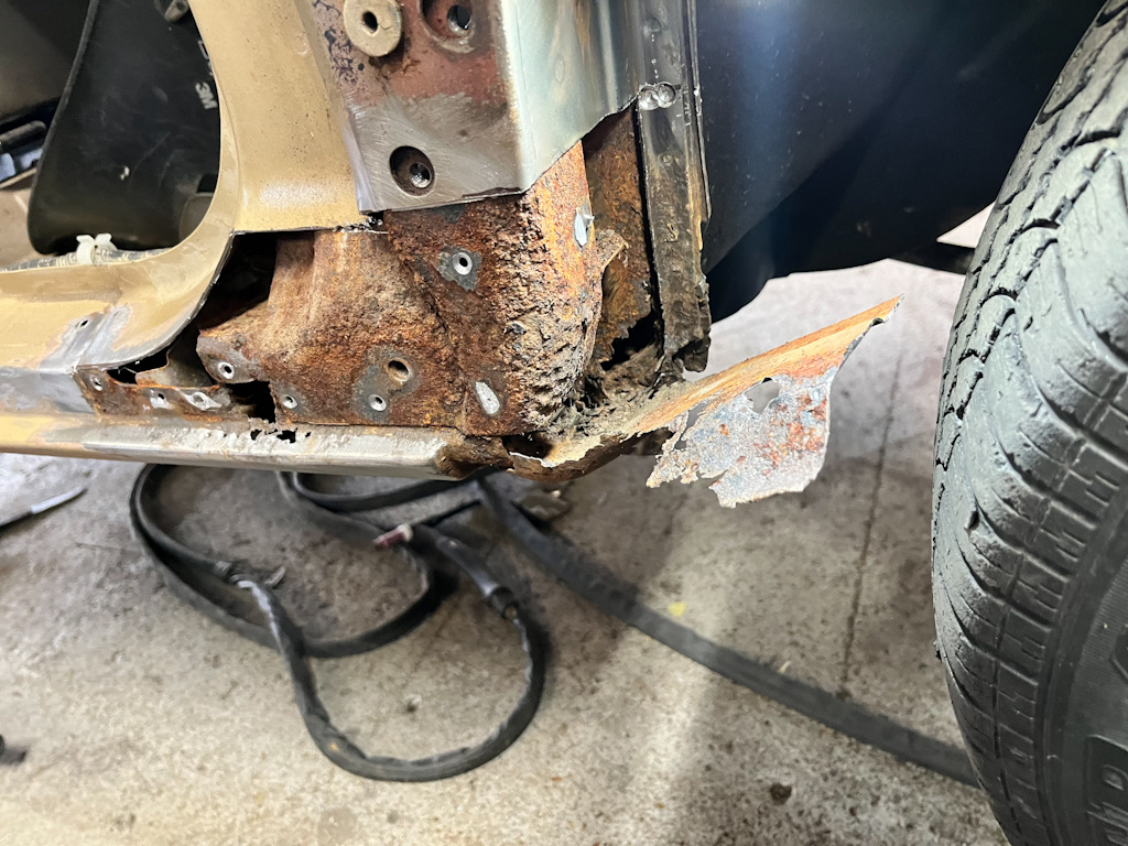

  8. Excavation.. Delayed the enivitable,now it was time to remove the glazing and begin archeological dig. Anyone viewing this will already know where they dissolve. Every picture I’ve seen of this gen and age ,all seem to go in the same areas. Pillars,lower windscreen corners,lower tailgate frame,wheel arches,A pillar uprights,door sills,etc Did have a moment of despair uncovering this lot…these being just a sample of delight.

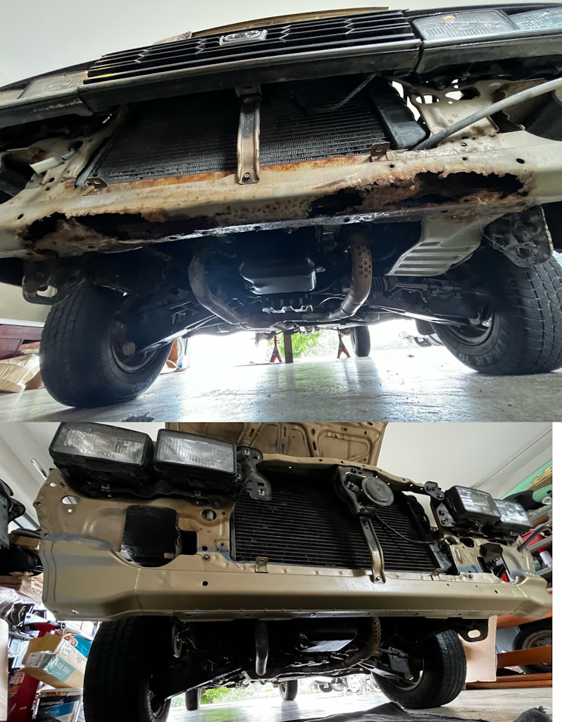

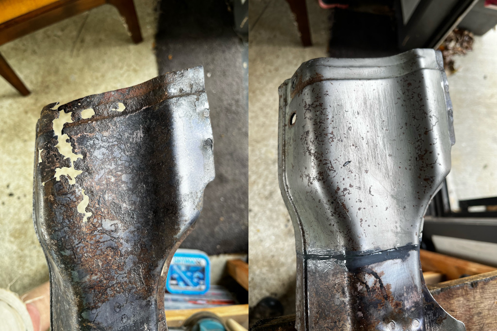

  9. Front Valance. First big use of the donor was to rebuild what was left of the original lower skirt panel. blood spilt cutting both away in one piece. Cut and paste (jb weld) and eventually tack welded back into place,already paid back the few hundred spent on the donor:)

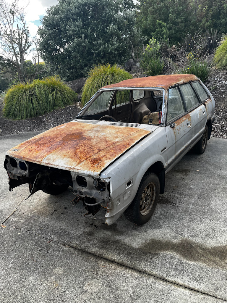

  10. Rats & Regrets. My wife tolerated this beautiful specimen raining rust on the driveway,and warding off the minions from playing in it ,for fear of tetanus or worse for a month. I raided it of its very tidy interior and most ancillaries,and between my shortass wife and myself lifted the engine out with a chain over a plank of wood.Gotta love a 90kg engine and easy out design:) i called in the metal truck,he was too quick,as didn’t get a chance to pull the tight feeling gearbox ,which I regret.I’ve learnt on here,that these are difficult to rebuild easily. Mine graunched up shifting into 3rd,solution as posted on here,was Redline MT90,graunch totally gone,mint. Made the rookie mistake of turning fan motor on full bore,and received a face full of ebola coated confetti…yummy

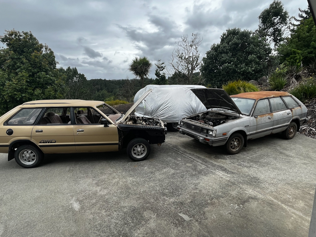

  11. I soon became aware that in order to restore a complete vehicle,I’d need a source of parts. Then the realisation I may have picked the wrong car, discovering that they stopped making many of the things that wear out circa 1999,,oh joy! Add to that being down here in the antipods,very limited resource as most had dissolved decades ago. The only saving grace was the bookface old school Subaru group,an awesome group of like minded souls dead set on keeping these early cars alive down here. In a moment of kismet and karma a slightly used gen2 popped up on our version of your junglebay. Perfect solution,then there were two:) The seller was again a sole owner since new,a mowing contractor who promptly removed the back seat squab in 1983 and tucked it away,,mine was missing one,nirvana.. Isn’t she a gem..
  12. Backfiring Even before tackling the carb or tune,a rev up from idle had this baby backfiring like a shotgun. Slightly disturbing but kinda cool. Leaned out the carb a tad which improved it a bit,then being a total newb to the ea81,trawled this forum for info. Someone had posted a similar experience and GD nailed it with his response. Unburnt fuel igniting in the Y pipes especially if said pipes had cracks being very common. That heat shield is a moisture trap as well,so bit of cutting disc action and sure enough.

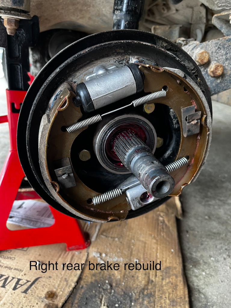

  13. Braking felt about 30%. Nice steady pool under right rear. On inspection one entire brake pad had detached from its metal plate ,due no doubt to the volume of brake fluid flowing out of the seized extended piston,nice.

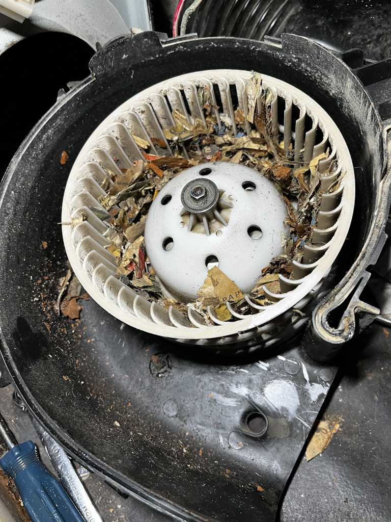

  14. Initial Inspection walk around As you all know,,you only see the top of the icebergs… “Here Mousey Mousey”
